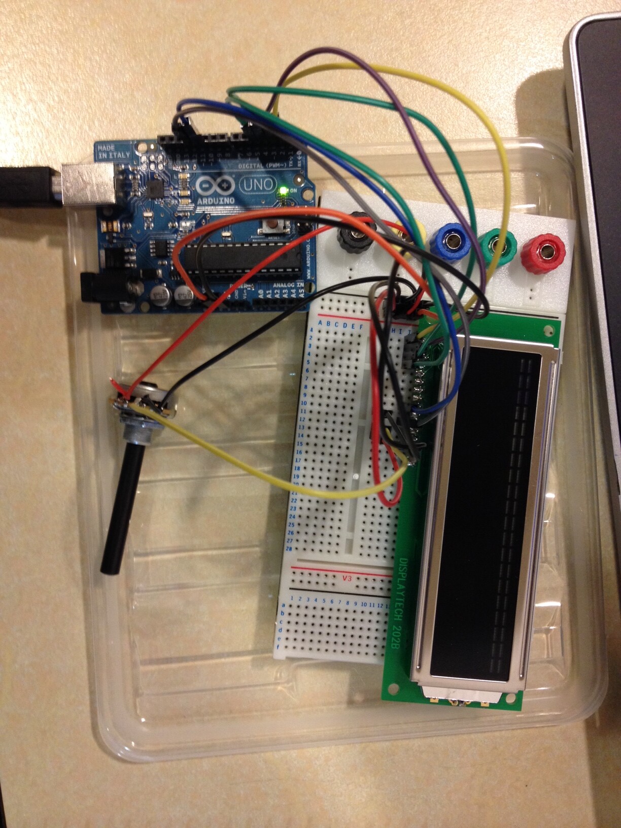

I am trying to display the "hello world" characters on my LCD display ( Model: "Displaytech 202B).
I am following the codes below that are given as example on arduino sketch. I have wired up my ardino-LCD exactly as it is instructing on the sketch.
But, after running the code, my LCD doesn't get the power and it doesn't do anything actually. Where is my fault?

The picture of my wiring up is attached here.
Your wiring is incorrect. Read this:
The Vo pin controls the LCD contrast, and must be hooked up with a potentiometer as per the wiring diagram.
Reading the tutorial is a good starting point. In the tutorial's schematic, they don't show power being supplied to the LED backlight.
MANY people have had problems starting with LCDs. Don (aka FLoestra) has often posted his checklist to getting an LCD working. One thread you can find it in is 1602a not displaying texts - Displays - Arduino Forum
Item #1 in his checklist addresses the backlight.

OK, three things missing here, and in order of priority:
1} Light it up. Pin 1 is in fact, the one near to the end of the board. Pin 16 then should be connected to ground on the Arduino, and pin 15 to Vcc (5V) through a 100 ohm resistor as the specification sheet is a bit confused as to whether this resistor is actually provided on the LCD board in this model.
Unless it is lit up, you simply will not be able to see what you are doing.
2} Set the contrast voltage. A 10k potentiometer with ground and +5V at the ends and the wiper connected to pin 3 is usual, but you should get a "good enough" approximation with a 1k resistor from ground (pin 1) to pin 3 and a 10k resistor from pin 3 to Vcc (pin 2). Without this correct voltage connected you will get nothing on the display at any time.
3} The Read/ ~Write line - pin 5 - must be connected to ground. You appear to have it connected to pin 11 on the Arduino bit it should be pin 6 on the LCD to pin 11 on the Arduino.
I think if you correct all these problems, it is most likely to work.

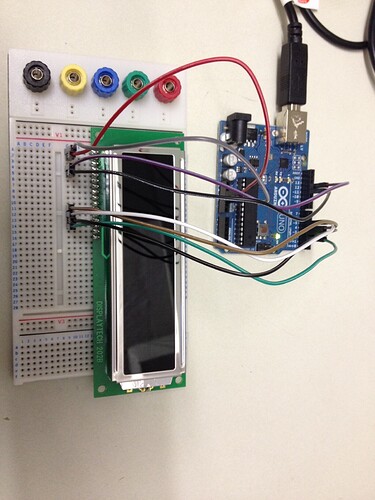

@MAS3 , now your explanation makes a lot of sense. I have done my wiring exactly as it supposed to be (according to the data sheet pin formate and the tutorial: http://arduino.cc/en/uploads/Tutorial/LCD_bb.png).
But I am still not getting anything on the LCD display (except the first two row lit up; as you can see on the picture).
There is no contrast and brightness on my display, niether it displays any text. Is there anything wrong with my LCD?

That's actually different from where you started. Originally, you said the display did nothing. Now it is displaying some, albeit incorrect, things. You need to make sure you give us accurate information as we move forward, or else we diagnose the wrong problem. The picture is definitely useful.
Could you please tell me what else info you need in order to move forward? I will be happy to come back with that.

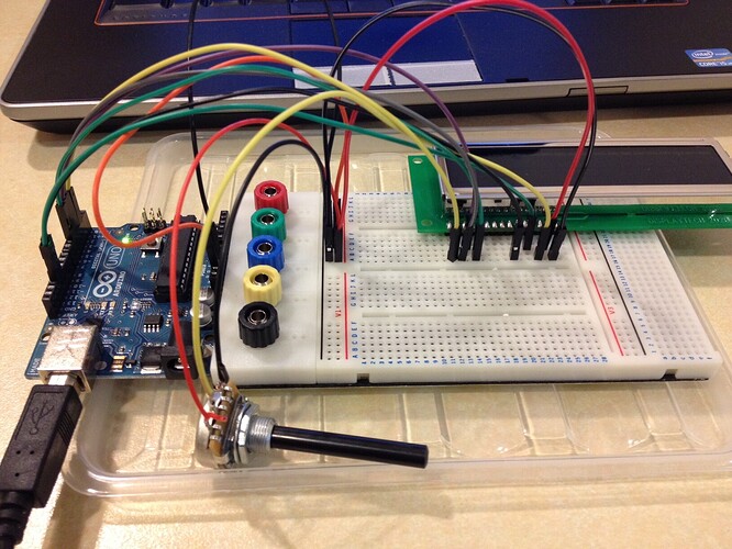

However, this time my connection is exactly the same as you see the picture below.
Do you want that I upload a clearer version of my wiring picture here again?
To my eyes, that's now starting to look like a broken display. The fact that it's displaying something, but nothing sensible is not a good sign.
Let's see what other people think.
Your wiring doesn't look correct to me.
Please check your wiring and make sure it matches the tutorial image you're attached,
At the very least, it doesn't look like Gnd, Vcc and Vo are correctly wired. They should be going to the LCD pins 1,2 and 3. It looks like you skipped a pin in the middle.

I wired everything once again, but it is behaving still in the same way. No light on the display, only the first row is lit up (if u have a closer look on my LCD, u will see).
As I say, it's starting to look like a broken display to me.
Let's see what others think.

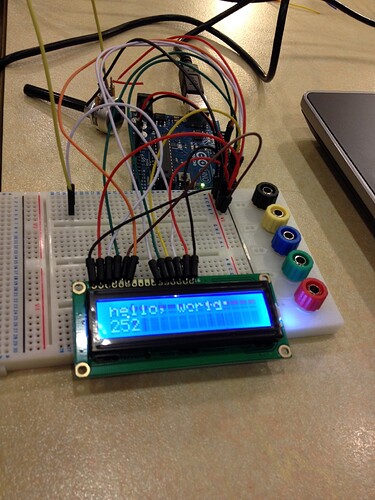

So, now I am nearly successful! arduinodlb, was right, my LCD was broken (since I got it from school lab and many use that uncarefully)
I bought a new LCD and wired that up. It's able to print out the "hello, world". But, there is a very simple problem. If you see the characters very carefully that every single letter is missing a segment. As an example, if we see the letter "h", there is a missing portion at the verticle line. And the whole "hello, world" line is not completely clear.
WHat I guess that is it has something to do with changing contrast with potentiometer. But, i tried by changing the contrast. It doesn't make the texts very perfect.
Do you think that adding a resistor can solve the issue?
I am sure it will not.
You have placed your display on top of the breadboard, and put some jumper wires through the holes of the module into the breadboard.
The breadboard is kind of spring loaded so the wires will make contact to the breadboard.
Your display is not spring loaded and i'm sure there is no stable contact there.
Solder pins to the module , and after that put those pins in the breadboard.
Connect the wires to the corresponding breadboard contacts.
You might consider soldering the wires directly to the display too, but that way you loose some jumper wires for your next project.
By the way, the photo's aren't clear enough to be sure, but it looks to me like you didn't wire the backlight LEDs.
That doesn't tell anything about the wrong or absent characters, but it's for sure why reading then display was hard.
