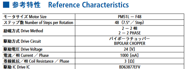

Hi, i have come across a stepper motor from a printer.
The motor is a PM51L—F48, online i couldn't find much more than the producers
(datasheet).
The motor is listed as two phase 24V and 1 A, i have never used a stepper but i think i know how it works, so i believe a DRV8825 driver IC would work for it.
By the description it should tolerate up to 45V and 2.2A with proper cooling.
thank you all <|:)

Where did you see that? From your link I see:
That means a rated Current of 1A and 3Ohm= 3W power per Coil
And it needs a chopper driver - e.g. the DRV8825 to drive it with 24V.

Are we talking about this stepper?
A DRV8825 with proper cooling should be able to drive it.
