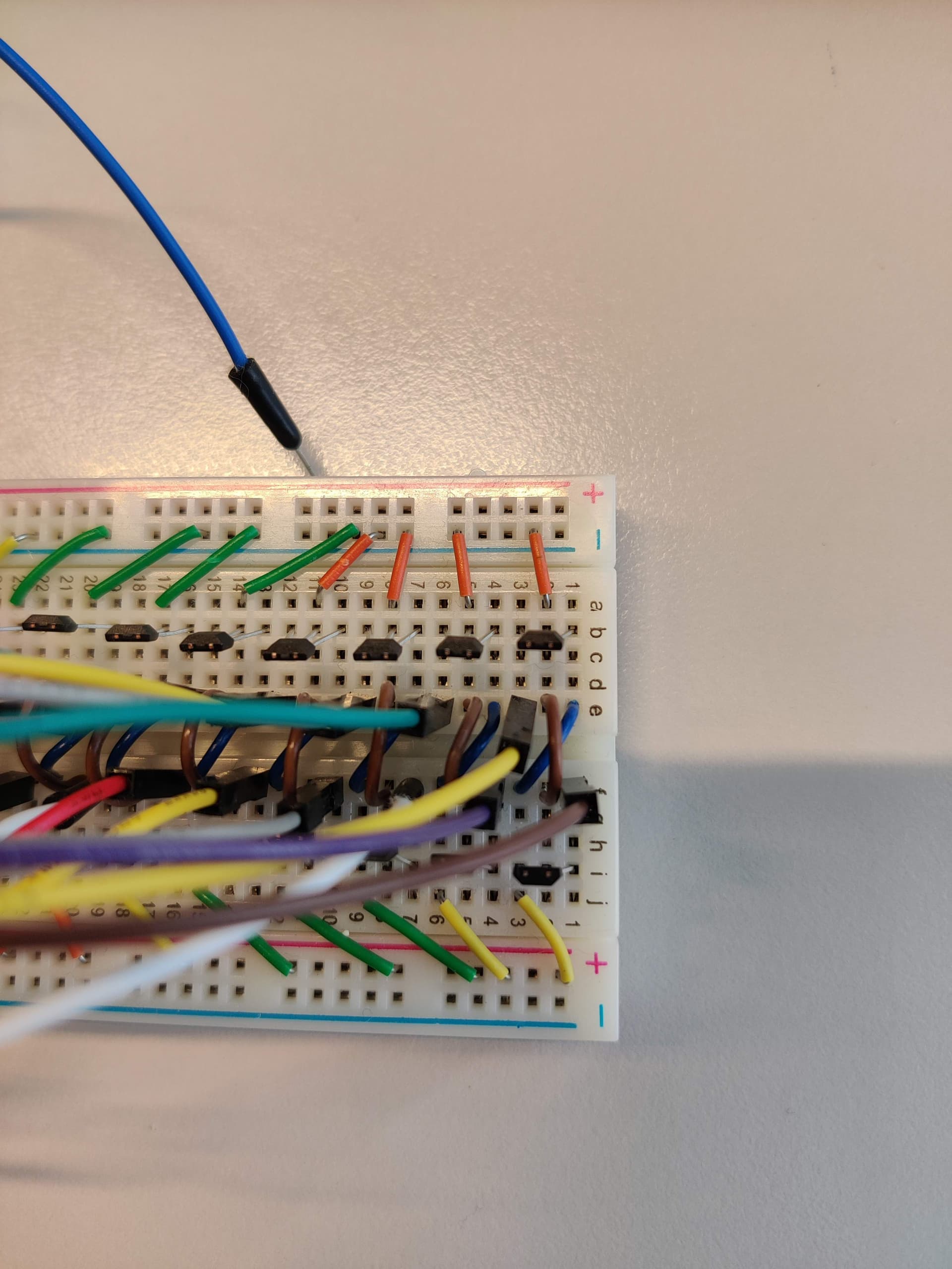

The circuit is quite complicated but I'll do my best to explain it (sorry about all of the wires).
On the left breadboard there are three multiplexers and four hall sensors. On the right breadboard there are 20 hall sensors. As you can see in the picture, I connected the two halves of the right breadboard to tidily connect the sensors in pairs, to reduce the amount of long wires. The long wires of the sensors are going into the multiplexers' analog inputs. Everything is in parallel (right?). The two breadboards' + and - are also connected.
Let me know if anything is unclear.

All of it. Need a schematic!
I don't notice any .1µF decoupling caps in use. Rule of thumb is one per digital IC, between Vcc and GND.

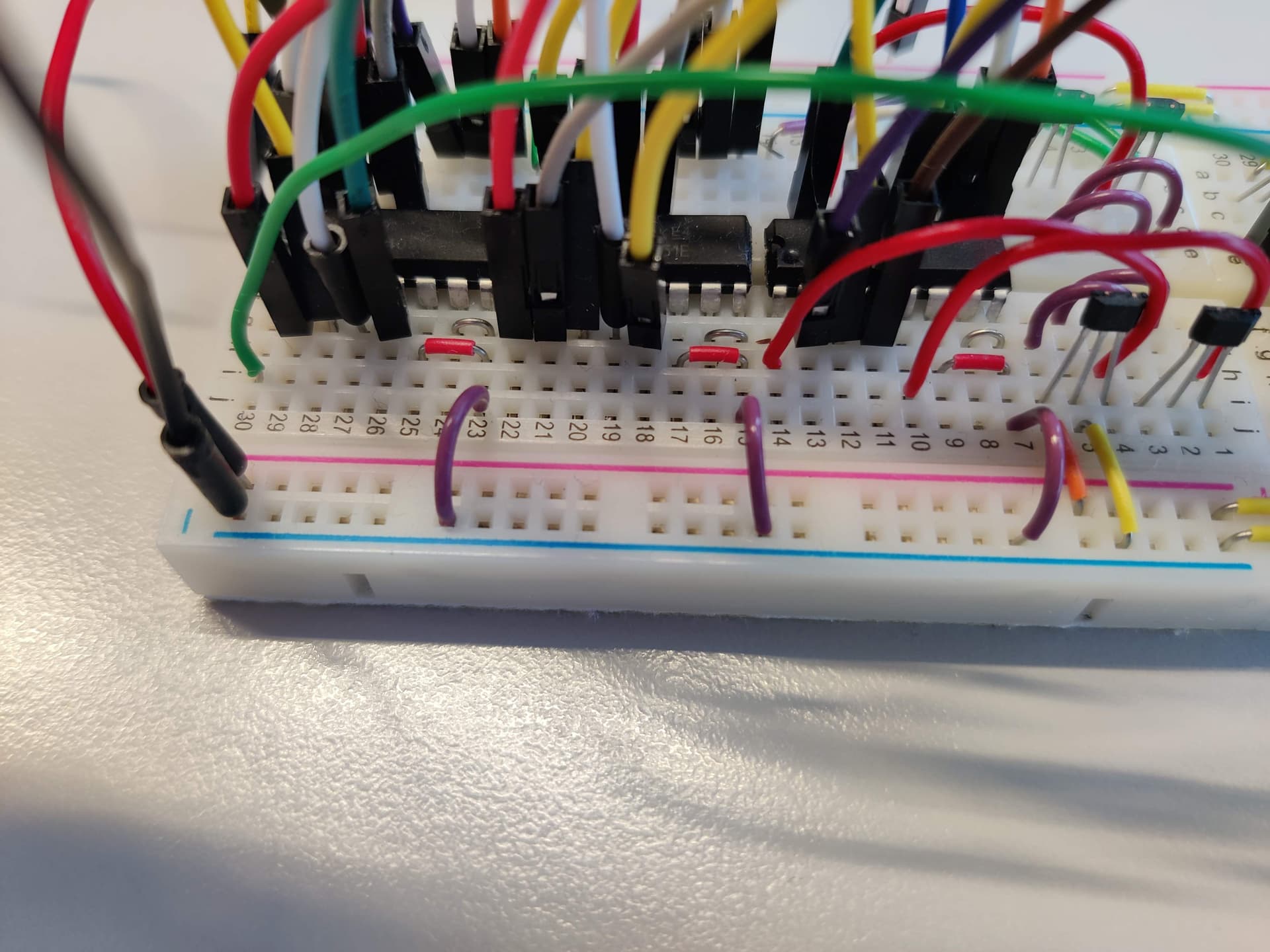

The multiplexers look like this:
The adress selector pins are directly connected to the Arduino, and the Vout's of the hall sensors go directly into the analog inputs of the multiplexer.
I have noticed by the way that moving the USB cable or the circuit causes the offset of the signal. If I keep it in the same place for a long time without touching anything, the output is very stable. Maybe the cable is faulty? I am using the USB for both the power supply and the serial monitor.

That's a total of 172+ mA just for sensors - although the graph in the characteristics section indicates around 190mA (7.6mA each x 25). Your schematic shows the sensors powered by the Arduino.  IIRC, 200mA is the most the onboard supply will safely provide.  It looks like your pretty close to that number.
First, your circuit looks fine. There are opportunities for simplification, but nothing glaringly wrong.
Potential problem #1: breadboards are infamously bad at handling low-level signals. Going by the number of bits you're seeing a change on, there is likely something else going on, but be aware that the breadboard is probably contributing to it.
Suggestion #1: measure the voltage on your breadboard across 5 & GND. Make sure it is actually 5V or close to it. The arduino typically can't supply a lot of current and each Hall sensor consumes around 7mA so that may be causing the supply to droop.
Suggestion: switch the mux to a single Hall sensor and measure the voltage at the output of the mux and compare that measurement to the output at the Hall sensor itself. They should for all intents and purposes be identical.
Next, read the same input from the arduino continously. Don't switch the mux. The voltage read by the arduino should match to within 15mV or so (allowing for 3 bits of error or jitter). If that works as expected, the problem is likely related to switching the mux channels. And that would most probably be software-related.
