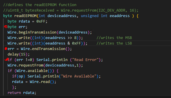

I have tried progressively adding all the libs that I use in the main clock sketch and the standalone code continues to work without issue. I will continue to check it this way but just wondered if there any known clashes which would cause this to fail.
The read function is super simple and very clearly knows to read data from the external device and yet it returns 0xFF every read (which is set in the read function as a default returned value).
I will add some debug print statements in that function to check that the address is set right at that point as well as to see what if (Wire.available()) actually returns.
Thank you for any pointers

After some debugging I can confirm that the device address is being passed correctly however the if (Wire.available()) test is failing ie. Wire.available() is returning false.

I first had to convert your code for use with the the Arduino IDE and I think that I did succeed.
Your problem is more than likely the following warning that I got
C:\Users\bugge\OneDrive\Documents\Arduino\1_forum.arduino.cc\1353797_eepromClash\Nixology_Panaplex_8_digit.org\Nixology_Panaplex_8_digit.org.ino:2508:71: warning: iteration 8 invokes undefined behavior [-Waggressive-loop-optimizations]
 2508 |   for (int zerobits = 0; zerobits < 9; zerobits++) BitArray[zerobits] = 0x00;
C:\Users\bugge\OneDrive\Documents\Arduino\1_forum.arduino.cc\1353797_eepromClash\Nixology_Panaplex_8_digit.org\Nixology_Panaplex_8_digit.org.ino:2508:35: note: within this loop
C:\Users\bugge\OneDrive\Documents\Arduino\1_forum.arduino.cc\1353797_eepromClash\Nixology_Panaplex_8_digit.org\Nixology_Panaplex_8_digit.org.ino:2508:71: warning: 'void* __builtin_memset(void*, int, unsigned int)' forming offset 8 is out of the bounds [0, 8] of object 'BitArray' with type 'unsigned char [8]' [-Warray-bounds]
C:\Users\bugge\OneDrive\Documents\Arduino\1_forum.arduino.cc\1353797_eepromClash\Nixology_Panaplex_8_digit.org\Nixology_Panaplex_8_digit.org.ino:547:15: note: 'BitArray' declared here
  547 | unsigned char BitArray[64 / 8]; // space for 64 bits
You're writing outside the bounds of the array; array indices run from 0 to the size of the array minus 1 so the maximum index is 7 and you're writing the non-existing BitArray[8]. After that all bets are off.

//defines the readEEPROM function
byte readEEPROM(int deviceaddress, unsigned int eeaddress ) {
  byte rdata = 0xFF;
  Wire.beginTransmission(deviceaddress);
  Wire.write((int)(eeaddress >> 8));      //writes the MSB
  Wire.write((int)(eeaddress & 0xFF));    //writes the LSB
  Wire.endTransmission();
  delay(15);
  Wire.requestFrom(deviceaddress,1);
  if (Wire.available()) {
    Serial.println("Wire Available");
    rdata = Wire.read();
  return rdata;

// eeprom raed testing
for(int readword=0; readword<10; readword++)
wordpointer = 0; // reset word pointer
//Now Read 4 bytes
  for(int address = (readword * 4); address< (readword*4+4); address++) {
  wordtext[wordpointer] = readEEPROM(eepromaddr, address);
  wordpointer++;
// now print out contents of wordtext
Serial.print(wordtext[0]);
Serial.print(wordtext[1]);
Serial.print(wordtext[2]);
Serial.print(wordtext[3]);
Serial.println("");
Serial.println("Words Tested");

Very many thanks - I had (thus far) ignored most of the Yellow (in platformIO) warnings. I will now go through and eliminate these (or is that what you did in the code that you posted?
No, I did not eliminate the error so it's still in the code that I showed.
Note / edit:
I had to copy some files from your zip and placed them in the sketch directory and included them with double quotes.
I have resolved the bounds issue and no longer get those errors though the eeprom read still returns 0xFF instead of the real data.
I also removed the test to see if (wire.available) and it still returned 0xFF.
I got distracted by my 'other' issue which turned out to be hardware related and not software so now I need to get back to this. Fortunately I can test it on standalone hardware (ie. a Wemos D1 Mini with the eeprom board connected). I'll set about adding in bits until it breaks. Assuming I get to that point I can then set about seeing why it breaks and fix it.
At this stage I'm assuming that it's going to be some library conflict thing, I will report back asap.
I added and initialised all the libs from my main clock code into the small test code and the small test code still read the data OK.
I research some more and found that I could test for read errors, I implemented this in the small test code and it still read the data OK.
I put the same mods in the main clock code and it showed that it was getting read errors.
The image shows the additional steps to crudely show that there was a read error.
Now I need to look at how to debug read errors.
In desperation and clutching at straws I decided to add a Wire.begin(0x50); in the readEEPROM section as follows:
et voila!
It now reads the data from the eeprom correctly.
Could anyone explain to me why this step was necessary?
Here is the output from the test that I implemented within the main clock code:
Which shows groups of 4 bytes albeit in hex notation.
