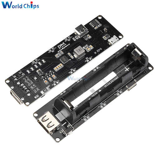

How small? If consumption of entire project is low enough, maybe shield with 18650 battery will work.
If needed and higher voltage, just add DC DC boost converter like MT3608.

Anyone know of any duel wall wort or battery supply versions? I'd love the option.
