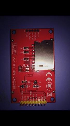

I am working on QVGA 2.2 tft spi 240*320 display.I completed all basic steps and connections.My connection of display with arduino uno as describe bellow.
Port 11 = MOSI
Port 12 = MISO
Port 13 = SCK
Port 10 = CS
Port 8 = Reset
3.3V = LED
GND=GND
3.3=Vcc
I connect my LCD with arduino uno using above pin connection.If any modification or suggestion in this connection required then please let me inform.
I am also getting confused about library. Currently I'm using TFT library,GFX library and ili9341 library for interface LCD with my arduino board.Suggest me other library if it's equire to be included in my program. Send me link for that if possible.
I want to inform you that there is no error shown by compiler so i think that there must be something wrong in connection.I get nothing on display except full white screen.I want to know the reason behind it. Please help me to get out from this.

These displays must have 3.3V logic. The Uno has 5V logic levels.
i.e. use resistors or level-converter chips.

Instead of logic level convertor chip, I had used voltage divider circuit using 1Kohm and 2 Kohm resistor to reduce the voltage nearly 3.3V.
GitHub - adafruit/Adafruit_ILI9340: This is a library for the Adafruit 2.2" SPI display. and GitHub - adafruit/Adafruit_ILI9341: Library for Adafruit ILI9341 displays are included and run the graphics test example but didnt found any result on tft and shows white screen only.

Ah-ha. You have the display with "yellow header" and unmounted Flash chip. (unmounted 5-pin SD/Flash header)
I possess one of those. I get a White Screen too. I am sure that I had it working at some stage.
I can read the registers. Everything seems normal for a genuine ILI9341V controller chip. i.e. identical results to the more common display with "black header" and unmounted 4-pin SD header.

About 1 year ago, i had a yellow header 9341 connected to a Nano board with resistor divider's.
It did not work, until i hardwired RST to the Nano 3.3v pin....
Both Black header and Yellow Header boards require the RESET pin to be under program control. (or pulled high)
As far as I can see, the Yellow header design is identical to the Black header version. Except for the Flash chip footprint and extra F_CS pin.

I have identical yellow header 2.2 displays.
The key with these displays when using a 5V Arduino board is to use level converters as described in step 2 here.
Try an Adafruit_ILI9341 library example such as graphicstest and make sure you configure the pins in the sketch correctly and add the RESET line too (not in the sketch example as provided), with your setup you would use:
#define TFT_DC 9
#define TFT_CS 10
#define TFT_RESET 8
// Use hardware SPI (on Uno, #13, #12, #11) and the above for CS/DC
Adafruit_ILI9341 tft = Adafruit_ILI9341(TFT_CS, TFT_DC, TFT_RESET);
Note that the pin has been added to the constructor as shown in bold.
Hmm the reset pin need to define and attach.
The example code of graphic test is working fine.
But as I remove the usb port after loading the code in arduino, the display become blank and as again connect the usb to laptop its working fine.
