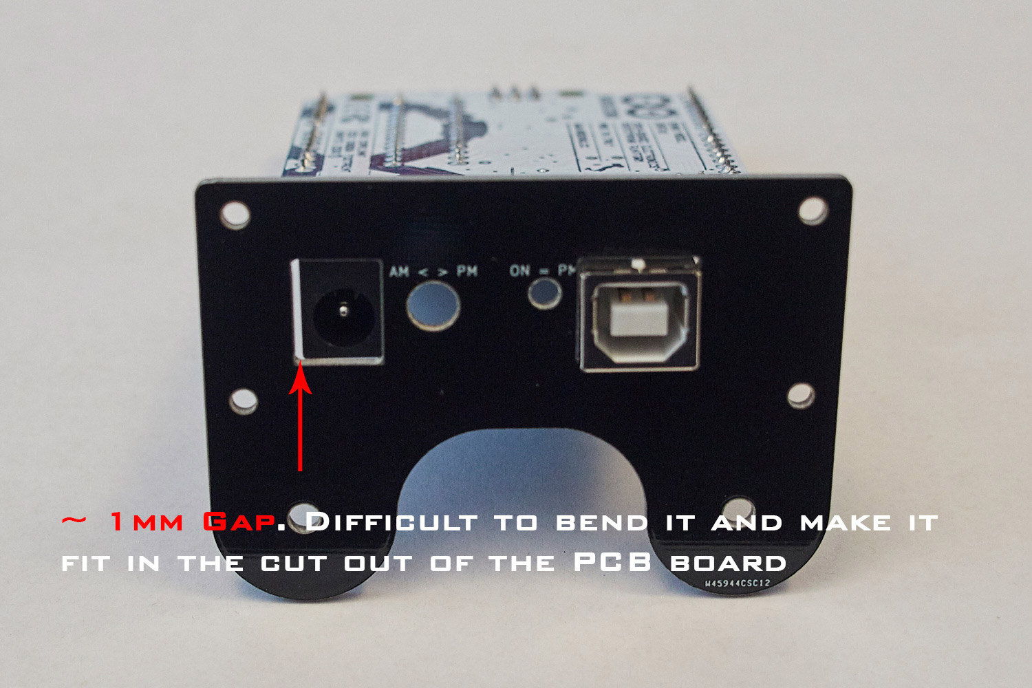

I use those DC sockets on different circuit board designs, and it's not easy to line them up exactly
(I do have a reflow oven).
A problem if you use custom milled faceplates.
It can be easilly fixed by re-heating the solder of one or two pins of the socket, and move the socket in position.
There is a bit of flex in those sockets, so you can move it a mm or so without reflowing.

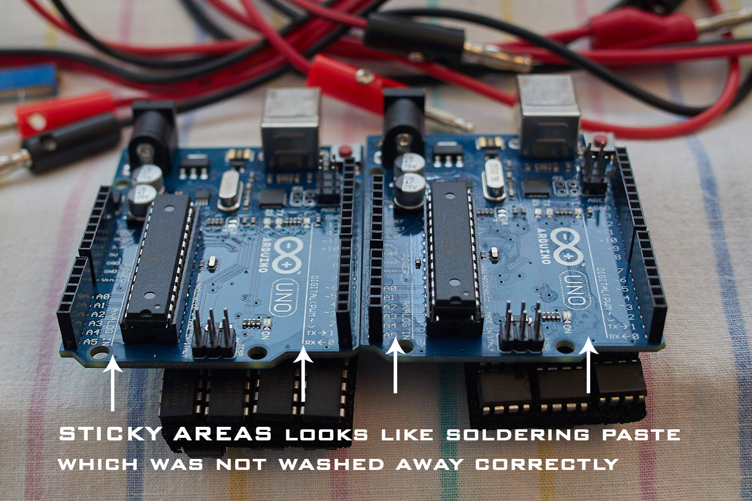

The residue looks bad.
It shouldn't be there on official/expensive boards.
You can wipe it off with a cotton bud dipped in alcohol, but it shouldn't be needed.

I can understand about the connector being off and it would probably be a good idea to add more tolerance to your PCB if you do another design but that residue is definitely not what you expect to see after paying good money for an authentic Arduino.
I doubt there was any specification for connector positioning in the first place... If you design an
enclosure base it on measurements from an official enclosure, not an official board.

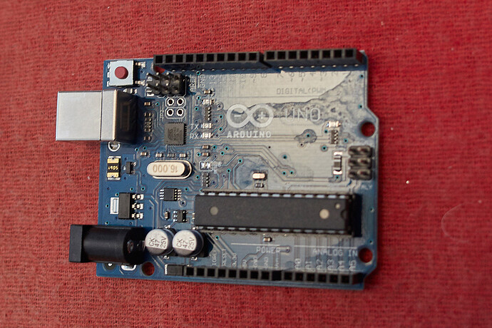

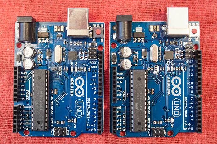

Out of interest, how are you sure the parts you bought from your Mexican supplier are geniune ?
To me they don’t look like genuine boards or maybe not new. Check against this :
https://www.arduino.cc/en/Products/Counterfeit
I would have to agree, looking at those boards, compared to the website given above, Everything that I see tells me they are fake. If you purchase them as genuine Arduino's, you need to contact your supplier. It is your supplier's responsibility to make sure they are not selling fakes. It is one thing if your boards are marked as not being genuine Arduino's, It is a whole different story when they tried to pass them off as genuine Arduino's. This introduces an element of fraud.

The footprint I took was made by a french guy and I am working with KiCad to make my PCB. The first batch I made the Arduino did fit nearly exactly as I bought it.

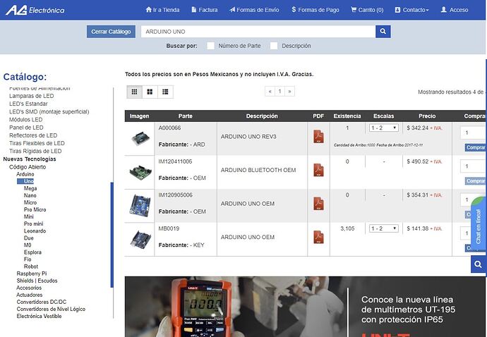

BTW, I just did take a look at the Arduino link about the official resellers in Mexico. There is listed one with the name AG Electrónica, I have bought from them, and now I ask ¿ what guarantee I have he sells me the original ones ? as I just have visited that site and he sells Generic Arduino too :slight_smile:
So ¿ how can I be sure ? No idea :slight_smile:

Well yes, after reading all the posts and analyzing my boards they are fake.
As a newcomer I thought I was buying something original but no ...
