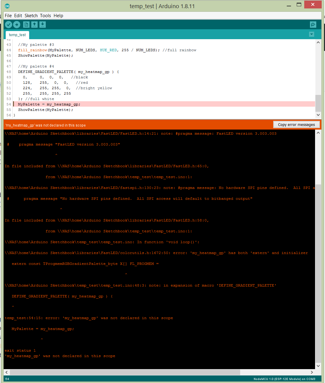

Does anybody compile sample from here: link?
My code:
#include <FastLED.h>
#define LED_PIN     8
#define BRIGHTNESS  96
#define CHIPSET    WS2811
#define COLOR_ORDER GRB
#define NUM_LEDS 16
CRGB leds[NUM_LEDS];
  FastLED.addLeds<CHIPSET, LED_PIN, COLOR_ORDER>(leds, NUM_LEDS).setCorrection(TypicalSMD5050);
void ShowPalette(CRGBPalette16 aPalette)
  for ( int i = 0; i < NUM_LEDS; i++)
    leds[i] =  aPalette[i];
  FastLED.show();
  delay(2000);
  CRGBPalette16 MyPalette;
  //FastLED embedded palette
  ShowPalette(LavaColors_p);
  //My palette #1
  fill_solid(MyPalette, NUM_LEDS, CRGB::Black);
  MyPalette[4]  = CRGB::Red;
  MyPalette[8]  = CRGB::Green;
  ShowPalette(MyPalette);
  //My palette #2
  fill_gradient_RGB(MyPalette, NUM_LEDS, CRGB::Red, CRGB::Blue);
  //My palette #3
  fill_rainbow(MyPalette, NUM_LEDS, HUE_RED, 255 / NUM_LEDS); //full rainbow
  //My palette #4
  DEFINE_GRADIENT_PALETTE( my_heatmap_gp ) {
    0,     0,  0,  0,   //black
    128,   255,  0,  0,   //red
    224,   255, 255,  0,  //bright yellow
    255,   255, 255, 255
  }; //full white
  MyPalette = my_heatmap_gp;
Error message is: 'my_heatmap_gp' was not declared in this scope on the last line.
FastLED version 3.3.3.
See screenshots:
Just for convenience, screenshots are here: link
What am I doing wrong?
Ok, got it.
DEFINE_GRADIENT_PALETTE must be outside of the function declaration, not within, of course.. My fault.
