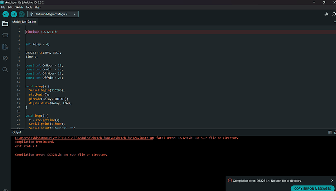

Fatal error during compilation
In file included from C:\Users\ashish\Desktop\study\Trigger_Relay_with_DS3231_RTC\Trigger_Relay_with_DS3231_RTC.ino:2:0:
C:\Users\ashish\AppData\Local\Arduino15\packages\arduino\hardware\avr\1.8.6\cores\arduino/DS3231.h:27:11: fatal error: hardware/avr/HW_AVR_defines.h: No such file or directory
#include "hardware/avr/HW_AVR_defines.h"
compilation terminated.
exit status 1
Compilation error: exit status 1
pls help me to solve tis issue that i am facingUse code tags to format code for the forum

Which Arduino board are you compiling for ?
Does it use an AVR processor ?
That file is not part of the IDE, it is part of the DS3231 library.
How did you install the library?
I am using arduino uno r3
Arduino uno r3
How did you end up with that file in the core directory?
3rd party libraries should be in the libraries directory under the sketchbook directory; you can find the sketchbook directory in the preferences (file/preferences).

No, I would like to know why you have 3rd party library files in there.
Buddy if you can do any help then pls help can you compile that program that i had in previous thread and if it is working in your system then pls tell me how it works which library you are using and where you place that library (means i want to know path location)
and you last question's answer is i used that 3 party library because in arduino ide, ds3231 library also not working properly thats why i search online and found rinky dink ds3231 now the whole code compiled without any error showing before this library i got in many of the line give error,

Compare the program from post #11 with post #13. The program from post #13 compiles on my system, post #11 does not. The reason might be that the parts that you used came from a different example and uses a different library.
If you haven't done so yet, delete the DS3231 files that show in your first screenshot in post #8. The DS3231 in the second screenshot should be the RinkyDink DS3231 library. You can verify by opening one of the two files in e.g. notepad and the beginning will look like

still showing error

The cause of the error seems quite clear. The compiler cannot find the DS3231 library
Is it installed on your PC and, if so, which directory is it located in ?
What is in the DS3231 directory in the second screenshot of post #8? This is the extracted RinkyDink DS3231 library directory on my system.
