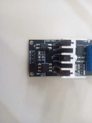

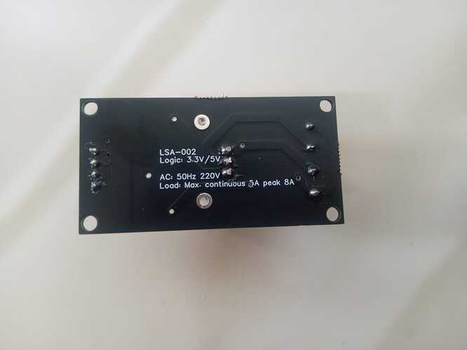

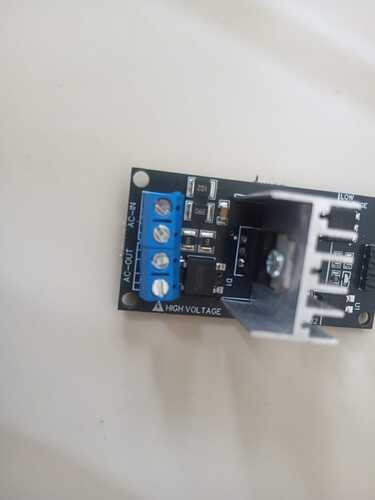

Fatal error: esp_intr.h: No such file or directory
I'm using esp32 devkit v1 with 38 pins and trying to run an ac dimmer module that is not robotdyn brand but uses the rbddimmer library. when I try to use and upload the RBDDimmer library example “SerialMonitorDim”. the error code appears, I'm confused about what I should do. Thank you very much

esp_intr.h is part of older v2 ESP32 board platform. The current version (for a little over a year) is v3, which no longer has this file. The library has apparently not been updated.
You can downgrade the esp32 board version: the last v2 is 2.0.17
if you wish to use ESP32 core 3.x have a look at System - under esp_hw_support
The header file esp_intr.h has been deleted. Please include esp_intr_alloc.h to allocate and manipulate interrupts.
