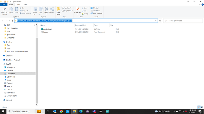

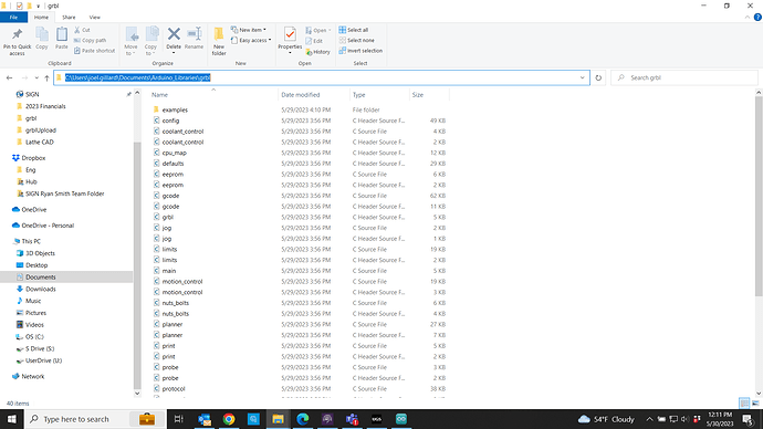

Hi.  I'm having the same issue.  I've tried to follow these instructions exactly but same result.  Here are some details.
C:\Users\joel.gillard\Documents\Arduino Libraries\grbl\examples\grblUpload\grblUpload.ino:27:10: fatal error: grbl.h: No such file or directory#include  <grbl.h>
Using Arduino IDE 2.1.0.  I've downloaded grbl from here GitHub - grbl/grbl: An open source, embedded, high performance g-code-parser and CNC milling controller written in optimized C that will run on a straight Arduino  and extracted the files.
I've placed the grbl folder here
Hope this is sufficient detail to spot my issue.  Thanks in advance.  Joel

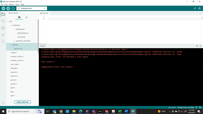

              Spaces in path names confuse things.
I bet if you created an empty file named grbl.ino in your existing directory:
C:\Users\joel.gillard\Documents\Arduino Libraries\grbl\grbl\
so it is at:
C:\Users\joel.gillard\Documents\Arduino Libraries\grbl\grbl\grbl.ino
and then opened it in the IDE, it would work like:
              Additionally pictures of error messages are not as much use as the ACTUAL text, paths, etc.
And this link is to a search  to get you going.
              Thanks for helping all.  Here is my error code#include  <grbl.h>
exit status 1
Compilation error: grbl.h: No such file or directory`
Here is the file I'm selecting
I've looked at the other forum post that are similar you list and I'm doing my best to follow exactly but still get the same error.  I'm doing something wrong.  Appreciate the advice.
              Here is the path
              D:\Arduino sketches an libs\grbl\grbl\examples
This is mine but I have my sketches in an alternate folder.

On my Mac my libraries are at:
/Users/drf/Documents/Arduino/libraries
So I think your Arduino libraries might be under your Documents/Arduino in:
C:\Users\joel.gillard\Documents\Arduino\libraries\
so you would want a path more like:
C:\Users\joel.gillard\Documents\Arduino\libraries\grbl\examples\grblUpload
but I'm not sure of the upper-or-lower case.
But rather than mess with libraries, I would suggest making an empty grbl.ino file in what might be your:
C:\Users\joel.gillard\Documents\Arduino_Libraries\grbl\grbl\
...directory.  Then compiling that grbl.ino would work like compiling any other script, without messing with library paths and examples.

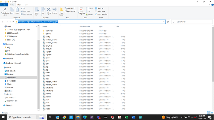

              Thank you both for helping very much.  I've deleted the Master folder previously.
I don't understand why the file path matters.  If I open and run grblUpload in the file structure already existing when I download from github, why doesn't that work?
Here is what my file structure looks like

The examples in the file structure depend on the rest of the file structure being properly installed as a library in the Arduino's library directory.
If you add a grbl.ino file into the file structure, it looks for the other files relative to the grbl.ino file and doesn't depend on the rest of the files being properly installed as an Arduino library.
Here's my file structure (using the grbl.ino as a normal sketch method):

Note the grbl/grbl/grbl.ino file with size 0 -- the Arduino IDE starts with that and assembles everything else.
                DaveX
                    May 30, 2023,  9:16pm
                  12
To be clear -- your files do not look like they are properly installed in the Arduino's library directory.  They look like they are in your 'Documents/Arduino_Library' directory rather than (what on my Mac would be) 'Documents/Arduino/library'   'Documents/Arduino/libraries'
              Thanks so much for your time and patience.  I have created a blank grbl.ino (no lines of code) and saved to Documents/Arduino/Library/.  I then run grblUpload.ino and get the same error.
If I run the blank grbl.ino I created I get this error
C:\Users\JOEL~1.GIL\AppData\Local\Temp\ccqPrCyO.ltrans0.ltrans.o: In function main':setup' C:\Users\joel.gillard\AppData\Local\Arduino15\packages\arduino\hardware\avr\1.8.6\cores\arduino/main.cpp:46: undefined reference to loop'
exit status 1
Compilation error: exit status 1`
I'm very confused on what files I need to have where.  I'm new to Arduino.  I'm not sure if you mean a grbl.ino folder or grbl.ino sketch.  I have both now.  UGH.
                DaveX
                    May 30, 2023, 11:22pm
                  16
              Oops, I spelled it wrong in my last post -- "Documents/Arduino/libraries"  I'll mark that error in my last post.
Is there a Documents/Arduino/Library and Documents/Arduino/libraries on your machine?  The grbl goes in the second.
I'm not sure if the grbl.ino conflicts with the library method.
Here's a transcript of me using the standalone directory/grbl.ino method:

Then Arduino IDE and File/Open Downloads/Joel/grbl-1.1h.20190825/grbl/grbl.ino
Then select board Uno, then compile:
FQBN: arduino:avr:uno

              Ok, I final got it to work and upload grbl.  I had to select the grbl folder and create a .zip file.  The location of the files on your computer doesn't matter.
Then go to Sketch/Include Library/Add .ZIP Library....
Select Verify and select Upload.
I was then able to use a gcode sender with my Uno with attached CNC Shield, Driver, Stepper Motor.
Then go to File/Examples/grbl/grblUpload
              Indeed, my journey just begins.  Thanks for helping.
