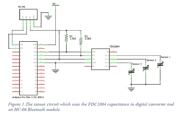

I am working on that design actually.
So connected from FDC1004 to arduino
  • SDA from FDC1004 to Arduino Mini Pro
  • SCL from FDC1004 to Arduino Mini Pro
  • 3.3 V from FDC1004 to Arduino Mini Pro
  • Gnd from FDC1004 to Arduino Mini Pro
and a capacitor between CIN1 and Gnd.
I have a schematic like that:
But no luck.
If you are a novice at electronic design, this will be a challenging project.
You are not following the recommendations for decoupling capacitors, and I can't imagine that it could ever work on a breadboard because of stray capacitances. Input lead design will also be critical.
See the Layout guide in the FDC1004 data sheet for a recommended PCB configuration.
