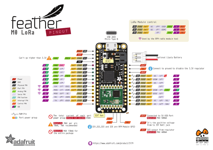

Hello,
I am trying to transfer a project from an arduino UNO to the Feather M0
Currently I am Using:
BMP180: SD Breakout : Neo6m gps:
3v 3v
3v GND GND
gnd CS ->10 rx->5
SCL->SCL DI ->11 Tx->6
SDA->SDA DO ->12
CLK -> 13

I followed the adafruit page for Transfering sketches but unfortunately I am not getting any output. Am i Missing something in the code? Or Is my pinout incorrect? I am not trying to send anything besides the hello world message yet. I just want to get the SD card recording GPS and Barometer data.
Thank you.
Not certain since you did not supply a link to your specific board but the SPI pins appear to be marked SCK, MOS and MISO, not 11/12/13 per the atMega328 standard.
WattsThat:
Thanks for the Reply. I ended up reading this on the adafruit guide and switching to these pins But unfortunately The result was the same. But at least now I know that something is incorrect in my Code rather than the pinout.
WattsThat:
adafruit Feather M0 LoRa
