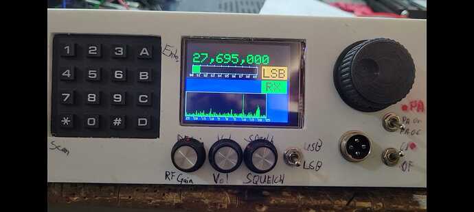

this is a simple "spectrum analyzer" that i have managed to make run to 100000ks/s, so i can recognize a 50khz signal, but if want to deal with the other signals coming from a radio like audio level batery voltage, current consuption swr measurements i think i need some faster code or another MCU, does anyone have experience doing something like this?

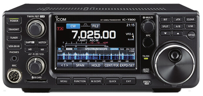

Here's a picture of the radio

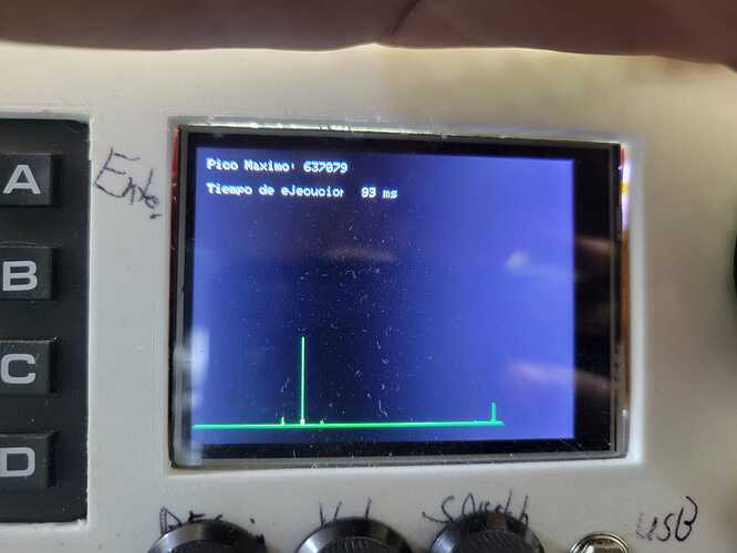

First of all thank you,
I managed to speed it up to 93ms average between screen refresh for the fft alone, this was due to some changes also made to the ADC prescaler of the Bluepill
This is a samplerate of around 288khz which lets me see a max of 144khz which to be honest is way more than i need, but its cool to have some room to spare, i think i can make it faster since ive seen some reports of 5Ms/s on other pages, but i think the real issue is the fft calculation itself.
i think if i can make it run over 15fps it would be great but the more the better, i will keep experimenting and reporting back.
In the meantime here is the code for the above mentioned results

Glad you got it going.
Another way to speed things up is not to use the display to print every transition. A much simpler way to measure the speed is to put a pin high at the start of a section you want to measure and put it low when this is done. Then measure the period on an oscilloscope.
Using a digitalWrite on an Arduino Uno takes about 4uS, but you can do this in a couple of clock cycles with direct port manipulation techniques.
The thing is, i dont care about transitions, i really want to do some simple dsp and show it on the screen, this is just the start but ideally i ant this, or something similar.
My project now its just the vfo, however i have started to work on the rf side of things, i dont want a lot of bandwidth, just enough to see whats happening around me.
i need to start to work on the waterfall graph now too :smiley:
