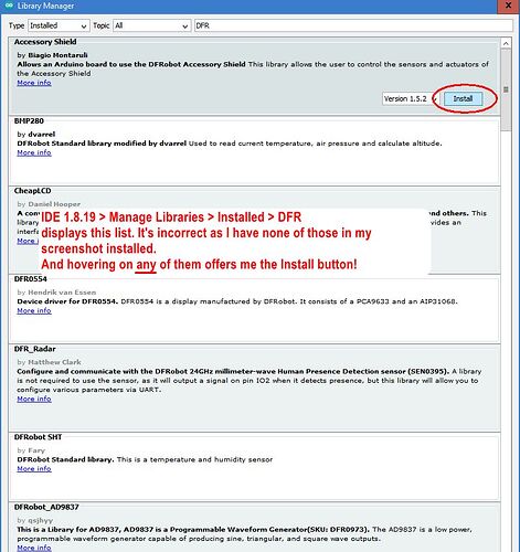

To see only installed libraries, you must select "Installed" selector AFTER any other filter settings . To get the picture above you probably first turned on "installed" and then entered search for "DFR". It doesn't work that way.
Select "installed" now, after searching for DFR libraries - and all of them will disappear from the results.

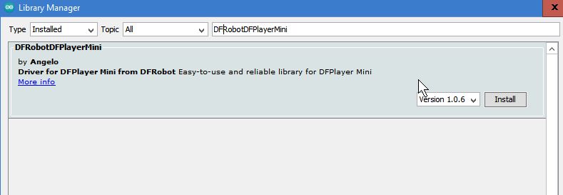

Thanks, that was fast! But I'd already tried that and have just done so again, with the same result.

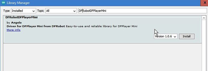

In case it's related, I also just tried to check that I still (deliberately) have version 1.0.5 of DFRobotDFPlayerMini installed, not the latest 1.0.6. Library Manager shows the following which obviously doesn't help:
I have to open my \libraries folder > and then open DFRobotDFPlayerMini, then open its library.properties file to establish that, yes, I do have 1.0.5 installed.
Oh, and nor does DFRobotDFPlayerMini appear with the Updatable filter.

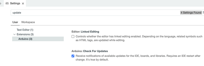

Don't know why that is. Have you perhaps turned off auto updates in order to preserve a library or board (as in the esp32 V3 issue)
It looks like the following
No. And I have been getting the occasional message ‘Some of your libraries need updating…’
But if there is some way of excluding a particular library, and I’ve applied it to my DFR library, and forgotten, then that would account for it! However, searching now for such a tool/setting/hack, I’ve not found one.
As far as I know it's all or nothing for IDE and library updates. I am very sure there is a reason on your PC/Mac that makes it work that way, perhaps a link, perhaps an invalid date (if they use that to determine updates)

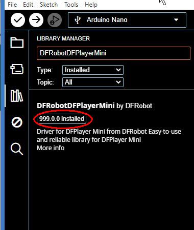

If you set Library Manager's "Type" menu to "Installed", do you see the library in the list of installed libraries?:
Thanks @ptillisch, you're a star! Answering your question immediately confirmed my growing suspicion. There is indeed a way to exclude individual libraries from updating. You recommended it to me less than six months ago in this post:
https://forum.arduino.cc/t/exclude-a-library-from-updates-available/1223521/5
The '999' instantly fixed those particular synapses in my ageing brain!
