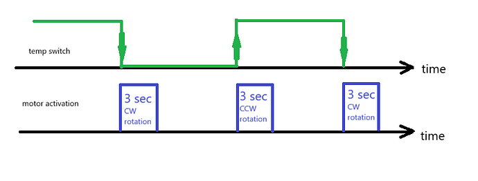

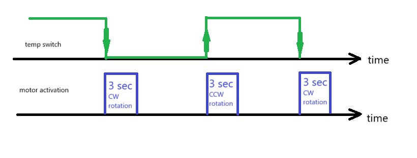

ok, thank you for your time.
Let me try to clear out any doubt with the signal chart.
  • When the button is pressed the motor rotate clockwise for 3 second and then stop.
  • When the button is released the motor rotate counterclockwise for 3 second and then stop.
