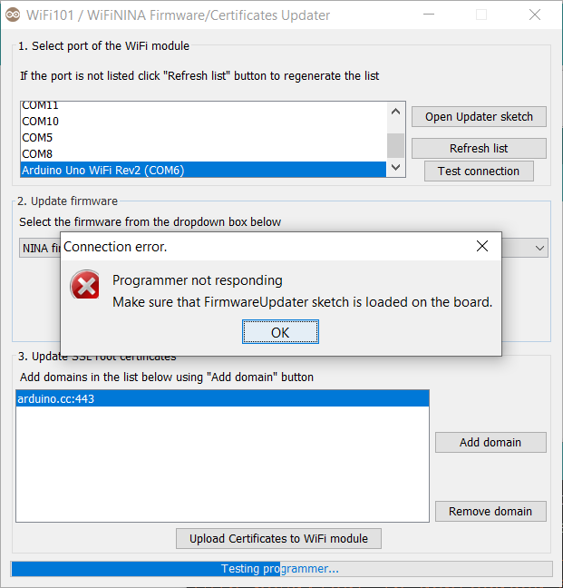

In step 7, downloading "Firmware Updater tool" seems to be correct.
In step 9, my IDE 1.8.7 proposes "WiFi 101 Firmware Updater" and not "WiFi 101 / NINA Firmware Updater"
In step 10, i click "test connection" => i got "connection error ... Programmer not responding"
In step 11, i got "Programmer not responding"
my configuration is : - IDE 1.87 - installed firmware is 1.0.0 (info from check tool).
Thanks for your help

Hi @kock,
From step 1) you should be using the hourly IDE build and not version 1.8.7. Today IDE v1.8.8 has also been released which also contains the new firmware updater for the NINA module.

Thanks for your support. After updating my IDE 1.8.7 to IDE portable 1.8.8 on Windows XP, i'm now running firmware version 1.2.1.

Atempting to use my new UNO Wifi Rev 2…but first wanting to update. Been using my UNO boards and 1.8.5 for long time with no problems.
After having issues with 1.8.12, I downloaded 1.9 BETA and my troubles all went anyway…or so I thought.
Following Sandeepmistry’s steps I got the library and and uplaoded the Firmware updater to my board.
But when I tried to test connection or do the update I got the error “Programmer not responding”.
So I then uploaded the CheckVersion script. It reported I had 1.2.4 but 1.3.0 was available.
Not sure what to do next.
Eager to start trying the BLE features.
Problem identified:
When you install the "WifiNINA library by Arduino", read the library title carefully. I found a library and it was "WifiNINA_generic by Arduino". And I thought that was it....it wasn't. Clicking on the "More info" brings you to the GitHub of the author.
Look for another entry in the library list called "wifiNINA by Arduino". You can confirm you got the right one by clicking on "more info" and you will be sent to the actually Arduino Library page. Install this library. My firmware update installed without issue following the instructions below.
https://forum.arduino.cc/index.php?topic=610052.0
I'm glad to hear you got it working @Titanium69. Thanks for taking the time to post an update with your solution. Enjoy!
