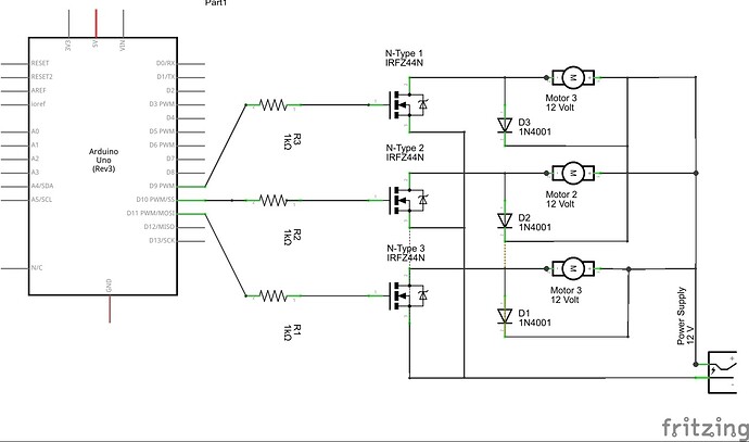

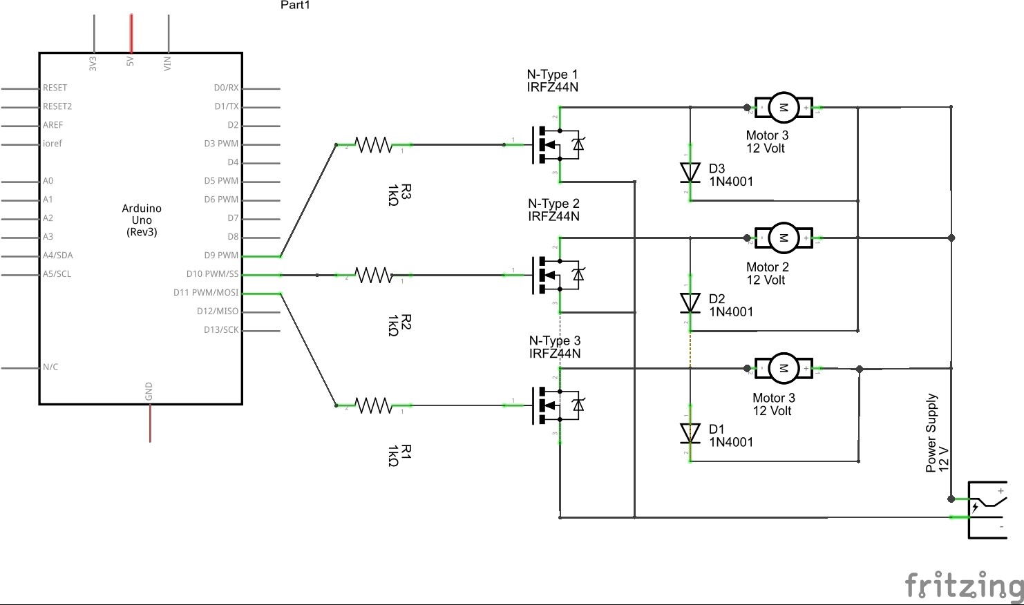

I'm currently working on the very beginning stages of an auto-dosing project for a hydroponic system. Basically, hooking up the Arduino to drive three DC Motors and a timing circuit. It will measure EC and PH eventually, but I'm starting simple. I've never done anything like this, so the going is slow.

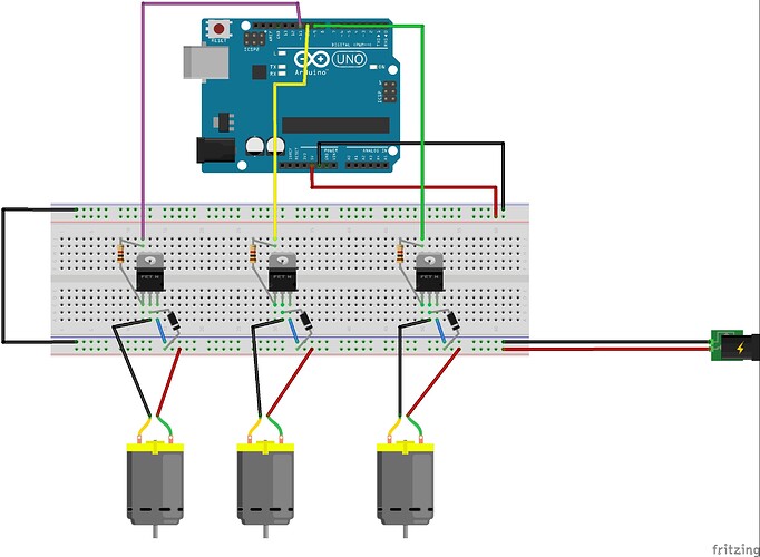

I figured I would start by simply creating the circuit/breadboard to run each of the motors without worrying about the timing circuit or anything else. The attached pictures are what I've come up with so far.
Question 1:
I used Fritzing, and the schematic has a couple "ratsnest (dotted)" lines that won't go away (between the 2nd and 1st diodes and the 2nd and 1st transistors)? Does this mean there is something wrong with the way I've drawn the circuit or manipulated the breadboard?
Question 2:
On the schematic, I haven't hooked anything up to the Arduino 5V and the Arduino Gnd like I did on the Breadboard. Is this ok? In other words, is it common practice that these connections are just assumed?
Question 3:
Does this circuit look like it will work (I will only be running 1 motor at a time).
Thanks tremendously in advance, really enjoying learning Arduino.

You will need a common ground between the Arduino and motor supply.
Use IRLZ44N
Q7 cct. with a motor rather than relay.

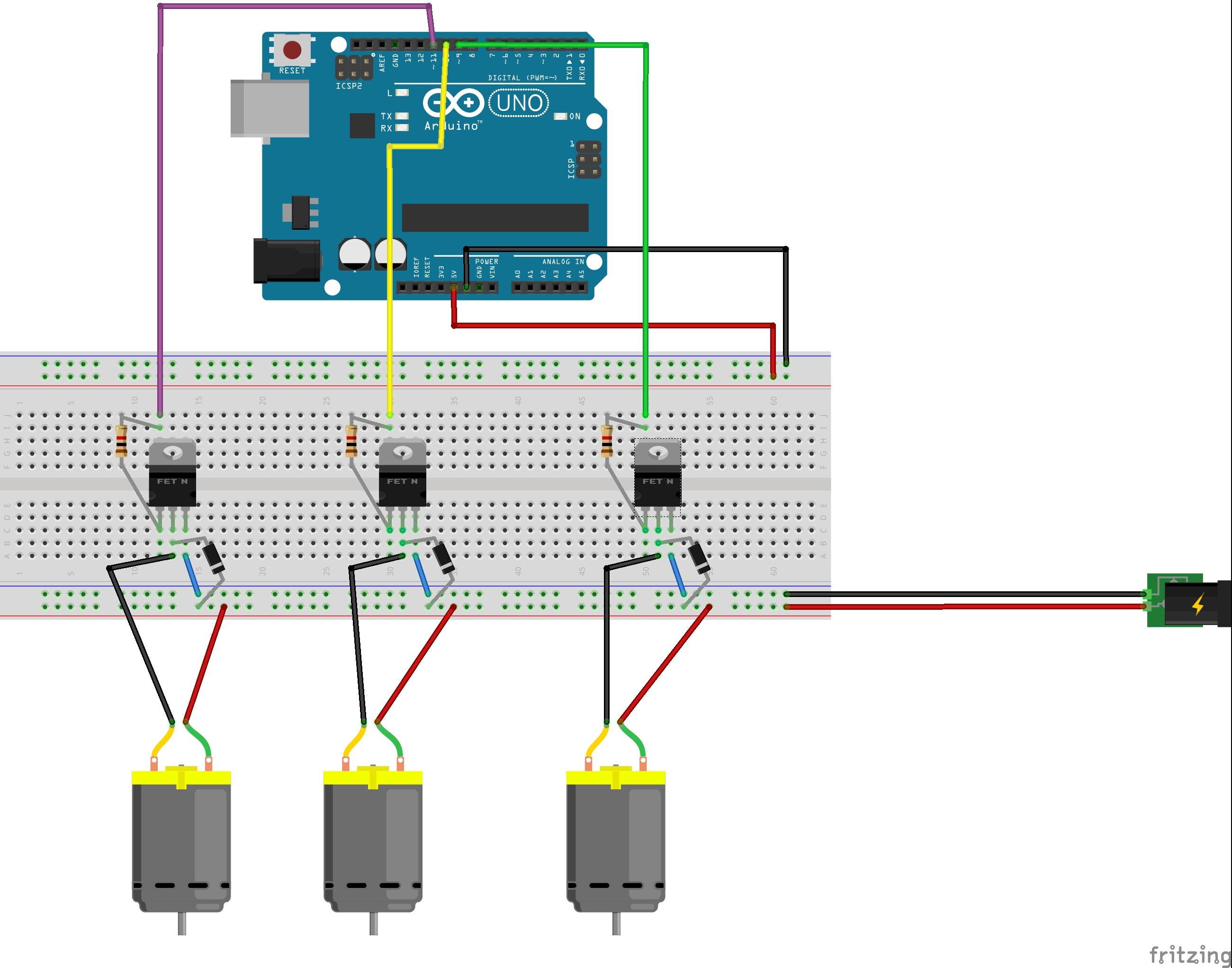

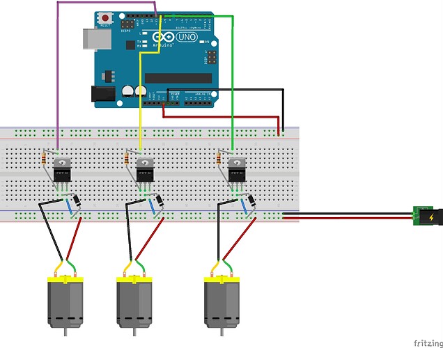

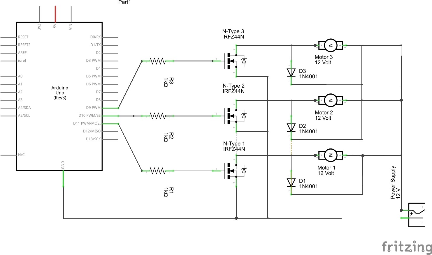

Can anyone explain to me where (and why) I should connect my 5v from the Arduino in the attached schematic (breadboard image also attached).
If I'm pulsing my transistors using pins 9, 10, and 11 why is the 5v supply pin used at all? Nothing is even hooked to the 5v power rail? Is it just convention to always connect Arduino power and ground to the breadboard?
This is likely a very elementary question... Thanks in advance for any explanation.
-Chase
+5 is not needed.
You need the Q7 circuitry that I posted.

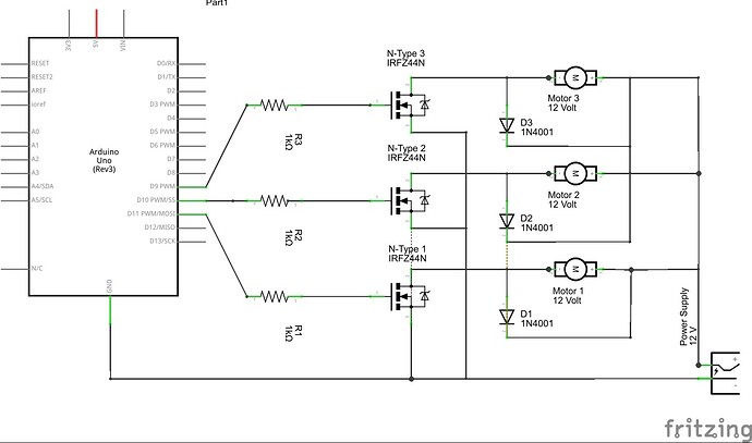

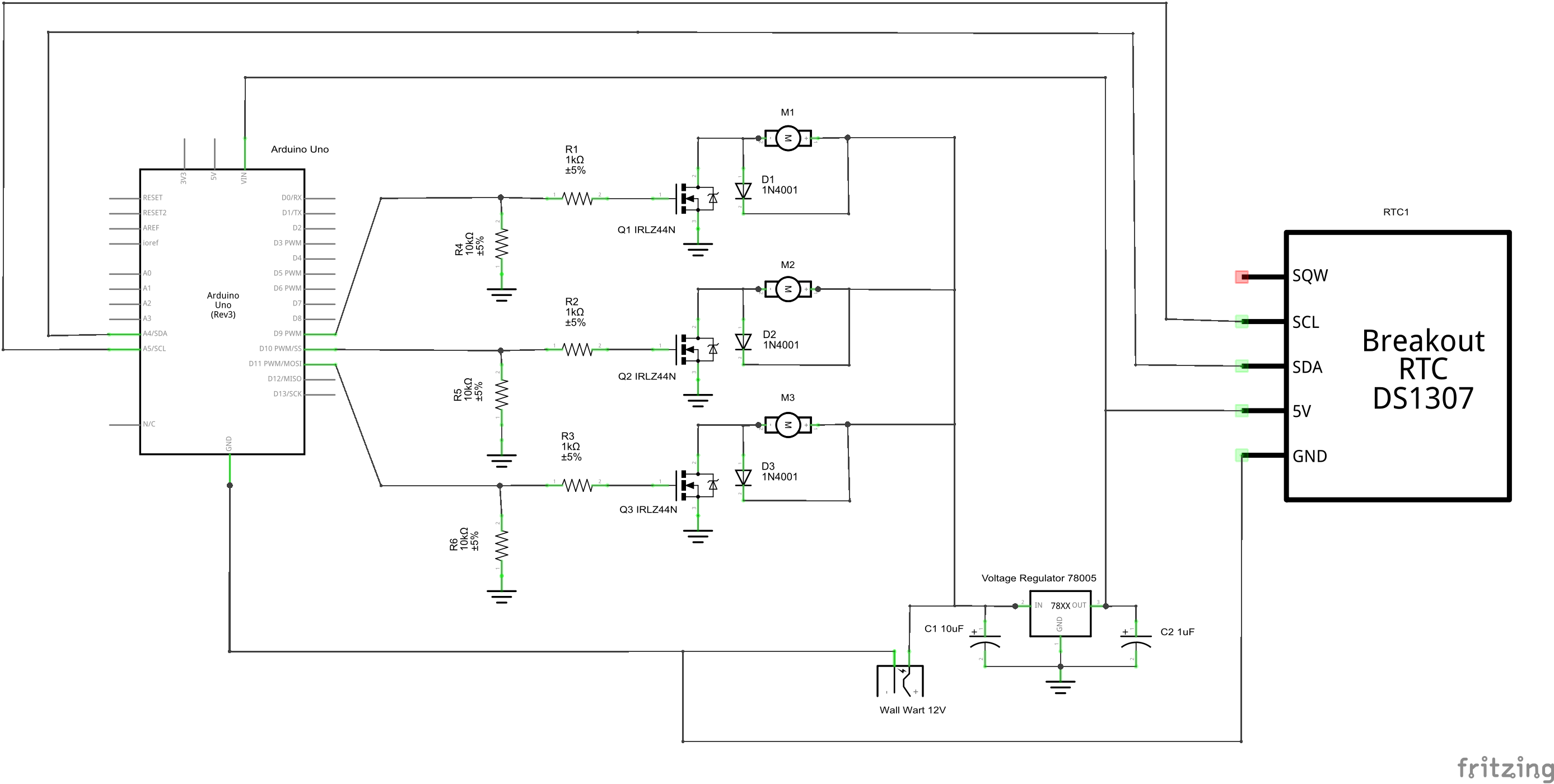

So I've updated the schematic a bit (see attached), but I'm a bit concerned about how I'm trying to supply power.
I'm planning to have an AC to DC converter plugged into a wall supplying 12 volts. Those 12 volts will be supplied to the "Source" side of each transistor (after being pulsed at the "Gate").
The 12 volts will also run to a voltage regulator which will output 5 volts. From this voltage regulator I've attached an RTC timing board and will also run this to Vin on the Arduino (hoping to power the Arduino from the same 5 volt rail).
I'm having a very difficult time visualizing what happens around my voltage regulator. In other words, if I "steal" some voltage form my initial 12 volts at the voltage regulator, then I take the 5 volt output and split that again to the RTC and the Arduino, can I still expect to have 12 volts and 5 volts where I need it respectively?
I guess I don't understand voltage very well and can't tell, with the way I've drawn the schematic, if my components are in series or parallel?
Any help in understanding or comments on how to improve is much appreciated.
-Chase

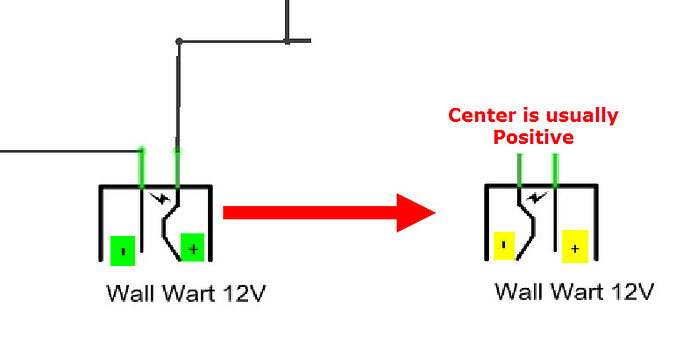

Vin should be 7.5 to 9 volts, but I would go in from the power jack.
However, you could feed your 5v regulator output to the 5v pin on the Arduino.
R1-3 should be ~ 220 ohms.
Edit
The RTC can be powered from +5 from the Arduino.
I would use a DS3231 based RTC, much much more accurate.
It is nice some times to have a power led, maybe flash it at 1hz rate.

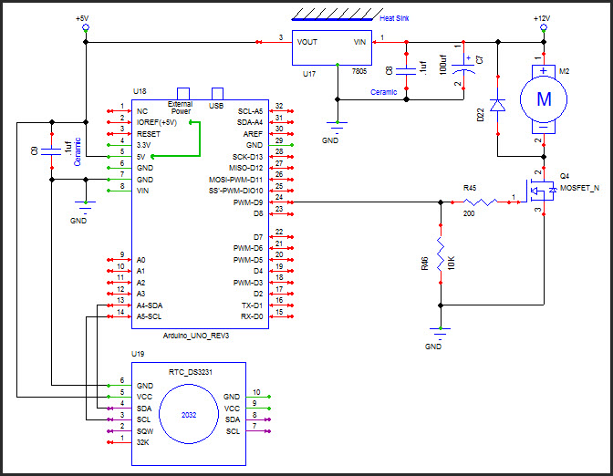

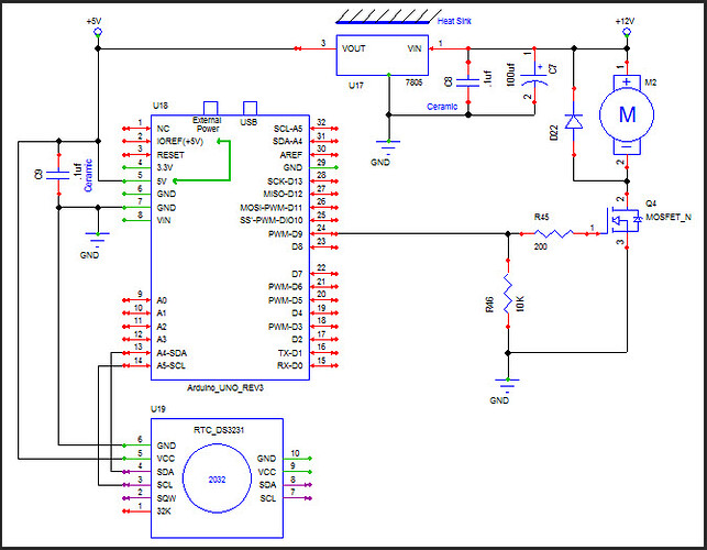

In your case I would recommend you wire things up this way:
Note:
The input resistance to a FET is infinite.
It does have capacitance, gate to GND, see data sheet.
R45 is there to protect the Arduino output.
i.e. it limits the output current to a safe level while the FET input capacitance charges.
Ceramic capacitors are used for noise/de-coupling purposes.
Finally, why on earth do none of the schematic diagrams for the Arduino include a connection for the barrel jack to power the darn thing? Am I missing something?
Designers assume you know things have to be powered. :wink:
