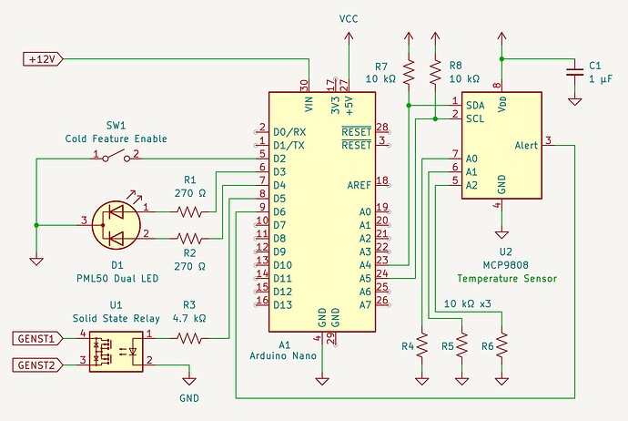

Greetings from Wonderful Wyoming. As a newbie I'm hoping a few Obi Wan Arduino types might weigh in on my first-ever Nano project.
It gets pretty cold up here, so if the temperature gets below say, 25º F, I want my Generac generator to start automatically, run for a few minutes, then shut off for an hour or so (the generator is factory set to start if wires GENST1 and GENST2 are connected).
The idea is to use a Nano with a single switch input to enable the cold weather feature. A dual LED will indicate system status (feature enabled, enabling recommended, error(s), etc). A MCP9808 Temp Sensor IC reports temperature to the Nano via I2C.
Any thoughts on this schematic would be much appreciated - from layout to functionality or otherwise. But go easy on me, folks - it's my first time using both KiCAD and Arduino!
Thanks in advance.
sounds like you short the GENST1 and GENST2 connections - any idea what voltage may be on these connections?
possibly a relay would be a solution
make sure you build hysteresis into the on/off control algorithm otherwise it may be switching continuously
You did good, it is hard to believe this is your first attempt. The only thing I would change is R7 and R8 to 4.7K but with it on one PCB it should work OK as you have it.

Thanks for the prompt and thoughtful replies. I should have mentioned a few things that may or may not affect the design:
• Generac describes GENST1 and GENST2 as "dry contacts." Apparently, simply touching these two wires together will cause the generator to start, and the generator stops when they are disconnected.
• This PCB will be enclosed in a junction box (i.e. out of the weather) but it will be outdoors. I'm hoping the Arduino's temperature rating of "-40°C to 85°C" is sufficient for most conditions I'd encounter up here in the Cowboy State.
• The MCP9808 sensor has a programmable temperature alert output pin which I may or may not use. The data sheet describes this as an open-drain output that requires a pull-up resistor. Is it safe to assume I could use the Arduino's internal D6 pull-up - or would it need an external pull-up as with SDA and SDL?
• Finally, I'm planning to source about 19 mA each to those two LEDs on D3 & D4. Hopefully that will be enough for bright indicator lights. Any experiences in that regard would be welcome.

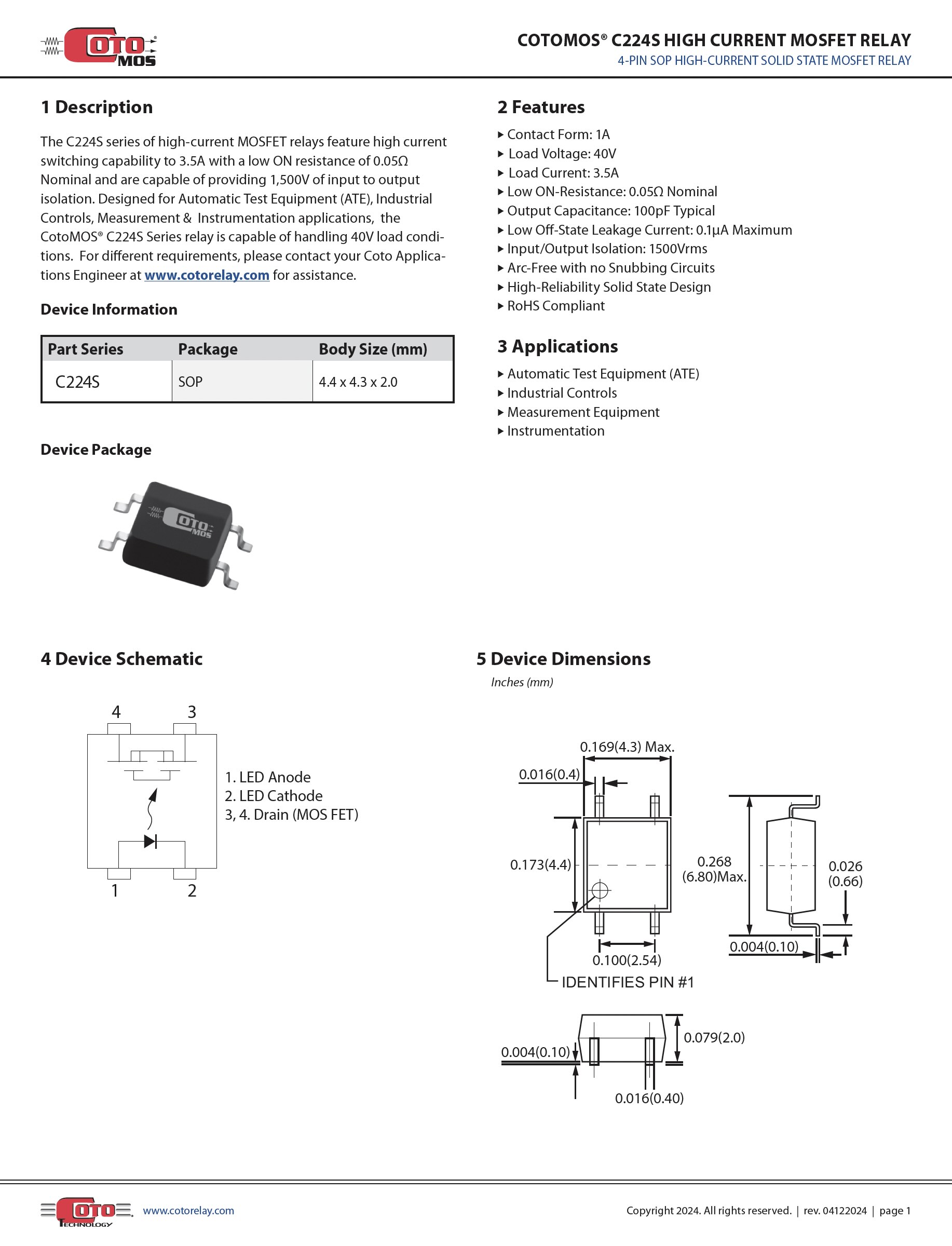

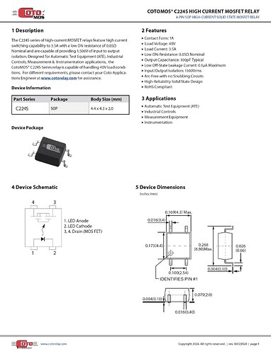

So would it be safe to say the C224S Solid State Relay is OK to use as long as the GENST1 and GENST2 voltage is below the relay's 40VDC Load Voltage? Spec sheet attached:
I'd be surprised if that's not OK, but you need to check.

Yes, I'd like to use an ordinary +5v relay, but the little buggers typically take around 70 mA in current draw for the coil. I understand Arduino pins don't like to sink/source much more than 20 mA. That's what makes the Solid State Relay so attractive - only 1 mA - which is easily supplied by Pin D5.
To solve that problem, drive your favorite relay with a transistor. For example, see the figure in the upper lefthand corner of post #2 here by @LarryD (your relay would be where the motor is shown): Arduino with N channel mosfet and PNP transistor - Other Hardware / General Electronics - Arduino Forum
Or you could buy a more elaborate off-the-shelf relay board, such as one of Adafruit's: Adafruit Non-Latching Mini Relay FeatherWing : ID 2895 : Adafruit Industries, Unique & fun DIY electronics and kits There are similar boards available from other vendors that are considerably less expensive. Caveat emptor.
I highly recommend you determine if the two leads are actually switching DC or is it AC. That will have a difference on a solid state relay. The safest until you know for sure is to use a mechanical relay module. You can check with the manufacturer to be sure.
Thanks, Dave. This is a good idea and a relay would be my first choice. Check out this slick new unit from Adafruit.
My challenge here, which I should have mentioned earlier, is I'm limited to 100 mA. This allows me to use the +12VDC output from my control box without having to build a separate power supply. Two LEDs at 20 mA each, a 50 mA relay coil, and the Ardunio current is pushing that 100 mA limit. This is why the Solid State Relay (SSR) seems so attractive.
As others have suggested, I can prototype the circuit and try it in the field once I determine the GENST1 and GENST2 voltages and if they're compatible with this SSR.
Many thanks for the input!
Thats the Max current for most Leds , you will be surprised to see how bright a Led is on 10mA or even less.
Small relays draw far less then 50mA.
