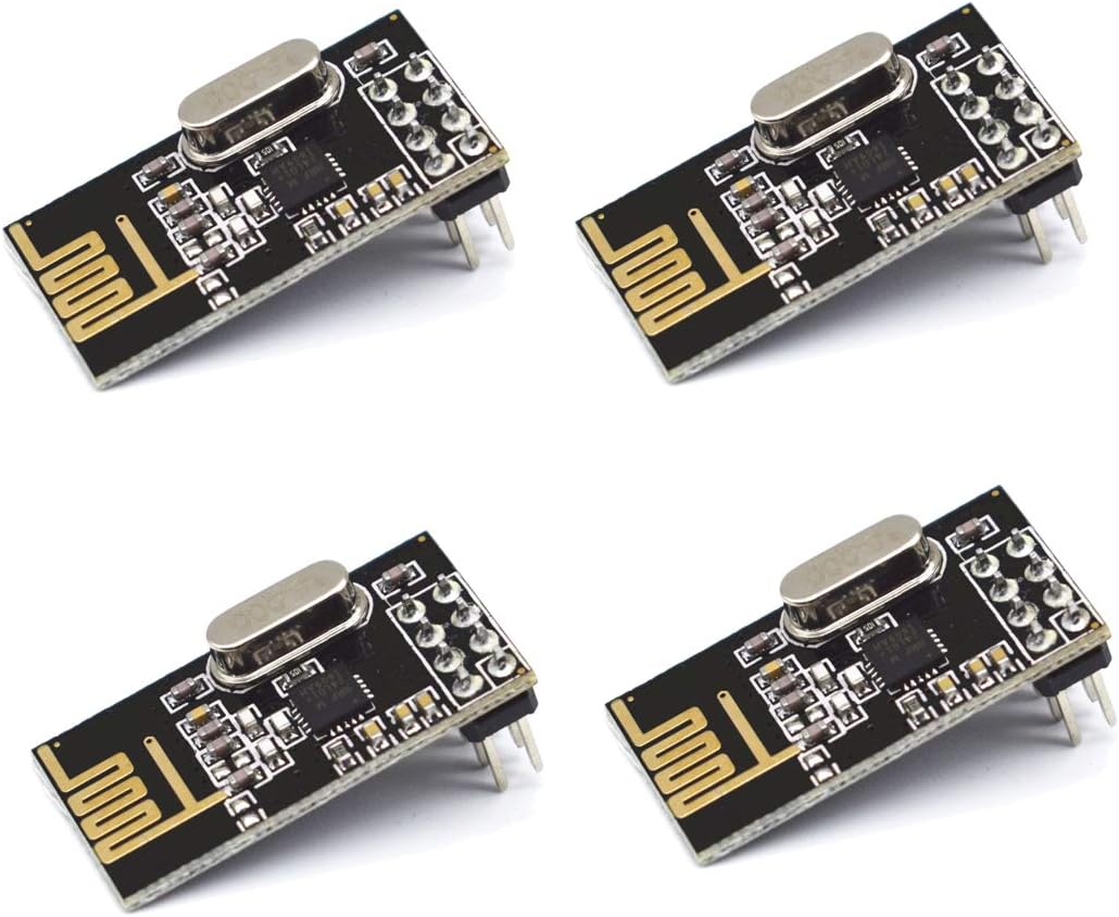

a NRF24L01 for wireless,

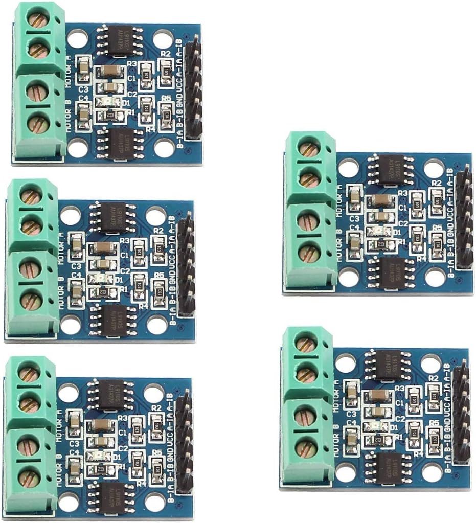

and a L9110S for driving the motor

Also, would one of these work to drive the motor rather than the L293D?

the NRF24L01 is this one
And the L9110S is the one I sent in the first post.
