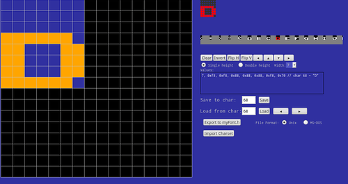

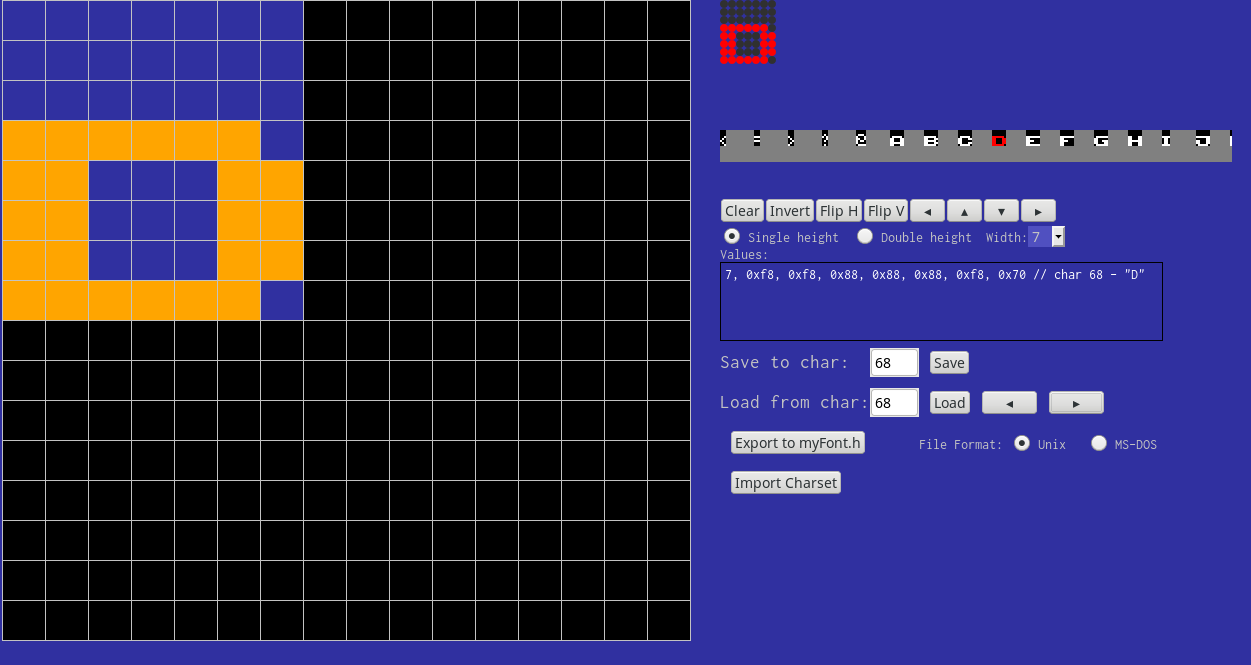

I'm working on a simple font designer to produce char sets to use with Max72xx and Parola libraries.
While it doesn't do nothing that you can't do with the 'official' font designer, it is a solution for the ones that don't use MS Office.
It is still a work in progress and with at least one pesky bug (double height chars do not show up on the stripe) but I'd like to have some feedback from someone that does use Parola.

Yes, I noticed that but I need to have a better idea of how the char will look on the matrix.

I'd like to compliment you about the font format, storing the column values instead of row values is quite clever.
