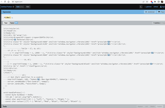

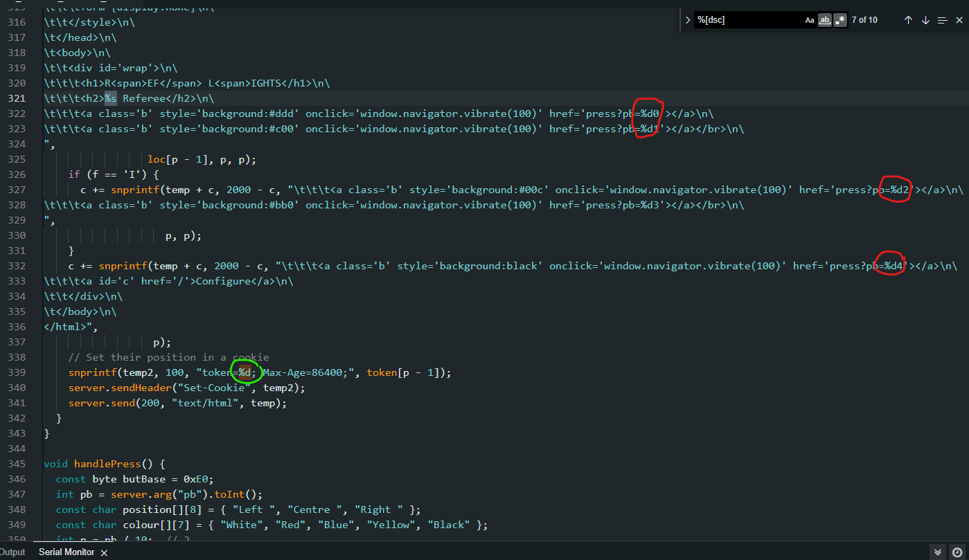

Related to my original problem, I tried using the RegEx option in the Find/Replace feature to locate all instances of %d, %s and %c. in a sketch. The expression %[dsc] does find some of them but, sadly, not all of them. I can provide screenshots comparing a chunk of text in the Arduino editor with what the tool at regexr.com finds in the same text using the same regular expression. It finds all of them. I can provide screenshots of the comparison if anyone is interested in following up on this.

I'd be happy to take a look.
IDE finds the instance of %d circled in green but not the ones circled in red.
Same regex on the same text in regexr.com finds all of them.
Edit: Looks like it found one more that I missed - which drives home the point about how difficult it is to not have these highlighted in the default theme.
Thanks. Would you mind pasting a snippet of your sketch code that produces the bug? That will allow me to proceed with the investigation without having to transcribe the text from your screenshot.
I've made a few changes to this sketch (and brought back my helpful theme) since I posted the screenshots, but the snippet below is unchanged, except token in the Set-Cookie data has been renamed pkey and token[p - 1] is now pKey[p]. The weird thing is that the search for regular expression %[dsc] now highlights and finds all four %d in the snippet. I'm not sure what's going on here but I wouldn't have trusted myself if I didn't have the screenshot as evidence that, a few hours ago, it definitely missed out the %d in pb=%d2, pb=%d3 and pb=%d4 but a few lines later found token=%d; (Highlighting's a bit hard to see but the ones it did find were highlighted with a brown background.)
