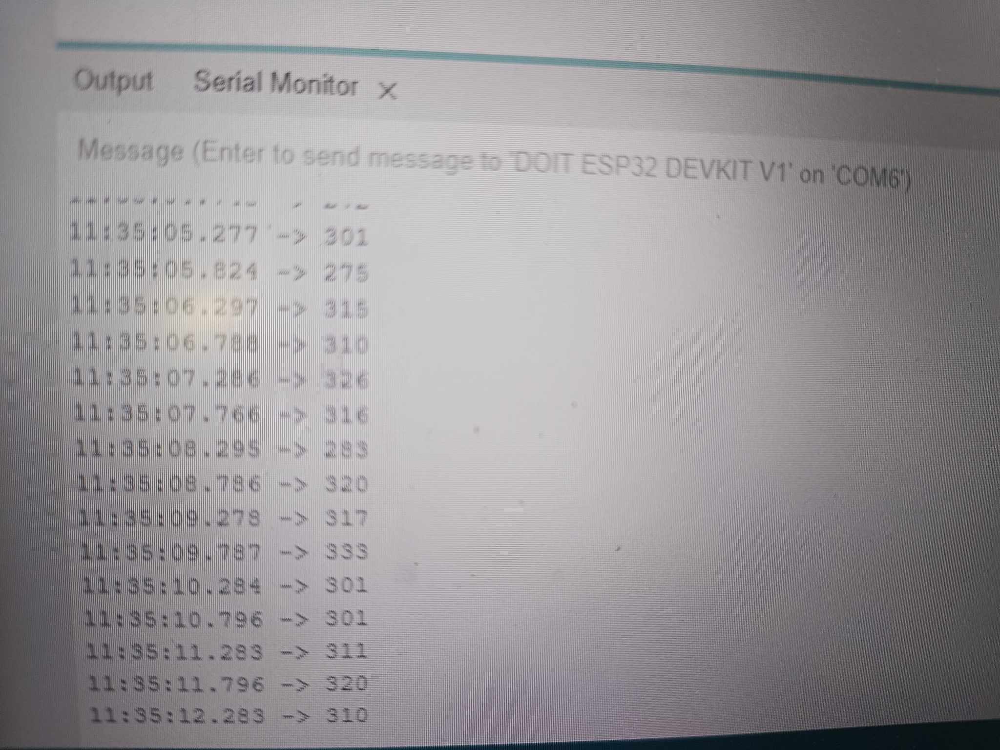

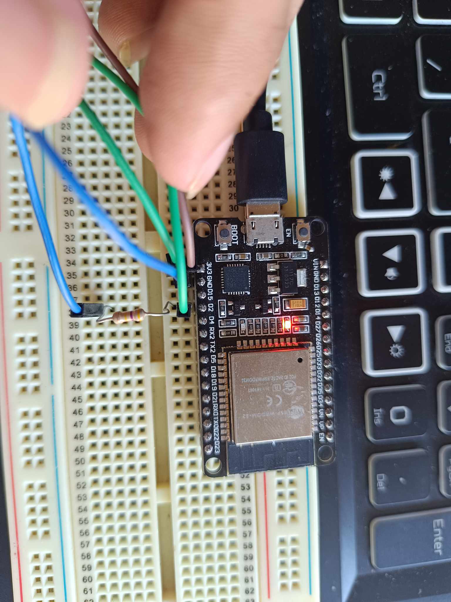

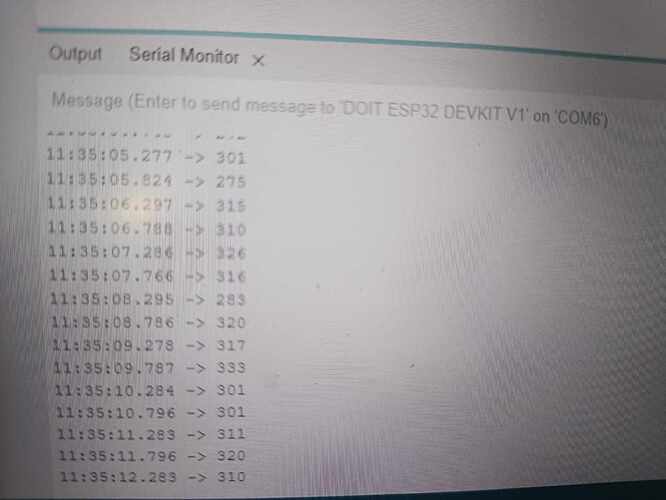

I just gave it go and the value when reading the analog when pressed doesn't changed. I connected the 3.3v to pin 14 and pin 6 of the Film foot pressure sensor. the circuit is resistive voltage divider, the same how they implement the circuit for fsr. Im using esp32 by the way. Thank you

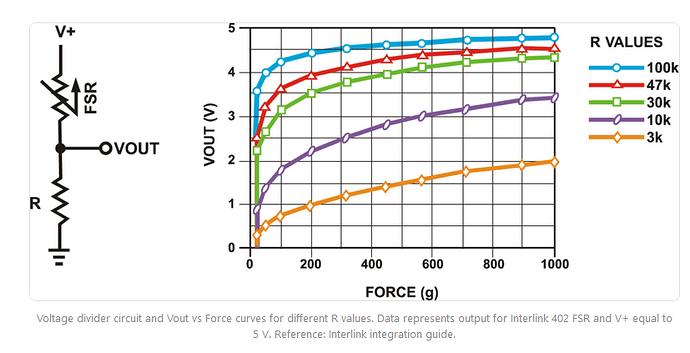

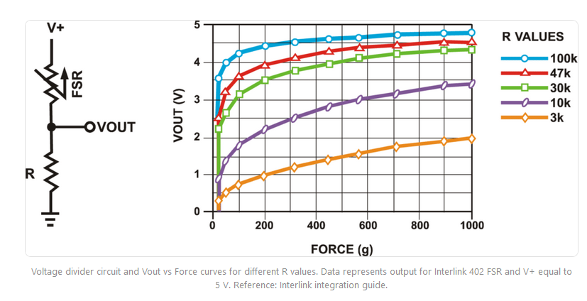

Sorry, what you posted does not make sense to me. Here is the basic idea of an FSR voltage divider, Vout goes to the ESP32 ADC input (V+ must be less than or equal to 3.3V).
From Force Sensing Resistor (FSR) Arduino Tutorial (3 Examples)
