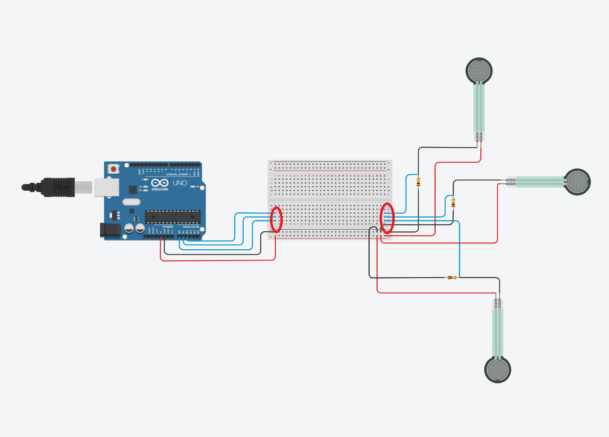

FSR Sensor output not responding to Pressure Applied
I am trying to create a circuit and code that will read multiple pressure sensors and display the value in the serial monitor. Whenever a force is applied the value doesn't change from 0 and I am unsure what I am doing wrong.

Your problem is here.
On the breadboard the columns are shorted. so use one column for each analog pin and for each FSR sensor.
Do like this:
