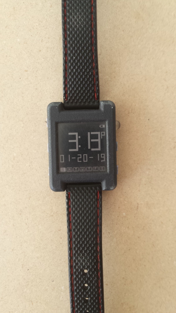

For the 2.0, I decided what I wanted to keep, and what I wanted to change. I refined my goals and realized that I wanted a smart wrist watch, not a smart watch. I don't need bluetooth, accelerometer, ect. My ideal watch would be simple to assemble, as small as possible, and with adequate features to be as useful as possible. If a single CR2032 coin cell could power the watch for many weeks, then that eliminates the bulky li-ion cell, charger, voltage regulator, usb port, hassle of charging, ect. This simplifies construction and reduces final size. If I can utilize a Sharp memory display, then that solves the OLED problems (power consumption, daylight readability). If I could plan the case better, then it would be an integrated part of the entire watch, and assembly would be easier.
I began anew, carefully choosing components to minimize size and power consumption while retaining final product usability.
• Display: Sharp 128x128 memory mono display with the FPC ribbon connector. One challenge is that it needs a constant 1hz square wave on the EXTCOMIN pin for the LCD bias. (4uA standby current.)
• MCU: AtMega 1284 for its 128K program space and 16K SRAM. Lots of space for custom fonts, functions, ect. (0.1 uA sleep current.)
• RTC: NXP PCF85263A. 0.28uA current, and has 2 interrupt generators. One is dedicated to toggling the EXCOMIN pin on the LCD without intervention of the MCU.
• Temp Sensor: BMP280 (not the BME280). Temp and pressure sensors. (0.1uA sleep mode.)
• I also have a magnetic buzzer for alarms, and backup battery for the RTC (don't have to re-set the time if the battery dies or you reprogram the watch).

The total power consumption in standby should be about 4.5uA (which is achievable in real life). The power to refresh the display every minute is about 5ma for 19ms. Using a 210mAh coin cell, it should theoretically run for more than 3 years.
There were many other challenges, such as moisture entering the watch (either from sweat or rain) and the power consumption increasing dramatically (up to 1ma in standby!). This was always hard to trouble shoot. Another major challenge was that the Sharp display had no backlight, and I wanted to use see watch at night. But that solution is a topic for another day...

The final 2.0 GadgetWatch case is 44.3 x 33.5 x 10.9 mm. Total width is 36.9mm. It has a stopwatch, calendar, sun rise and sunset calculations (and other almanac data), temp and pressure sensors, altimeter, countdown timer, IR remote, and several watch faces. It has been my daily timepiece for 2 years now, and most people are surprised to hear that I designed and built it (if they even notice - I didn't want a watch that looked home made!) I hope that someone can be inspired by this project. I am not taking orders. I am not selling kits or plans. I don't plan to release the sketch or the circuit diagram at this point, mainly because I cannot provide support for anyone who will attempt to build one. The cost of the parts is about $115, but the R&D is about $300 for parts and 600-800 hours of design, programming, troubleshooting and assembly. The final version probably took another 100 hours of troubleshooting and programming. These are just estimates because as a hobby, I don't keep a record of my investments. All said, it was a very good learning experience, and I learned much about power management, circuit design, product design, efficient programming, and many other skills.
