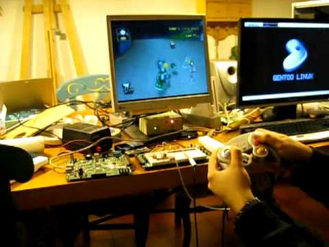

I would like to know where to start in programming video game converters. My idea is to take the data sent from the serial data controller, decode it, rearrange it, and the output it to the system. I would like to start with a gamecube to wii classic controller converter, the gamecube controller is a lot easier to hold in my hands than the classic controller and you can only play some games with the wii classic controller. I would like to know where to start with the code. Thanks in advance!
This is what i would like to make bust with an arduino uno. I have see the controllers inter faced with the arduino, but not the arduino to the system, and if I had there isn't code available for me to look at.
