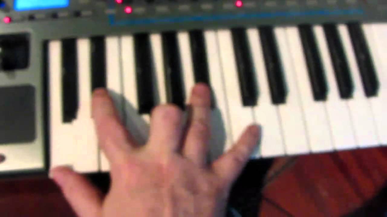

Gameduino polyphonic organ.
I got a gameduino yesterday, and though i would test out the synth engine.
8 voice polyphonic, and each voice can have 8 partials “organ stops” (they are fixed at the moment, ill add some potentiometers to change the sound)
you will need a MIDI input, or change it to receive MIDI from your computer via USB (dont ask how to do that, but i know you can)
//Gameduino has DC on the output. you should put a capacitor on the outputs if your monitoring system is DC coupled.
//Polyphonic gameduino organ 0.00000001
//june 2011 J.Matheson [DeFex][Neutron7]
