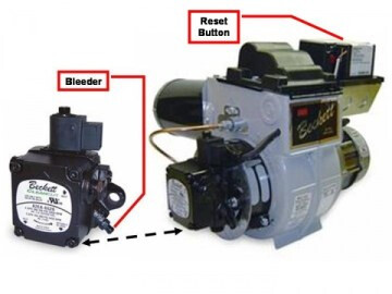

Do "gas boilers", or gas-powered boilers, have a reset button? This would be a pushbutton, I guess, where a unit that has tripped and re-starts by pushing the button. (Not the same as a pilot re-light intervention.)
I think such a thing is only placed on an electric unit (as a 'circuit breaker').
This is an image from a tutorial on how to reset a Remeha Avanta:
I found it here. The relevant text roughly translates to: "To reset the device, press and hold the "R" button for three seconds."
What is that?
Yup, when the chamber gets too much pressure, when the sensor shows low fuel pressure, when the air intake is retarded, when the pump makes on the alarm wire, when the ignition fails, when you've run out of fuel and need to bleed the system.

All modern gas boilers have a reset.
What happens if you reset the boiler is that the boiler goes through a series of checks. This simply is.
Firstly the system checks the water pump has come on and the water flow switch has closed. If there is no water flow the boiler locks out.
Secondly the boiler will start the fan and pull fresh air inyo the system purging any remaining gas out of the system. Possible fault the air flow switch does not close or the fan does not operate.
Thirdly if no fault is detected the boiler will then open the gas valve, wait a couple of seconds and then the igniter will operate and fire the boiler up, if no flame is detected the boiler locks out.
Everytime you reset the boiler it will follow the above sequence, locking out on any failure, thus it has different fault codes for different failures.
Making an automated reset will never clear the problem part.

When this all happens and the gas or oil is not ignighted, what do you think happens to it?
What happens if you reset it over and over, with no time between?
And what happens if your ignition source is intermittent?
What happens if a person or a child is standing next to the boiler and pressing reset repeatedly? I would imagine user controls have some sort of fool proof otherwise they wouldn’t pass certification

If you really want to do this, the boiler circuit normally only allows a reset in lockout, you would need to create a way of telling when the boiler circuit was in lockout.
But creating an automatic reset would cost you money if the boiler does not fire up, you would be running a pump, a fan and if it is an ignition problem you would be releasing some unburt gas into the atmosphere everytime without heating any water.
Some boilers do have a three try reset circuitry after failure before they finally lock out, however when they do lockout you need a manual reset.
This three try option would be the circuitry to change to indefinate tries to reignite the boiler, if you wanted to waste money though thats the way to go, believe me it's cheaper to get the boiler repair man round in the long term.
