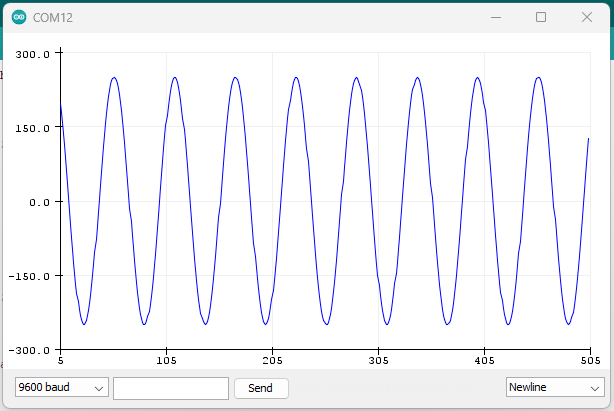

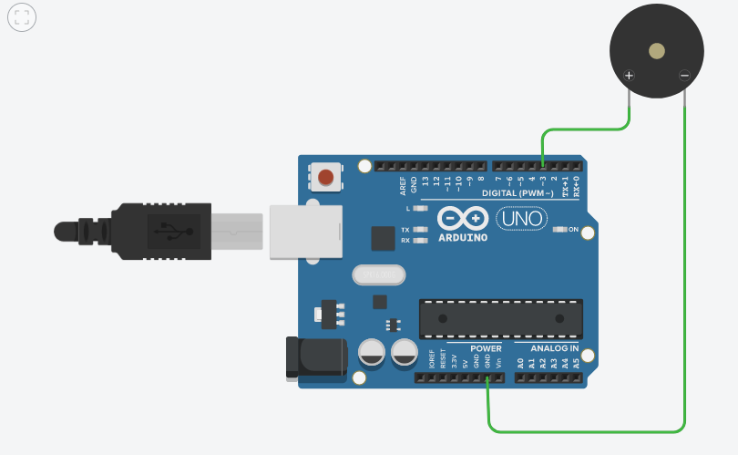

Hi. I'm trying to apply the topics of physics to Arduino. As part of it, I've tried to apply the General Wave Equation using an Arduino Nano and a buzzer.

//Where the buzzer is connected.
int PWM = 3;

//WAVE CREATION.
wave = intensity * cos((k * x) + (omega * time) + phi);
//Plot the wave value.
Serial.println(wave);

There are three major problems with your approach. The first is that you are printing values in the loop, using an extremely low serial Baud rate of 9600, and that takes 1 millisecond to print each and every character.
The second is for the audio to match the tone frequency, the signal amplitudes have to be output at time intervals that match the audio waveform sample rate. That won't work if you are printing, and the loop timing interval needs to take into account the time required to calculate cosine and do other math.
The third is that a buzzer is not a speaker. To generate clean sine/cosine tones, you need an audio amplifier (with capacitive coupling, a low pass filter to remove the PWM noise, and a volume control) and a speaker with a separate power supply.

Sometimes a piezo transducer (speaker) is mis-named as a "buzzer". A transducer will work with tone() to generate different frequencies and that's a quick way to check what you have.
Note that piezo speakers/transducers are "tweeters" and they don't reproduce low (bass) frequencies.
