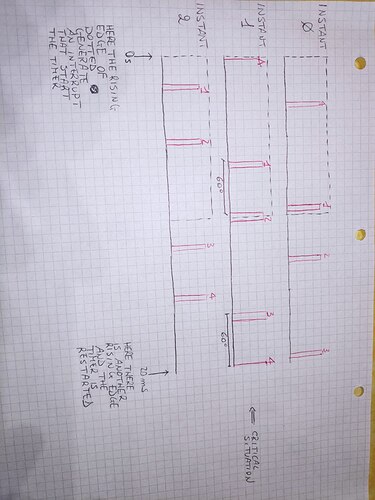

Hello everyone. I'm reaserching for a solution to generate pulse with TIMER of a MEGA2560.
In order to explain better what i want you can see the image below.
I have the dotted line that is a square wave that I have in an input and each time I have the rising edge there is an interrupt in which I impose TCNT1 = 0 and the OCR1A. The pulses can move thanks a variable Beta that is the value of a potentiometer in an analog input.
Every pulse has a duration of 500us and there is a rising edge each 20ms.
In the image you can see the starting condition and the final one.
Now the question is: How can I manage the pulse number 4 in order to shift it expecially when the pulse is superimposed on the rising edge of the dotted line?
Ps: sorry for the bad quality of the photo
I hope that my question is clear. If not I will give you more informations.
Thanks
This should be pretty straight-forward for the Mega since it has all the timers you need.
You would need three timers if you need the two pulses independent.
Here's the basic logic I think
  • Your external interrupt starts Timer1
  • Timer1 counts from 0 to some value that corresponds to the 20 ms timeout (or the TOP value of Timer 1)
  • You enable the 2 compare interrupts (COMPB and COMPC) of Timer1
  • As Timer1 TCNT1 matches COMPB, you start Timer2
  • Timer2 is just a basic timer that counts from 0 to some value that corresponds to 500 us
  • You enable OVF interrupt for Timer2 so that you use that to STOP Timer2 itself
  • As Timer1 TCNT1 matches COMPC, you start Timer3
  • Timer3 is just a basic timer that counts from 0 to some value that corresponds to 500 us
  • You enable OVF interrupt for Timer3 so that you use that to STOP Timer3 itself
  • Rinse and repeat
The value of COMPB and COMPC determines when those 2 pulses happen within the 20ms time frame

Back to the drawing you provided, I see four short pulses (1, 2, 3 and 4). I assume these are the 500 usec pulses you talk about. You also have the a timeline from 0 to 20 ms so my guess is all the four pulses fall within this time frame.
So my question is, are pulses 1,2,3,4 ever going to collide with each other or they are always some distance/time from each other (doesn't matter the sequence, you can fix that in software)? This will determine whether you need four independent timers or you can get away with a single timer...
You can see the pulses in couple. In particular one couple is formed by 1 and 2 and the second by 3 and 4.
The distance between 1 and 2 must be 3,33 ms.
The distance between 3 and 4 must be 3,33 ms.
The distance between 2 and 3 must be 6.66ms
So in short the pulse must have always this distance from each other
Everything is doable then with a single 16-bit timer. You can use CTC mode with TOP OCRA. You then use the COMPB and COMPC interrupts to generate the rising and falling edge of your 500 usec pulses.
COMPB interrupt for the rising edge, and COMPC for the falling edge. Also during COMPC ISR, you then set the next value of COMPB and COMPC, and so on.
But, when the pulse number 4 is superimposed the rising edge of the dotted line i have problem, because the timer will reset.
The pulses can move backwards and the pulse number 4 in the only one that pass from 0second to 20ms (taking in account the time line in the image)
Your drawing shows pulses within the 0 to 20ms line. Or the 20ms only covers the dotted area? In that case, you should change the drawing to show that clearly
I redraw the scheme. Hope that this is more clear
In this case you can find the critical situation that is the one that i want to manage

One way to do it: not use the timer to set the output directly, but to trigger an interrupt when it reaches the compare value. In the interrupt routine you set the pin high for the required time and do the "bookkeeping".
Keep a status register:
  • 0: all pulses done,
  • 1: before pulse 1
  • 2: before pulse 2
  • 3: before pulse 3
  • 4: before pulse 4
  • 5: before late pulse 4, when the next trigger has already arrived.
    and a TMP register that stores the timer value for pulse 1 in case of a late pulse 4
The external interrupt routine:
  • if status 0: start the timer, set OCR2A = "beta" (the timer value that corresponds to time period beta), set status=1
  • if status 4: set TMP= "Beta" minus the remaining time on the timer ( OCR2A- TCNT2), that gives you the time between late pulse 4 and the next pulse 1), set status=5
The timer interrupt routine:
set the pin high for 500us (you can do it in assembler and add the necessary NOP instructions to get 500 usec), and
  • if status 1, set OCR2A for 3.33 ms, set status =2
  • if status 2, set OCR2A for 6.66 ms, set status = 3
  • if status = 4, set status = 0
  • if status = 5, set OCR2A = TMP, set status = 1.
My idea for this would be something like this
ISR(TIMER3_COMPA_vect)
	// end of 20ms cycle, set OCR3B and OCR3C with new values for the next pulse
	OCR3B = 6000;
	OCR3C = 6000 + 1000;
ISR(TIMER3_COMPB_vect)
	// set output HIGH
ISR(TIMER3_COMPC_vect)
	// set output LOW
	// configure OCR3B and OCR3C with new values for the next pulse
	OCR3B = 12000;
	OCR3C = 12000 + 1000;
	// ... and so on
void setup_master_timer(void)
	set up TIM3
	CTC with TOP at OCR3A
	TIMER3
	TCCR3A = 0<<WGM31 | 0<<WGM30;
	TCCR3B = 0<<WGM33 | 1<<WGM32;
	// 50Hz at 2MHz counter (16MHz DIV8)
	OCR3A = 40000 - 1;
	// enable all output compare interrupts
	TIMSK3 = 1<<OCIE3C | 1<<OCIE3B | 1<<OCIE3A;
	// assuming pulse1 starts 3ms from rising edge, generate 500usec pulse
	OCR3B = 6000;
	TCNT3 = 0;
	// start TIM3 at 2MHz (DIV8)
	TCCR3B = 0<<WGM33 | 1<<WGM32 | 0<<CS32 | 1<<CS31 | 0<<CS30;
You use the CTC feature to change the values of OCR3B and OCR3C to point to the next pulse. Since you only require a 500 usec pulse, the distance between OCR3B and OCR3C interrupt is constant. In my example, running the TIM3 at 2MHz (16MHz pre-scaled to 8), OCR3C is always 1000 clocks after OCR3B. You modify these values in the OCR3C ISR. You basically re-triggering OCR3B and OCR3C multiple times within the 20ms period.
The system Is 3 phase and the pulses control a 3 phase rectifier SCR. The dotted line in figure is a square wave (basically the sine wave transformed in square)
And yes, the synch is very important

Is this any help?
 * 16-bit counter
 *  @2MHz overflow occurs at 32.768mS intervals
 *      prescaler = /8
 * From time of input capture the output compares will
 * be enabled. Their COM pins will be set to trigger at
 * ICR5 + offset + OC specific output
 *  offset is potentiometer adjustment (drawing below approx.)
 *     ____________________                         ______
 *  __|                    |_______________________|
 *      base + zero adj
 *           _      _          _      _                      _
 *  ________| |____| |________| |____| |____________________|
 *           1      2          3      4                      1
 *      base + max adj
 *         _                   _      _          _      _
 *  ______| |_________________| |____| |________| |____| |_____
 *         4                   1      2          3      4
const volatile uint16_t g_cBaseOffset = 100u;    //50uS base offset from input edge to pulse 1
const uint8_t pinInput = 48;    //ICP5
const uint8_t pinAdjust = A0;   //adjustment potentiometer
const uint8_t pinOC1 = 11;      //OC1A  pulse 1
const uint8_t pinOC2 = 12;      //OC1B  pulse 2
const uint8_t pinOC3 = 13;      //OC1C  pulse 3
const uint8_t pinOC4 = 5;       //OC3A  pulse 4
const uint8_t pinTestSig = 3;   //signal output for bench testing; connect to pinInput 48 for testing

        TIMSK1 &= ~_BV(OCIE1B);
    }//else
}//ISR T1CB
ISR( TIMER1_COMPC_vect )
    if( (TCCR1A & (_BV(COM1C1) | _BV(COM1C0))) == (_BV(COM1C1) | _BV(COM1C0) ) )
        //set up the next pulse
        OCR3A = OCR1C + 6667u;
        TCCR3A |= _BV(COM3A0);
        TIMSK3 |= _BV(OCIE3A);
        //500uS wide pulse
        OCR1C = OCR1C + 1000;
        TCCR1A &= ~_BV(COM1C0);
    }//if
        //done pulse 3
        TIMSK1 &= ~_BV(OCIE1C);
    }//else
}//ISR T1CC
ISR( TIMER3_COMPA_vect )
    //similar to pulse 1
    if( (TCCR3A & (_BV(COM3A1) | _BV(COM3A0))) == (_BV(COM3A1) | _BV(COM3A0) ) )
        //we don't set up the next pulse here; instead, the input capture does it
        //for pulse 1
        //so set up pulse 4 for a 500uS width
        OCR3A = OCR3A + 1000;
        TCCR3A &= ~_BV(COM3A0);
    }//if
        //done pulse 4
        TIMSK3 &= ~_BV(OCIE3A);
    }//else
