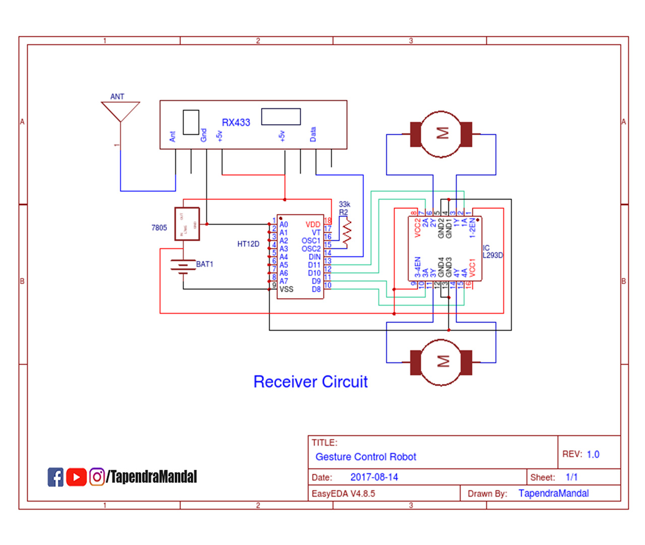

i actually made A robotic car which is controlled with gesture by using gyro.
im using ht12e ht12d ic and arduino lilypad and l293d to control 2 motors of car.
i uploaded the code successfully and more than 80% of my project is working good.
the problem is when car starts moving it is not getting stop however the serial monitor shows STOP but car is not getting stop.
after turning off button and turning on again whether i tilt my gyro left right forward backward. it start moving but is not getting stop and runs only one code but in serial monitor it shows all perfect but car is not working in that way.kindly help me
im attaching my circuit diagram
Where is the code? It will be the code that doesn't do what you think it's doing.
You talk about serial monitor showing all perfect but is that monitoring just the transmitter or is it monitoring what the car is actually receiving, which is much more important?
