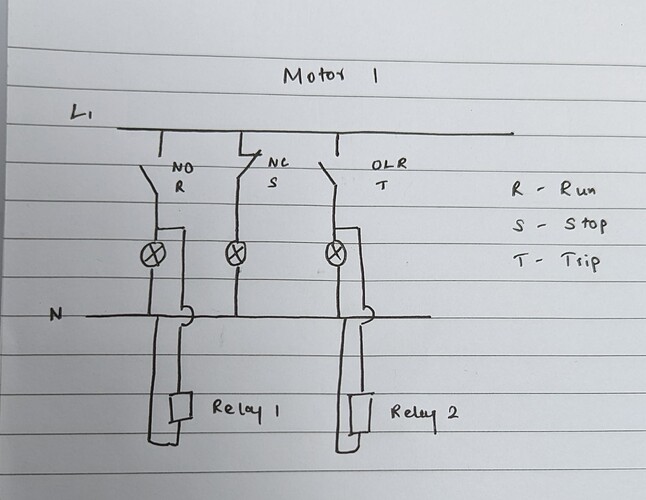

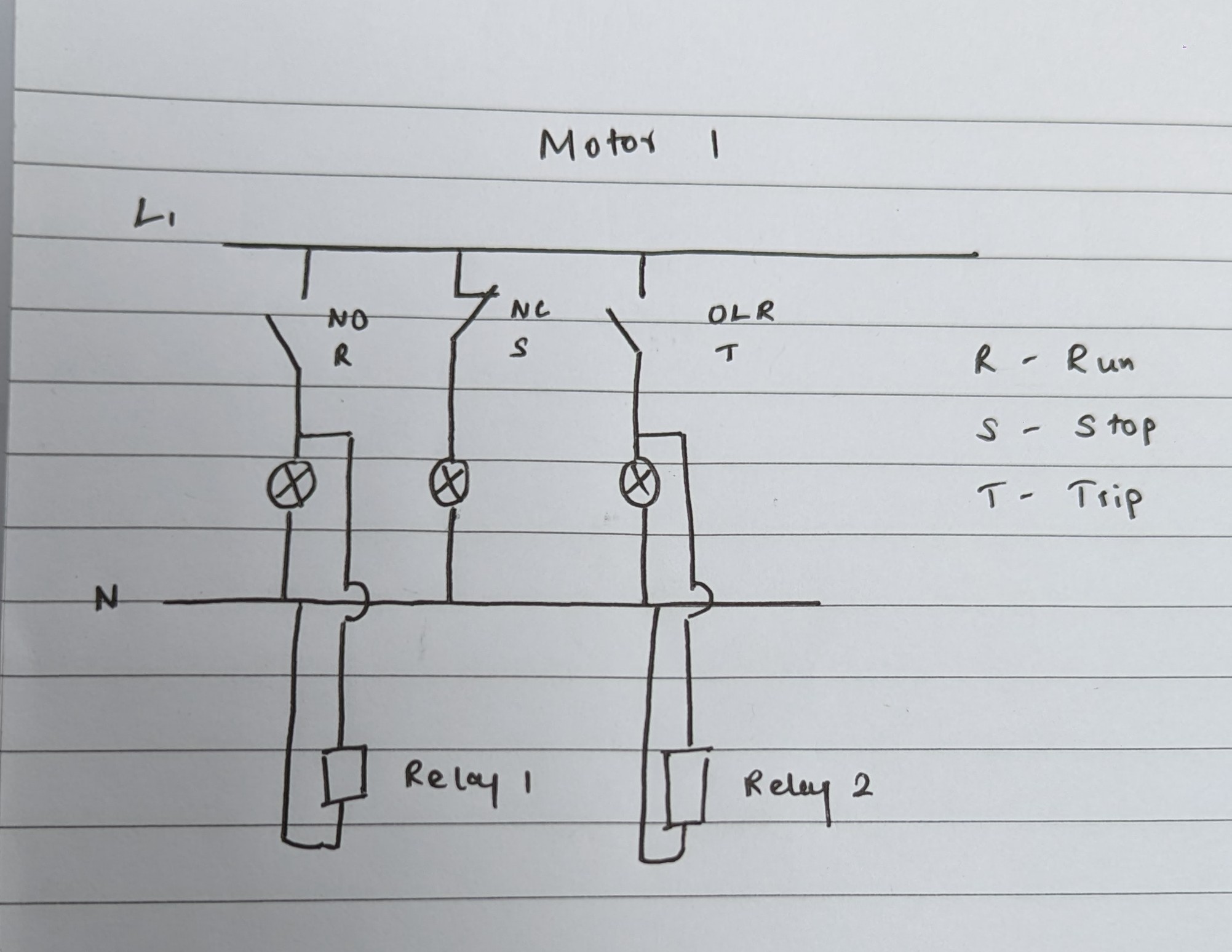

so this is just one diagram for motor 1, the same exact connection for 2 other motors. so I have taken a signal from between the contact point and the indicator to a separate relay for the RUN signal and another from the TRIP signal. for the stop signal I can code if either of those it should be stop.
if all you need is to detect if the motors are on or off could you use opto- isolators

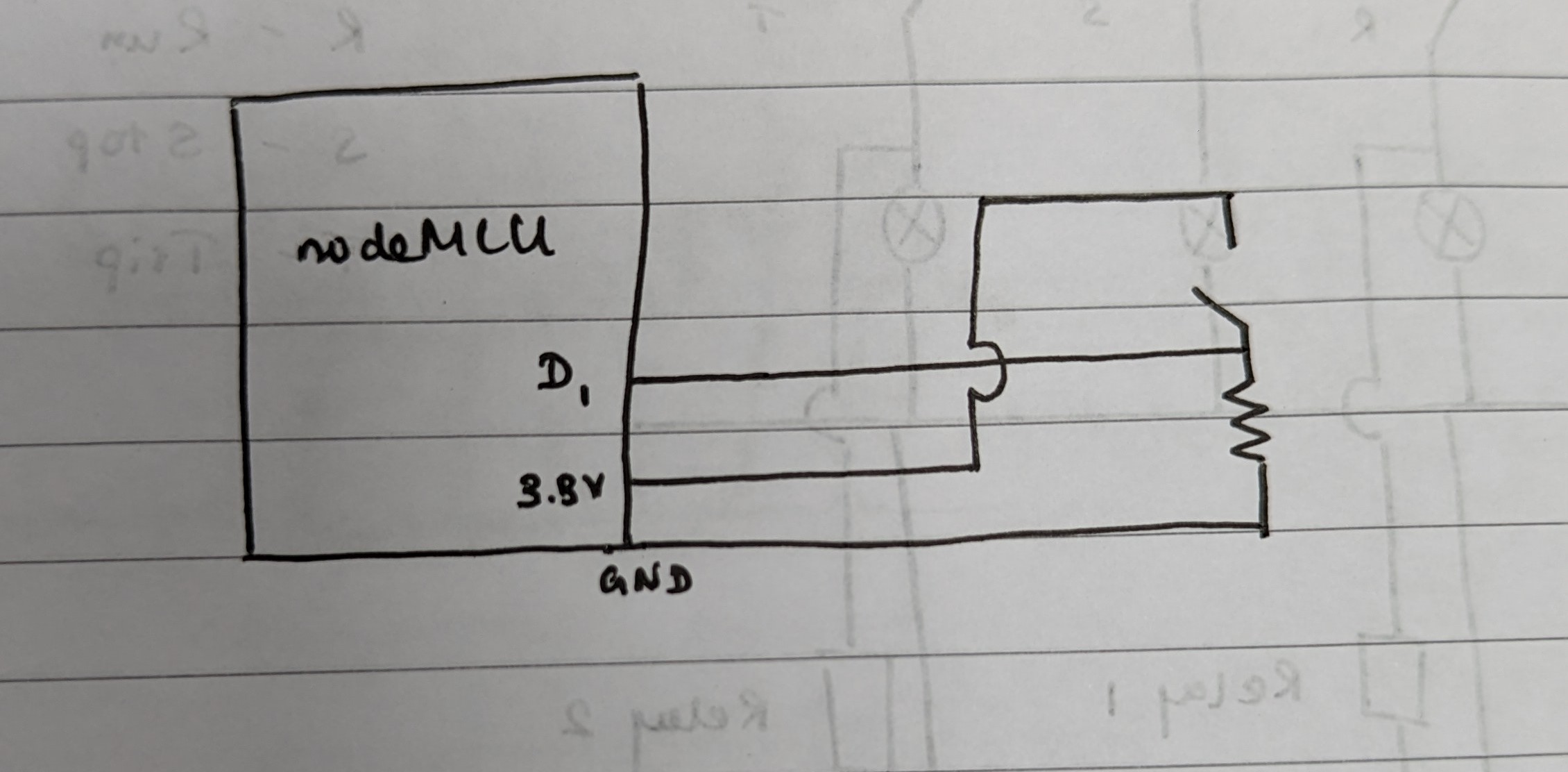

later I need to expand this system. There is a pressure sensor and a flowmeter. ill need to remotely monitor these as well. just for the start, I was thinking of the 3 motors. so this is the diagram I came up with for the relay and the nodeMCU. will you be able to help me with the code for a input signal from the relay?

Hi, does anyone know how to read if the relay is on or off in nodeMCU? the relay is outputting 3.3V

From the schematic in post #10, they do not output anything.
Which one is it ??
How about digitalRead(D1) for your software / code question.
