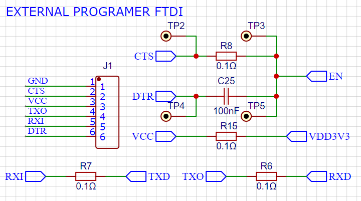

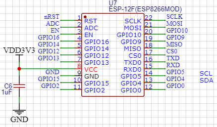

I am trying to read and show in Serial Monitor the CO2 measurements of a sensor MH-Z19C in a custom made PCB with chip ESP8266.
The RX/TX pins of the sensor are connected to the RX/TX pins of the microchip ESP8266, which makes it difficult to get the readings in the computer through the FTDI.
Some assumptions:
We cannot change the connection pins between sensor and the ESP8266
The board was working previously and the measurements were correctly read in the computer through Serial Monitor. However, the working code was lost...

Schematic of the involved part of the project

To facilitate our help, post a schematic of your project.

I updated the original post with the Schematic of the involved part of the project
In your code you define the softserial pins as D3(RX) (GPIO 0) and D1 (TX)(GPIO5).
#define RX_PIN D3
#define TX_PIN D1
Then read the sensor data through the native serial:
" incomingByte = Serial.read(); "
and prints by native serial.
The FTDI must be connected to RX (D9)(GPIO 3) and TX (D10)(GPIO 1).
The sensor must be connected to D1(GPIO 5) and D3(GPIO 0),

Where is the FTDI connected?
Original post updated with FTDI
I didn't understand .
Which ESP8266 GPIO are connected to FTDI's RXI and TXO?
FTDI RXI and TXO are directly connected to the ESP8266 TXD and RXD. Also sensor RX and TX are connected to the same RXD and TXD. This is why I am having those issues to receive data through Serial Monitor, but I know it is possible because I have seen it working before with no modifications on the wiring
