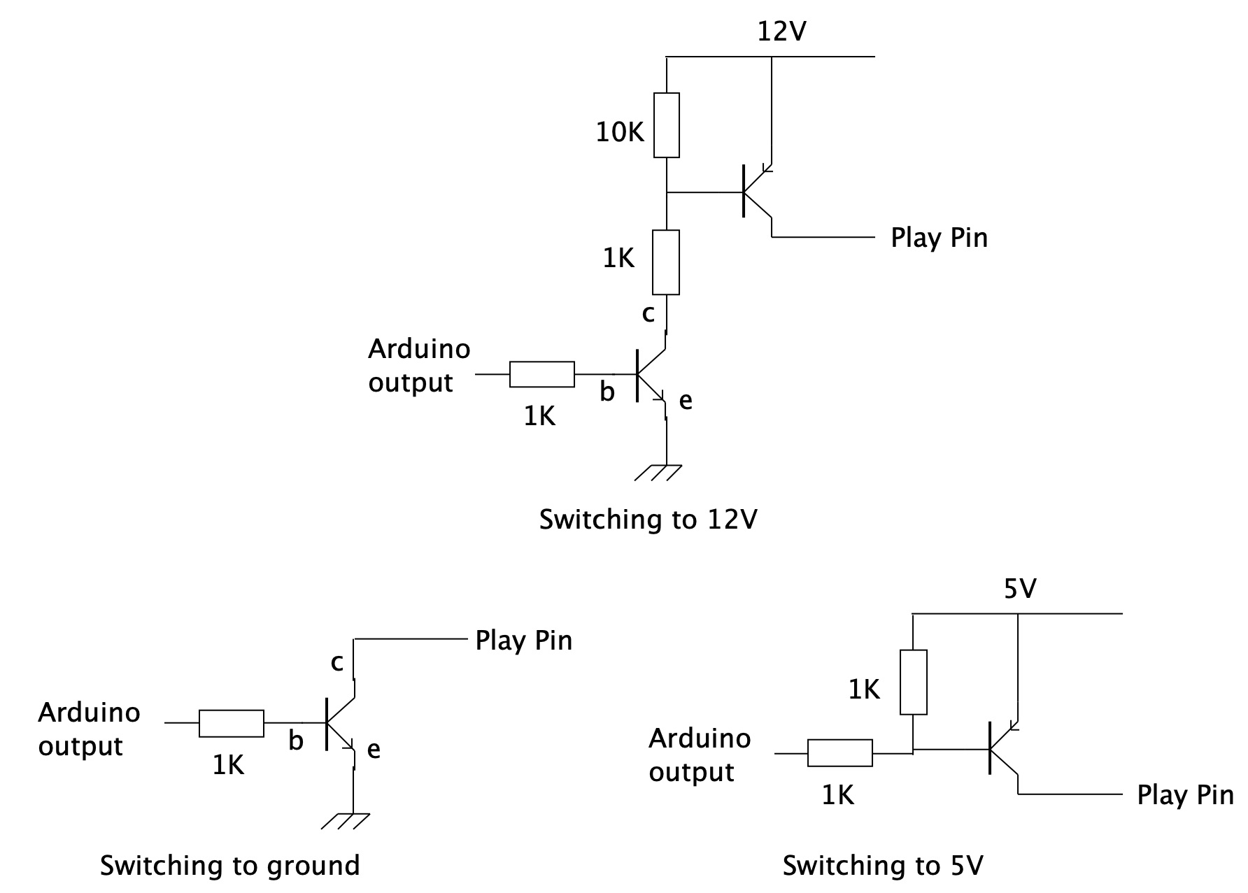

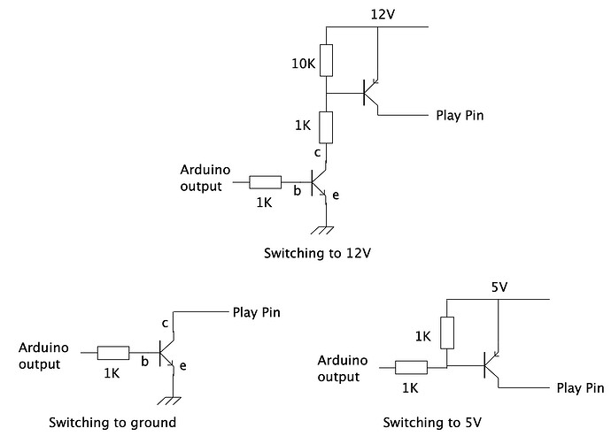

If you want to control a voltage higher than a processor's voltage rail then you have to switch it using the top circuit of this diagram. The "play pin" is the high voltage output.

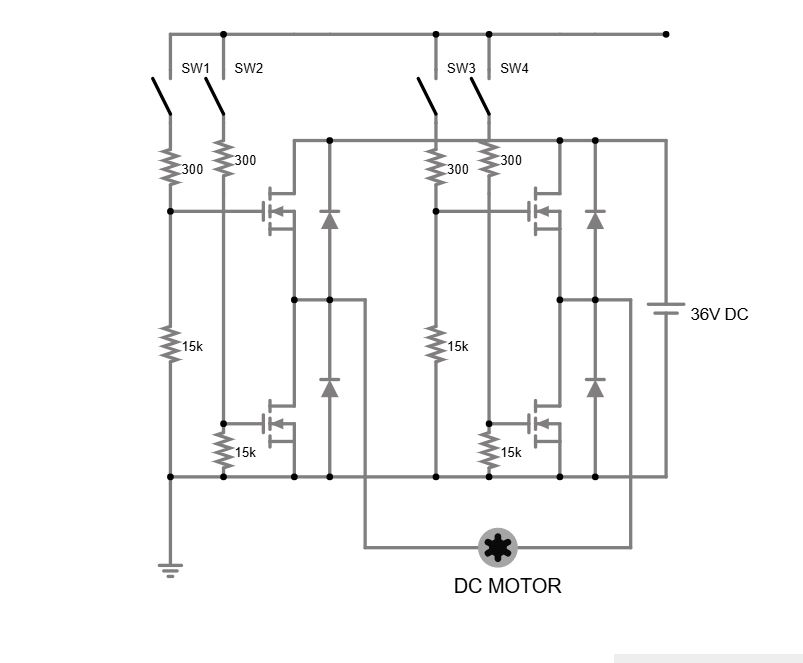

What does "will it work" mean? You didn't label your drawing, but from your description the 12V??? would actually measure -2V and it won't damage anything if you leave it as shown.
If you bridge the "12V" e.g., with a resistor then you're sending -2V into an Arduino pin and that's not going to end well.

Thanks Mike! The Arduino output is supposed to drive a Half-Bridge similar to the one I post in the picture. Now, the problem that I cannot solve, is providing 10-11 volts to the gates of the MOSFETs. So, instead of SW1,SW2,SW3,SW4, the Arduino logic must be amplified to the required level and those switches are just for demo and testing in simulator. I kinda have a vague idea that transistors can do it but I don't know how to integrate it into the diagram and how to share the ground of 5v logic and 12 driver and 36v power supply for the motor. I know that 2 buck convertors can give me the 12v and 5v from the same 36v power supply but here is where I get confused. I also know that there are gate driver ICs like IR2104 etc. but they need a shut down pin as well and my project is a bit bigger and I need to be thrifty with pins, but IR2104 is not gonna change the scenario because it also takes 6 pins if I have a 3-phase Half_bridge . On the other hand, I just need to learn how to implement the idea without ICs which increases my knowledge of hardware. The top one with 2 transistors looks like the answer, but can it be simpler? Like one transistor? Thanks for your time

Use the first circuit in post #5.

True, but I thought that if Vg goes to equal or even below Vs, the gate will remain shut. Is that correct?
PS. In the case of N-Channel MOSFETs

It is a home-made bridge, 6 MOSFETs, most likely i will go with IRFZ44, 6 1N4007 for protecting the MOSFETs from motor induction kick-back, 9 resistors.

First let me say I'm NOT recommending you use the circuit you show in post # 1, I'm just trying to help you analyse the circuit.
What you say is correct but is not true in this circuit. If you set the output LOW, the NMOS will have 5V between the gate and source, so it wiil be ON. Also you have considered the intrinsic diode that is present in all MOSFETs.
