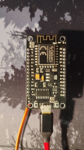

i'm trying to connect a servomotor with esp8266MOD 12-f and the "ESP32Servo.h" library but i get error codes that i dont know how to solve.

Can you upload a photo of the module and adapter you are using, please?

Wasn't it easier to say "NodeMcu ESP-8266? :wink:

Did you select an appropriate ESP8266 core (board) ?
I don't konw, I'm new with arduino I have ESP32 dev module selected, it is the one used on video i used. I imagine that is why it does'nt work
Time to change that.
The board selected has to be the board that you are using.
But you have nodemcu esp-8266, not ESP32 DEV!
thanks got it. Got one step further, not i got another problem :sweat_smile:
