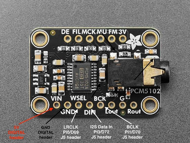

I am using the following circuits:
Breakout Board:
Adafruit PCM5100 I2S DAC:
Audio Source:

I2S output:
  • I'm using STM32 M7 Core I2S2 output
  • From STM32H747xI/G datasheet (page 81), I chose the following pins:
    • LR Clock: I2S2_WS on pin PI0, available GIGA R1 J5 header (D69)
    • Bit Clock: I2S2_CK on pin PI1, available GIGA R1 J5 header (D70)
    • Digital Out: I2S_SDO on pin PI3, available GIGA R1 J5 header (D72)
  • No need to provide the master clock to the I2S/DAC chip according to the specification of the component

Here pictures that should illustrate in more details:
  • A picture of the Adafruit I2S/DAC board with the details of the connections with the Arduino board
