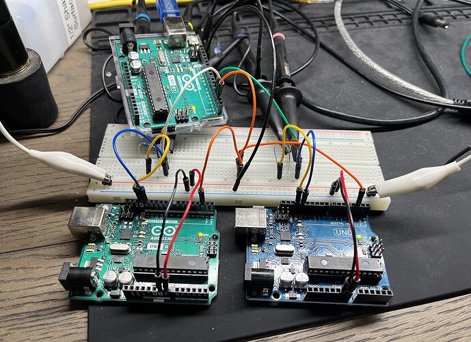

I picked two Arduino UNO, new out of the box, to sacrifice at the alter of experimentation. One is a genuine R3 and one a R3 clone from DuinoTECH. I have no reason to expect a difference between the two, given that an ATmega328P is an ATmega328P, but it doesn't hurt to broaden the sample space a little.
Both Arduinos are connected to their own resistor and capacitor in series, between GPIO pin D13 (blue wires) and ground (yellow wires). The resistor is on the ground side and the capacitor is on the GPIO side. Both Arduinos monitor their GPIO pin D2 (orange wires), which is periodically toggled by another UNO acting as master. When the slave Arduinos detect a change, they mimic it on D13. The master meanwhile, monitors the two slave D13 pins (white and green wires) to check when the signal has been faithfully propagated.
Both Arduinos are powered by a bench supply set to 9V (red and black wires). All three Arduinos share a common ground, which is not shown in the photo.

Everything is as long leaded and crudely breadboarded as you can see.

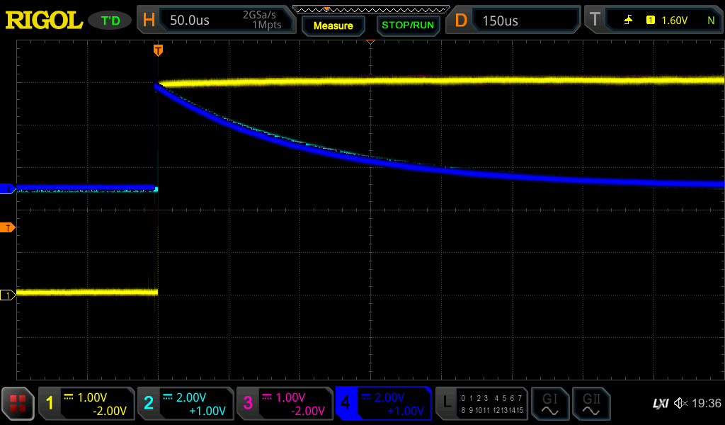

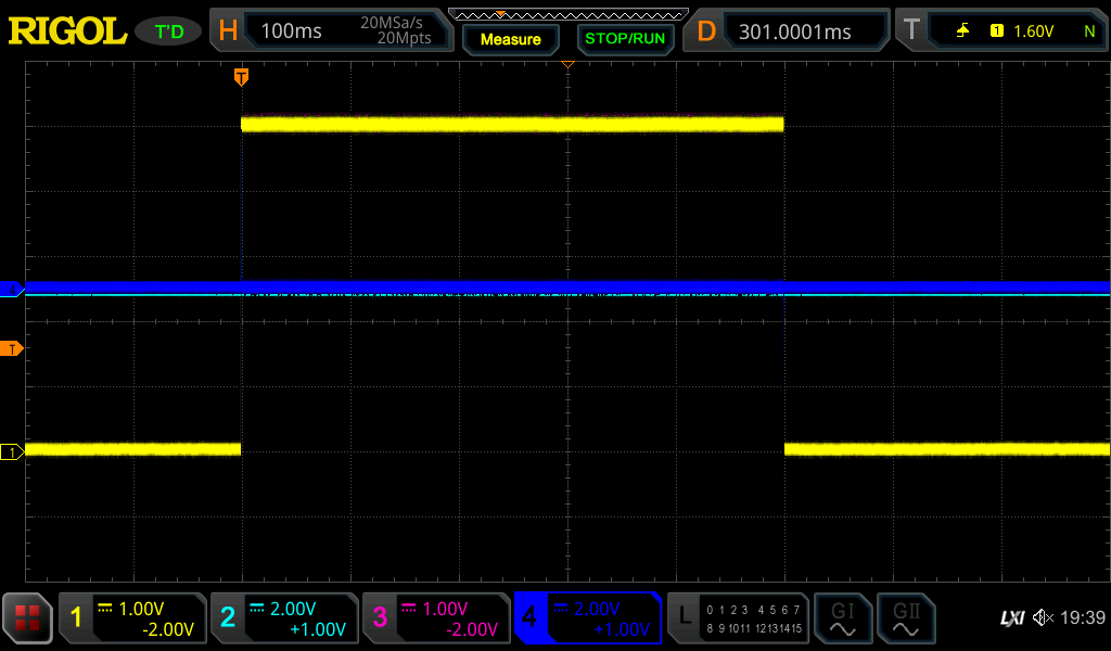

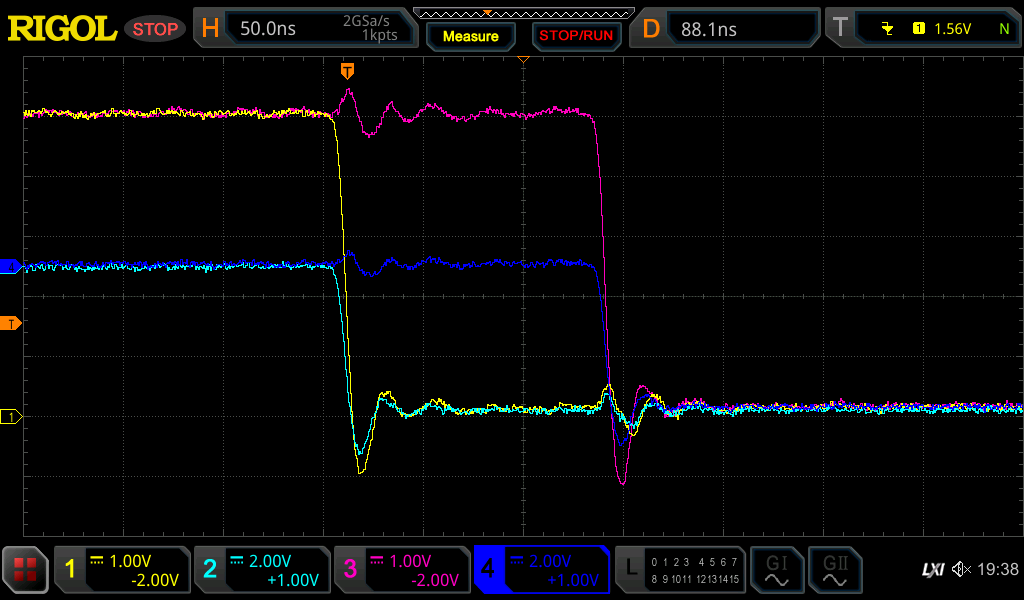

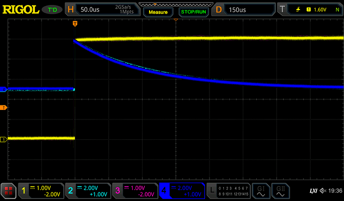

I warmed up with a 1kΩ 1% 0.5W and a 0.1µF 20% 50V Y5V ceramic capacitor, and a pulse period of 1 second.
The rising and falling edges are as you would expect - the GPIO pin manages nearly the full 5V swing, only having to source or sink 5mA, and decaying to full voltage and zero current with a time constant of about 100µs. There is some very minor discrepancies between Arduino 1 and 2, as you might expect from component tolerances and the variance in response time to the master signal.
... splitting into multiple posts because I'm an untrusted noob ...

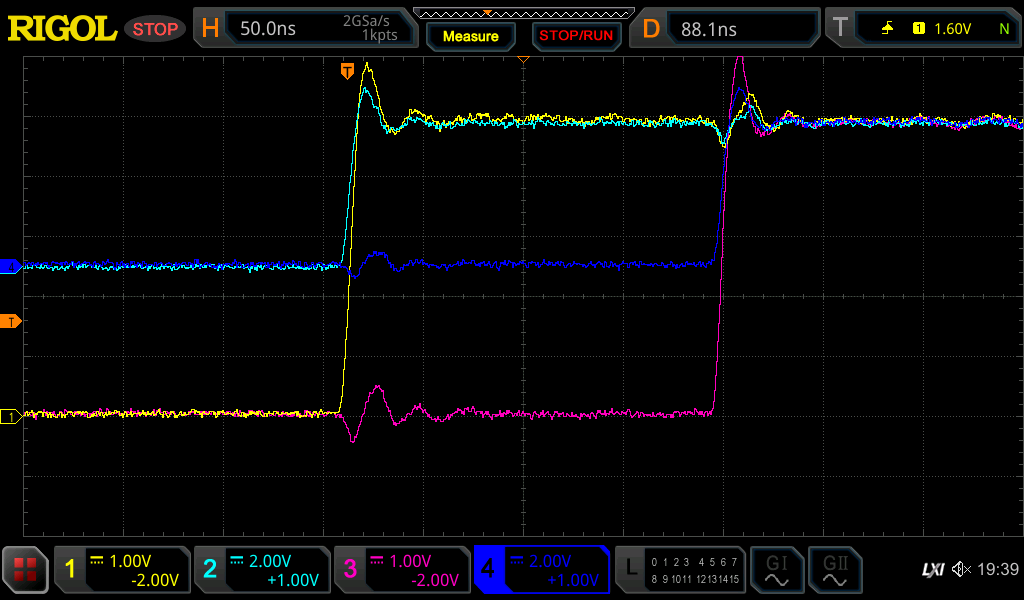

Zooming in on the transition shows a sharp rise/fall time in the order of 10ns, and as much ringing and coupling as you might expect from the bird's nest wiring. The arbitrary response time of each Arduino is clear at this scale.
And for completion sake, a complete cycle. At this scale, the current waveform, voltage transitions and Arduino discrepancies are barely perceptible.

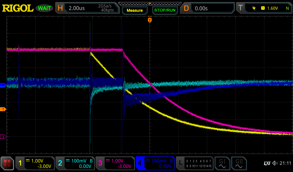

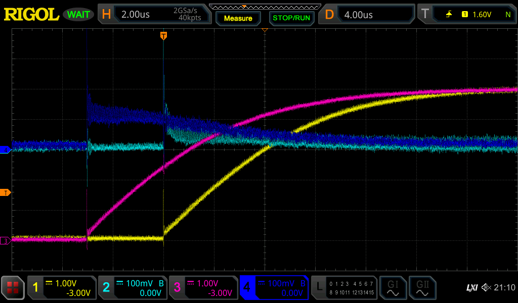

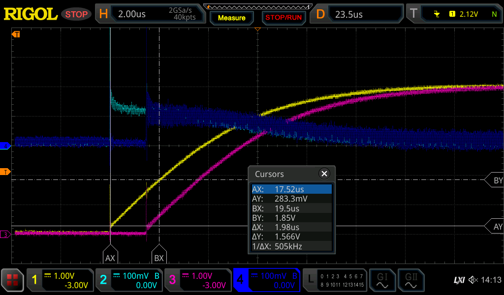

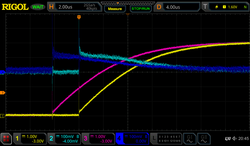

Time to move on to the first skirmish: the same 0.1µF cap and 1 second pulse period, but dropping the resistance to 1Ω. In fact, the resistor is only there to get some semblance of a current measurement. With the assumption of a couple of tens of ohms of source resistance in the Arduino, this scenario is intended to be representative of a purely capacitive load. Validation of that intention is included below.
Rising and falling waveforms:
Suddenly we have a lot going on. The transition is now significantly current limited, as evidenced by the gradual pin voltage change. The voltage across the resistor is very noisy at this scale, but seems to indicate a very big, very short spike, followed by a decay from about 120mA to zero over 12µs or so. By taking a few measurements of the voltage change in the first 1 or 2 microseconds, linearising and applying $i=C*dV/dt$, the current after the spike is likely to actually be no more than about 80mA. This figure is easily ±20% given all the sources of error, although the capacitors measure as within -1%, and other calculation methods arrive at very similar values. Further, shorting out the resistor to confirm it has negligible effect (see below) also suggests both the spike and the 40mA discrepancy between measurement and calculation can be explained by coupled noise. I have a current meter I could verify with, but at this stage the confidence in the measurements is more than sufficient for the purpose of this test.
I tried zooming in on the transition, but the signals are so dominated by noise at that scale that they're largely useless.

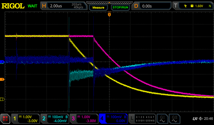

To confirm the resistor has negligible effect on behaviour, I shorted out Arduino 1's resistor with a jumper wire. The rising and falling results are below:
The rise/fall times of the pin voltage are barely affected, in accordance with the assumption. Interesting though, significant voltage is still measured across the resistor. This suggests that the initial spike and up to 40mA or so measured thereafter is purely due to noise, not due to current through the resistor. This is not surprising, given the small signal and the measurement setup, and aligns with the calculations of actual current mentioned above.
What is clear, is that the 40mA absolute maximum current specification of the ATmega328P is being exceeded for at least 4µs on each transition.
However, cycle by cycle the RMS of the current is practically zero. The cycle waveforms are shown below. The greater resistor noise during the high state is interesting, but easily explained and beside the point here. Otherwise, it's unremarkable.

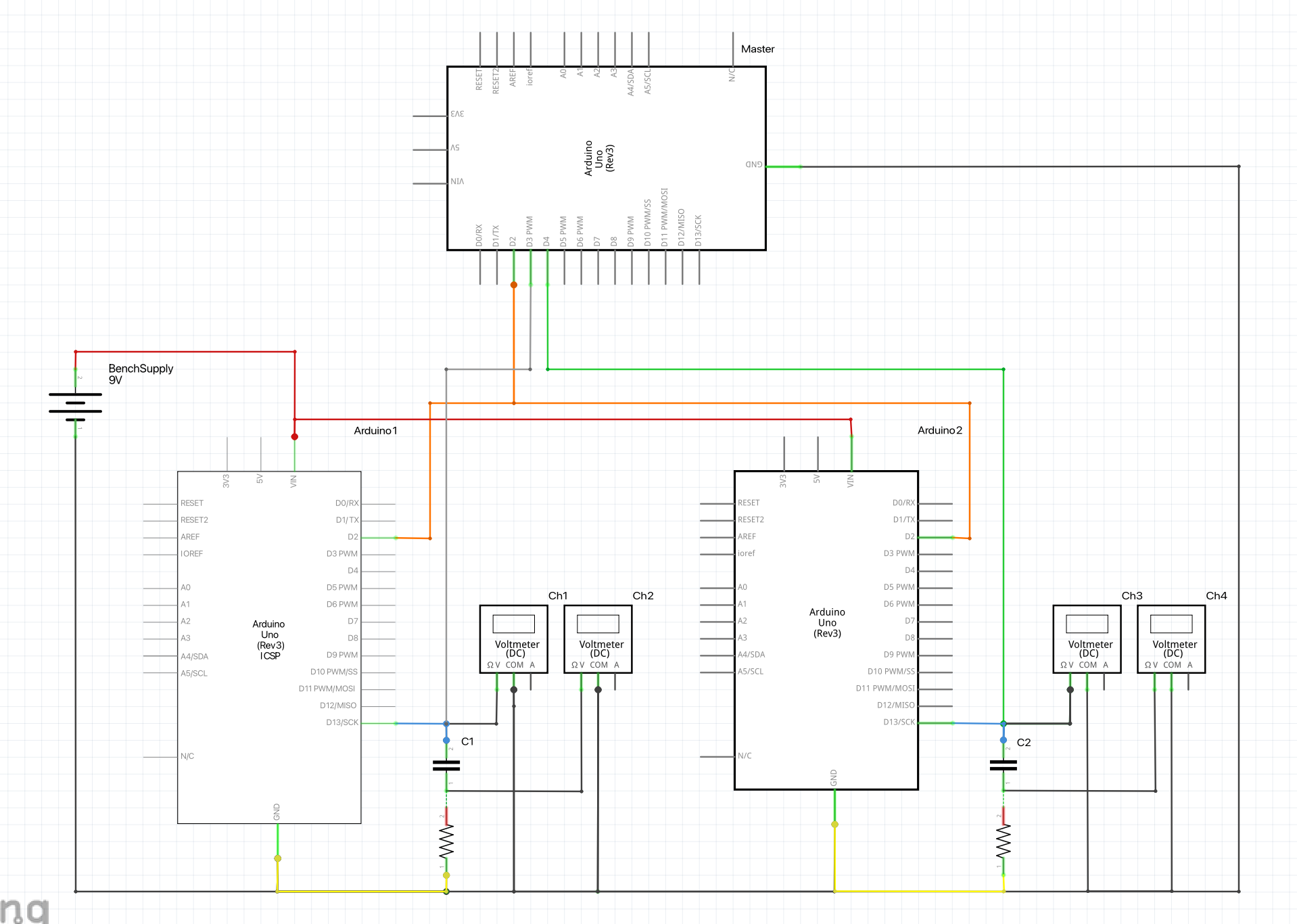

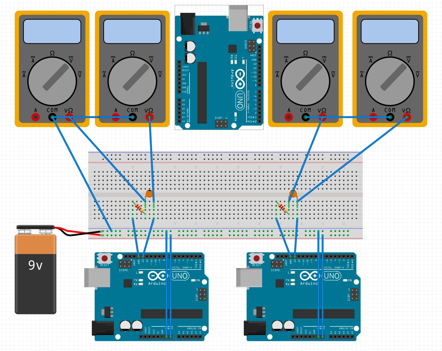

A circuit diagram were nice, with labels on the measurement points.
It looks more like you did not use a calibrated 1:10 probe?
It also were nice to have the colors labeled properly in the text WRT the circuit diagram.

Oh yes, mea culpa. I overlooked that important step in my rush. Hopefully a Fritzing is clear enough.
First without the master circuit for simplicity, in pictorial form for reference.
Then with the master circuit.
And finally, the schematic.
I've tried to maintain the wire colour coordination, but it's come out a bit messy. Hopefully it is clear enough.
