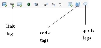

You can see option availble while writing reply to msg
like similiy;bold ;italic;etc explore each option
when you click insert link option it allow you add link just paste your link.
similarly your output always must be in quotes
code will be code tags
i have attached image for reference
