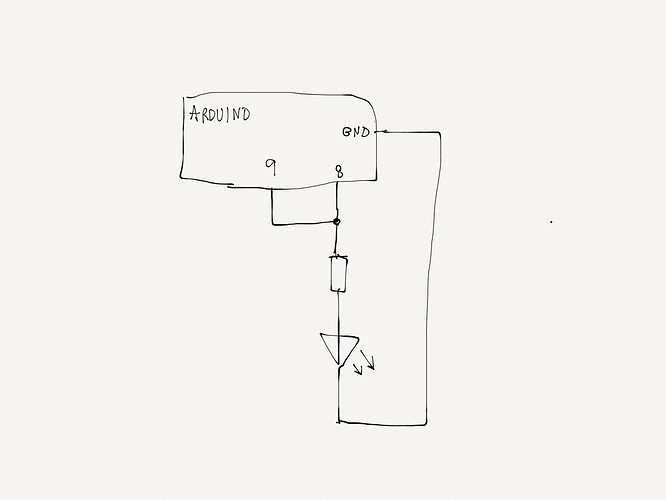

In the attached schematic, pin 8 is OUTPUT/HIGH, and pin 9 is INPUT/High impedance. LED ligths up as expected.
If I make pin 9 OUTPUT/LOW, the LED dims, but I want to make it go out completely. Maybe I'm even frying my Arduino now? Can I use pin 9 to somehow switch off the LED, without extra IC's, trransistors etc.?
You are shorting out an arduino output and so damaging it.
Why are you doing this?
You should never connect two outputs together.

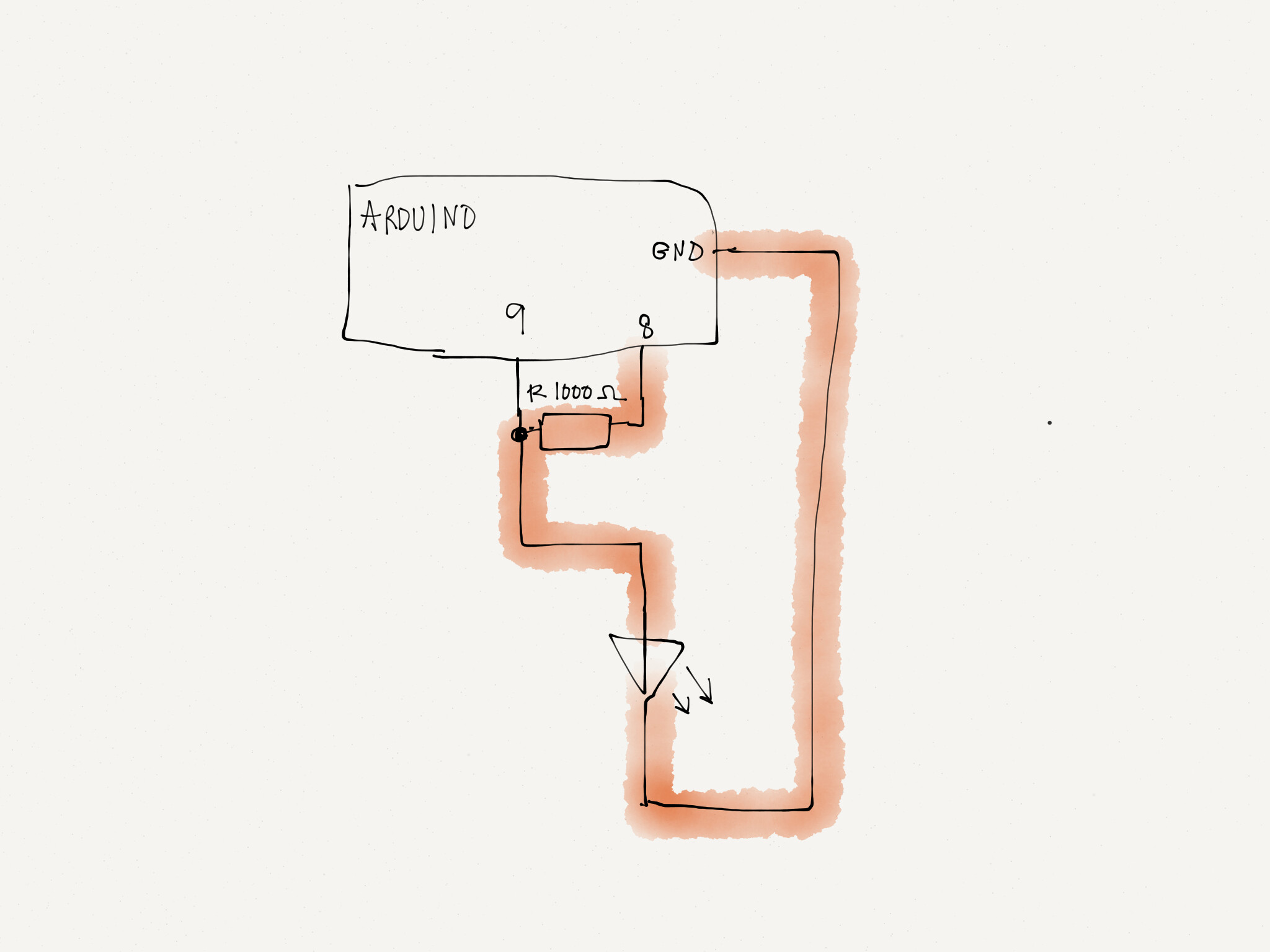

How can I adjust my little Arduino test circuit? Add a big resistor? And then do something so my Arduino is not shorted out...?
Put the resistor between pins 8 and 9. Then put the LED between 9 and the ground.
Make sure pin 9 is only ever set as an input, or an output with a logic low on it.

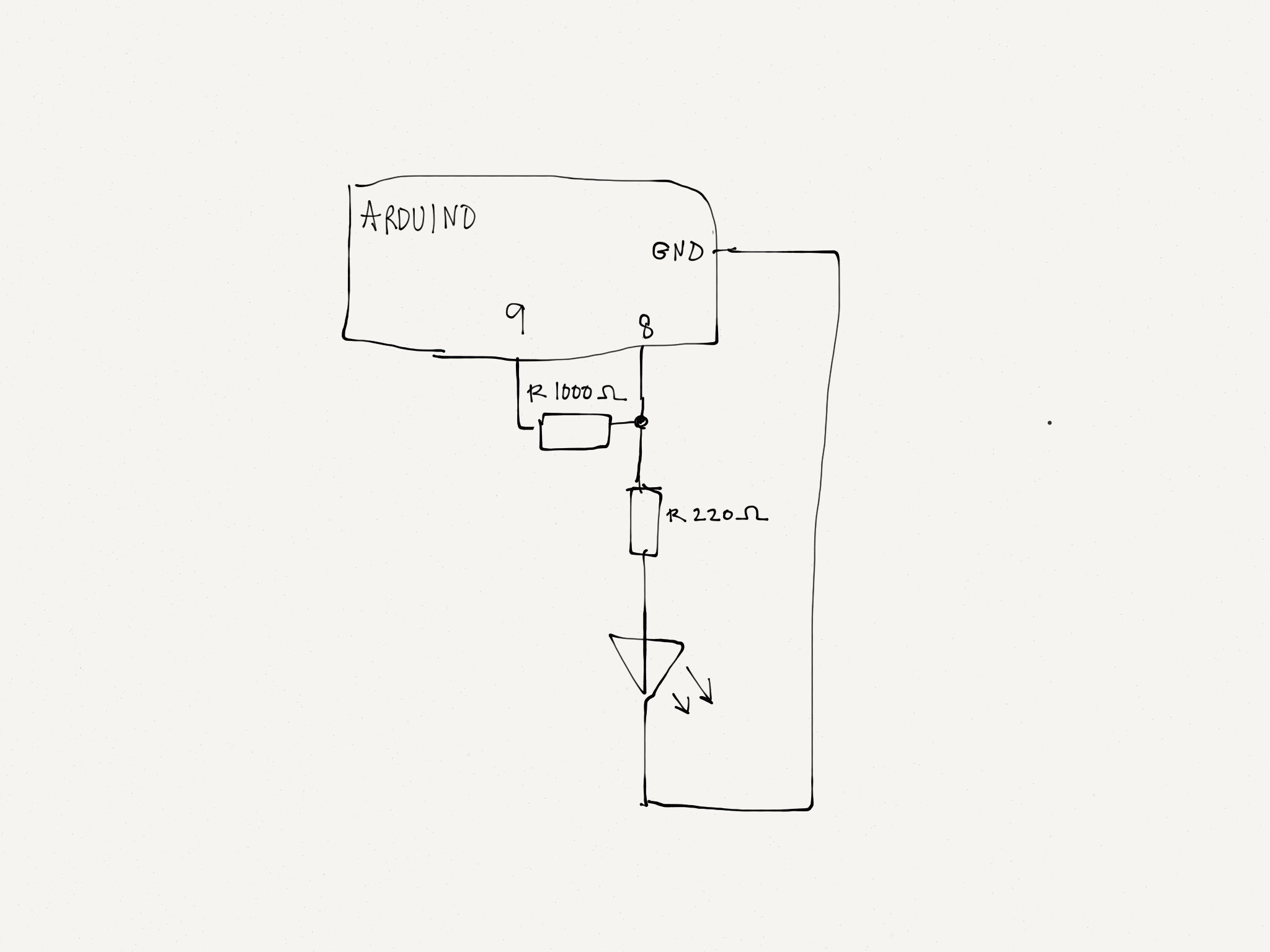

This is the setup now (attached).
And this is the sketch:
  pinMode(8, OUTPUT);
  pinMode(9, INPUT);
  digitalWrite(8, HIGH);
  delay(5000);
  pinMode(9, OUTPUT);
  digitalWrite(9, LOW);
I thought this would make the led connected to pin 8 turn off after 5 seconds (after a reset), but it doesn't?
@Grumpy Mike: You suggest I connect the LED to pin 9? I imagine that the signal going from pin 8 through the resistor and the LED is one of the video signals (i.e. Red), and then pin 9 is the output pin of the video buffer. But maybe I cannot 'simulate' the scanline circuit this way?
I did.
I also did not say add another resistor.
If you don't do what I said then how do you expect it to work?
Sorry for the confusion. Now I believe I have set it up exactly like you said, Grumpy Mike (attachment), and it works great! Thanks! The red line from pin 8 to ground represents the video signal. Pin 9 represents the buffer output, that connects to the video signal line. When the buffer output is Z (high impedance), it is electrically disconnected from the video line. In my test circuit, the LED is on, representing the normal video signal. When the output goes low, the video signal is pulled low, and the LED turns off. In the video circuit, this will result in a blank scanline.
