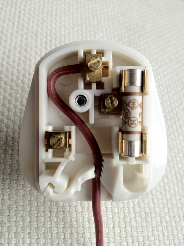

Hi there,
I am trying to stabilise the Arduino board and I have seen that it could be connected to an earth ground (such as a water pipe).
As I don't have one where I am working I was thinking wether or not I can connect ONLY the ground of the Arduino board into a plug (via single core wire) into mains.
The plug won't have positive and negative wires attached to it.
Would this be a safe procedure?
Many thanks for your help
Best
F

By "single core" do you mean a single connection of stranded wires, or a single wire made up of one solid metal core?
I mean a single wire made up of one solid metal core, which I have stripped out of a twin cable bought at Maplin earlier on today.
I am attaching two images to better describe the procedure.
Thanks!
F
No, that is not a safe thing to do.
Solid core cable is brittle. It should only be used in situations where there will be no motion. With motion the wire will weaken in either the plug or the terminal block where it is screwed down. If that happens in the plug, and the wire breaks, there is a good chance it will move and connect to the "Live" (or "Hot" if you're in the states) pin of the plug, and bang goes your Arduino (and maybe you too).
If you were to do this (though I can't see why you'd ever need to), the you must use stranded wire.
This is why power cables are always multi-stranded, but cables in the walls can be single stranded.
Hi Majenko,
many thanks for your help and all vital advice.
I will replace it with stranded wire then, the usual one (green/yellow) and will only be using it in case I will still be having erratic readings.
F
