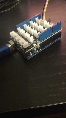

I've taken two images of the system:
The following products are used for this system:
The USB is connected via my PC, so the output is 5V (?).
Does this give enough information, or would you like more information?
And in two posts, since there can only be 2 links per post:
and an image showing the Base Shield on top of the Arduino / Sintron:

Good morning,
In the photo, the module is connected to D5!
It must be connected below to one of the four I2C connectors.
Thank you very much for your reply. It was a stupid mistake, and now the values are correctly coming in. In the next step, I have also tried to measure the values for a garlic using the following code:

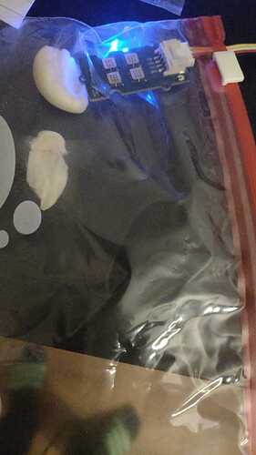

However, I get the following values over time, which seem to be very inconsistent:
garlic2_measurements
The trend can partly be explained by sensor drift. However, I cannot explain the sinusoidal downward curves for GM302B and GM702B. Do you perhaps have an idea how this could have happened? And how to mitigate these issues in the future? Thanks!
The garlic was packaged as follows:
