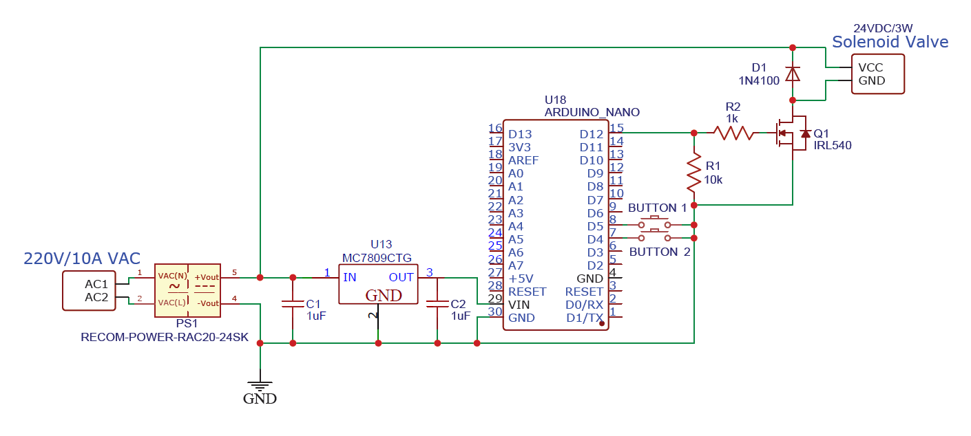

I am not of an expert and just beginning in electronics, I have tried to design this circuit. I will be doing 2 separate design, one for each solenoid valve that I'll be controlling using Arduino NANO. The 1st schematic is for the 24VDC-3W solenoid valve which I'll use to control a pneumatic cylinder (required to be quick release/retract of piston) and the 2nd schematic is for the 12VDC-4.5W solenoid valve to act like a gate valve to pass and stop the flow of air depending on the time I has set it to do so.
Q1. The first thing I want to ask is that is the power supply part, is my design okay or are there anything I should change? The Arduino NANO operates at 7-12V so that is why I tried to have voltage regulator MC7812 to output 12V from 24V AC/DC-830mA Power Supply (RAC20-24SK). Also in the 2nd circuit, I just used a power adapter labeled 12VDC, 1A to power both the 12V solenoid valve and Arduino NANO. Is it alright that solenoid valve and Arduino Nano share the same power supply?
Q2. I have used MOSFET based on the discussion here in forums and I see that they use IRF540 however, I am not sure if this will be compatible with connecting to Arduino nano. If anyone has extra time I am still confuse of the parameters needed to look for to tell when a MOSFET/transistor is appropriate for a design. I see that Vds, Rds_on, etc. are being described but I am a bit sluggish to understand how this be calculated to the chosen load w/c is the solenoid valve (I also had this IRLML6344 MOSFET that I consider to use instead of IRF540).
Q3. For the 2nd ckt, is the BCP55 transistor appropriate for my design, and is the resistor value of 10k appropriate? This is the only NPN transistor I have so I chose this one. Same question as to Q2, what parameters to tell that this is okay to use. What should be considered in calculations of voltage and current consumption should I look for given the power supply and solenoid valve I have.

Great job on the Schematics. I like the first one the best. I would not use the MC7812 regulator it will run very hot for you. Instead get a Buck Regulator, they can be very inexpensive from your favorite china supplier. This will keep you to one power supply. Use a second buck for the 12V solenoid then you only have to build one system. You are correct a Different MOSFET would be better as the Vgs is to high for logic level switching. For power supplies you need to check the wattage. The IRLML6344 would work but will be close with the 24V system. That is a 30V Vsd (source drain) you want at least 40.
I would not use the transistor but a MOSFET instead. The transistor will get quite warm. If you use the transistor check your base resistor it is not passing enough current into the transistor. In the second schematic you have 12V feeding the TM1637, that will fry it. Sorry I am out of time, good luck, Later
In the first schematic diagram, the IRF540 will not work with Arduino, and you are lacking the required gate resistor (1K is OK). You also need a gate pulldown resistor (10K). Use a logic level MOSFET such as IRL540 instead.
The BCP55 is fine for that solenoid in the second diagram, but the base resistor R4 is far too large. Plan on current gain of 25, as per the data sheet, and use 220 Ohms for R4.
I agree with the above that 12V is too high for the Arduino Vin. 7-9 V is much better. Better, use a 5V stepdown converter and power the Arduino via the 5V pin.

In your first schematics, what is the purpose of VD6?
Hi thanks for the reply and for correcting me about IRL540 I didn't notice I used the wrong mosfet. I did what you suggested adding gate pulldown resistor of 10k and gate resistor of 1k.
Also changed R4 to 220 ohms as what you have said.
This arduino nano has this:
I tied it to the 12V so I can get rid of adding voltage regulator (let's say MC7809) for a 9v.
Would like to ask using the power MOSFET, can it be driven by the output pin of the Arduino? or should there be external small signal transistor before the MOSFET?
Added VD6 as seen on other design, I thought it was for protection. but I edited already and get rid of it.
Thanks for pointing out how I should not settle for IRLML6344, I will use IRL540 as what @jremington suggested.

hi, just want to clarify more how were you able to pick 220 ohms for R4, what parameters for calculating the value did you consider? I believe current gain of 25 is this part of the datasheet:
this is how I edited my schematic,
That value of resistance provides the maximum base current, subject to the recommended maximum current draw from a Nano port pin (20 mA).
(5.0-0.7)V/220R = 19.5 mA (Vbe = 0.7V)
The minimum DC current gain required for the solenoid current Ic = (4.5W/12V) = 0.375A would be 375mA/19.5mA = 20, which that transistor easily meets (data sheet says hfe=25 minimum @500 mA).

Correct. Re heat dissipation: the transistor must not exceed 1.33W total power dissipation, which is Vce*Ic, subject to Note 1 below the table in the data sheet. Vce is the collector to emitter voltage measured when the solenoid is on.
