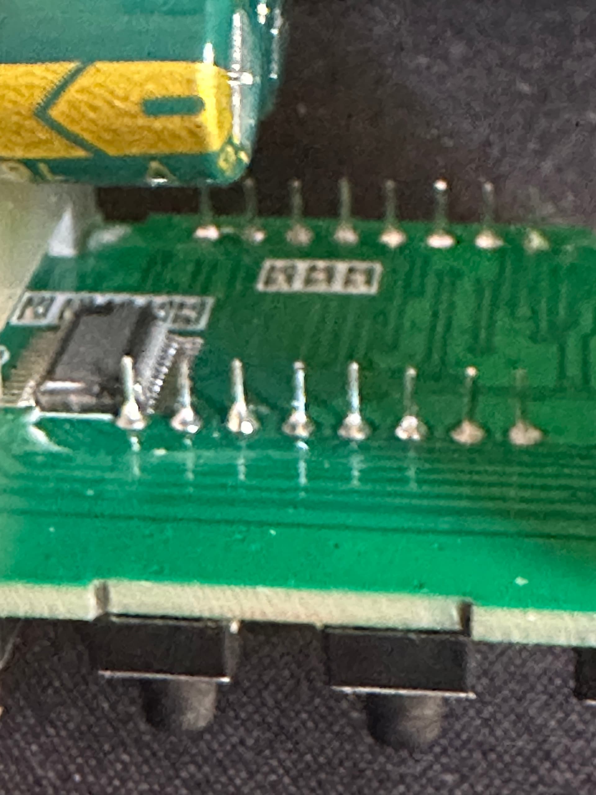

To continue the thread about this hack; the alleged MAX7219 wasn't a 7219 at all... the pinout doesn't match. So I guess it's a proprietary chip.
So I guessed (pretty much) all the pins by analysing the pcb traces, and analysing the inputs signals with a logic analyzer.
Unfortunately I couldn't figure out the signals going into this chip, so I decided to plug the ESP directly to the pins of the LED display.
After some hours of soldering, trial and errors... I managed to obtain the 8 digits on the ESP side in a "stable" manner (one reading error on one digit out of > 1000 correct reads).
