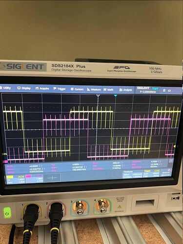

I can see that the hall effect sensor is picking up the frequency of the input PWM from motor driver and causes false pulse reading therefore false position reading (I am using interrupts to read the pulses).
Is there anyway to reduce this noise? Is this the design flaw by the actuator or the motor driver causing the issue? or the frequency I am using for PWM or anything else?
The max frequency of hall effect is 200Hz and PWM frequency is 4000Hz. As you see there are about 20 spikes per cycle.

Where in the circuit is the gnd point for the scope probe?

The probe of the scope you used in the picture in post #1, has to have two connections, what were the two probe connections made too in the circuit?

The scope probe is only connected to the Hall signal. did not know they have gnd too or if that matters.
Is that going to affect how I scope the signal on the display?

Yes it will, you will have no project gnd reference for the signal that the scope is displaying.
This will make your display susceptible to all sorts of noise, including from the PWM.
What actually is the scope looking at, it looks like an encoder quadrature signal?

I did connect scope probe gnd to the board gnd. its showing the same noisy signal. I wish I could get some info on their hall effect sensor in the actuator. But the website and the data sheet does not give out any info.
All I see is their hall effect sensor is picking up the pwm frequency and Im not sure if its some thing on my side or their design is flawed.

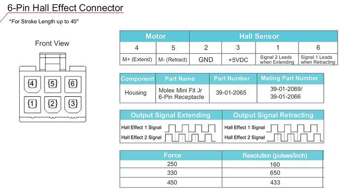

The pdf shows the signals... It's probably all you get... it's from PA-09 datasheet.pdf
Not much... looks like they are a pair so you can tell direction of travel.
