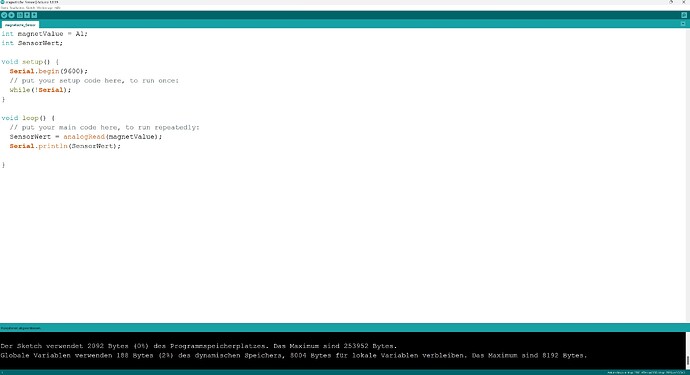

That is not the code you are actually using. What you have shown does not compile.
arduino-cli compile -b arduino:avr:uno --warnings all --output-dir ~/tmp --no-color (in directory: /home/me/Documents/sketchbook/Uno_R3/test)
already nofloat
/home/me/Documents/sketchbook/Uno_R3/test/test.ino:1:1: error: 'magnetValue' does not name a type
 magnetValue = A1;
/home/me/Documents/sketchbook/Uno_R3/test/test.ino: In function 'void loop()':
/home/me/Documents/sketchbook/Uno_R3/test/test.ino:12:27: error: 'magnetValue' was not declared in this scope
   SensorWert = analogRead(magnetValue);
Used platform Version Path
arduino:avr   1.8.3   /home/me/.arduino15/packages/arduino/hardware/avr/1.8.3
Error during build: exit status 1
Compilation failed.

Hi van_der_decken,
thank you for your feedback with the digital sensor. I will try to change it at the weekend, today it is too late, after a long working week.
For the topic with the compling: For me it works, see picture here:
It seems that I use a newer version then you are using. You have arduino:avr 1.8.3, i have 1.8.19.
That turns out not to be the case.
You might want to look back at what you posted.
magnetValue = A1;
int SensorWert;
  while(!Serial);
Notice the absence of an int in front of magnetValue = A1; on the very first line? That does not compile, not in any compiler version.
Then look at your screen shot and see if you can spot the difference.
And you're conflating core versions with IDE versions. That is neither a valid nor useful comparison.
Hi van der decken,
you are right, it seems to be a copy error, but relax, I'm new to these kinds of topics, it is only a hobby for me. I'm glad that you gave me the information with the digital sensor.
