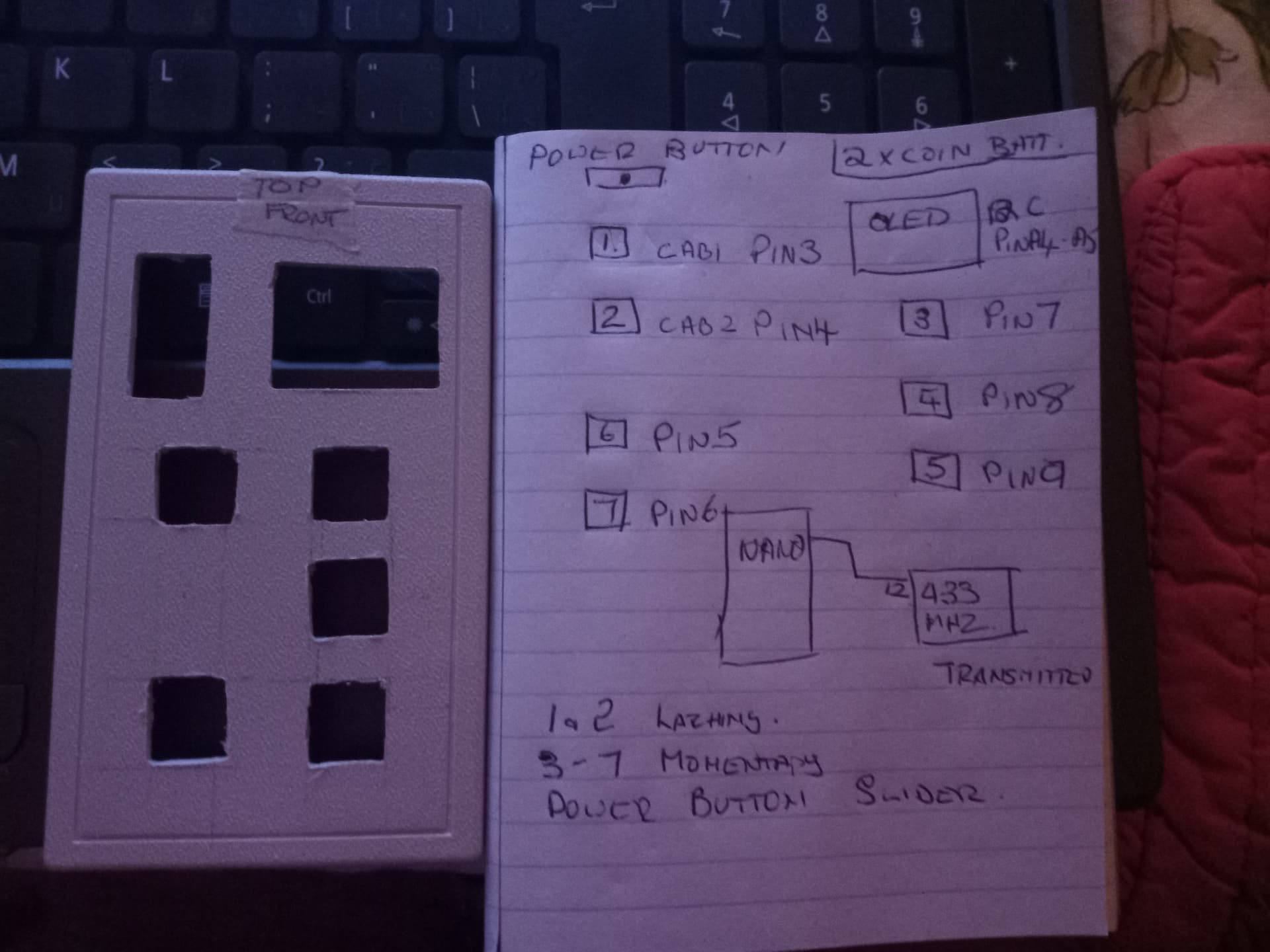

OK is it possible to wire the ground from the first pin to second pin etc down the line and then attach the ground wires from the OLED , the 433 and the power coming in.
This is the layout of the box I want to use.
It sounds like okey. Post schematics. Words are often misunderstood.
I don't see why wiring would be the limiting factor here.
When I have a problem like this, if I'm not going to make a PCB, my process is to start with physical layout. Get the largest perf board that will fit in your enclosure. Don't forget to account for a battery if this is going to be portable, and make sure you have access to the mounting bosses in the enclosure (drill holes right away so you don't forget). Next, draw the desired layout (you already have that). Then temporarily place the devices on the perfboard, along with battery, charger, etc. into the enclosure and close it to make sure everything fits.
Once that's done then you can see the best path to wire everything together. It's usually good to start with putting down Ground and Power lines (bare wire) on the perfboard to make connections easier. Yes, you can wire ground as you mentioned above, but that makes it harder if you need to swap out a component.
With the exception of Gnd & power, I'd wire everything here with 30gauge wire-wrap wire. Possibly 22gauge for GND & +. There should be plenty of room for everything going by the size of your cardboard cutout.
I don't think you can complete the circuits through the buttons without at lest two wires each.

I understand that two wire are needed I was pondering parallel wiring.

If your project "box" has extra depth, display can easily be mounted over the Arduino using flex ribbon cable:
Pictures of QBF
Power switch, Arduino on perf board, display mounted with hotmelt glue, Ribbon connector makes easy assembly. Batteries in battery compartment with push buttons on top of battery compartment using 2-part exoxy.
You can buy solid or stranded wire from Home Depot or a hardware store if you desire. By bare wire, I meant take insulated wire and strip off the insulation. Off the shelf bare wire is typically enameled and it's a pain to remove the coating.
You can buy this at any electronics distributor. Here's a hobbyist-friendly one. Any of the 30gauge Kynar wire spools will be good. Blue and white seem to be the most commonly used colors but it really doesn't matter.
