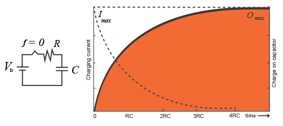

Transforming a PWM-voltage that alternates between Vcc and 0V can be done with a low-pass-filter
Here is a thread with pictures how such a low-pass-filter looks like.
You will have some up/down of the voltage with a fraction of the averaged voltage
This is called ripple
How much rippling you have depends on the capacity of the capacitor
increasing the capacity lowers the ripple but also lowers the reaction-speed to changes

with 20 positions this means
5V / 20 = 0.25V per position which equals to 0.25V per second.
This is a pretty low speed.
So if changing from 1.00 V to 1.25V takes 0.05 seconds would be fast enough.
Here is an online calculator for the time-constant of a RC-lowpass-filter
At a voltage of 5V when using a 10 k resistor combined with a 1 µF capacitor the time-constant is 0,01 seconds.
Where the voltage changes from 0V up to 5V * 0.368 = 1.84V within 0,01 seconds
should be fast enough.
If you use a 10µF capacitor the timeconstant is 0,1 seconds
For a more deeper analyse I would use on oscilloscope that measures the real voltage.
But I think 1 µF should be sufficient for your application.
best regards Stefan

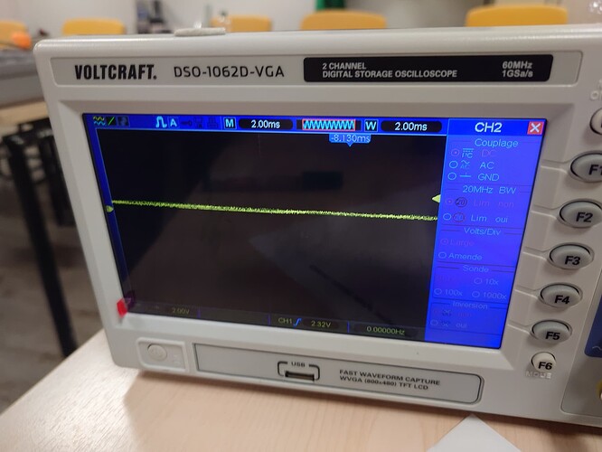

So I used a 0,47uf and a 10uf
Tried it with the oscilloscope last evening and it seems to work pretty well.
Need to see the machine reaction now.
I'll keep you update!
Thank you
It is working very well thank you!
glad that it is working.
If you would like to know how much ripple is still there you could switch your oscilloscope to AC and change to 200 mV, 50 mV, 20 mV ... per grid point
to measure how much ripple is still there.
additionaly yo could write a testcode that changes from duty-cycle 10% to 90% with different speeds and then put the oscilloscope into singleshot mode to see how fast this change is happening
Same thing for changing from duty-cycle 90% to 10%
