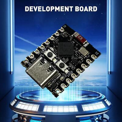

Hallo,
ich verwende ein ESP32C3 supermini siehe
hier meine platform.ini
board = lolin_c3_mini
Und versuche folgenden Code zu kompilieren
#include "HardwareSerial.h"
// Global variable for serial interface
HardwareSerial& mySerial = Serial;  // You can replace Serial with Serial1, Serial2, etc., if available
// Function declarations
void initializeSerial(HardwareSerial& serial, long baudRate);
void writeMessage(HardwareSerial& serial, const char* message);
  // Initialize the global serial communication
  initializeSerial(mySerial, 115200);
  // Write a message using the global serial variable
  writeMessage(mySerial, "Hello from function!");
  // Do nothing here
// Function definitions
void initializeSerial(HardwareSerial& serial, long baudRate) {
  // Initialize the provided serial interface at the given baud rate
  serial.begin(baudRate);
  // Give the serial connection time to initialize
void writeMessage(HardwareSerial& serial, const char* message) {
  // Print the message to the provided serial monitor
  serial.println(message);
allerdings bekomme ich folgenden Fehler
error: invalid initialization of reference of type 'HardwareSerial&' from expression of type 'HWCDC'
'HardwareSerial&' != 'HWCDC'
