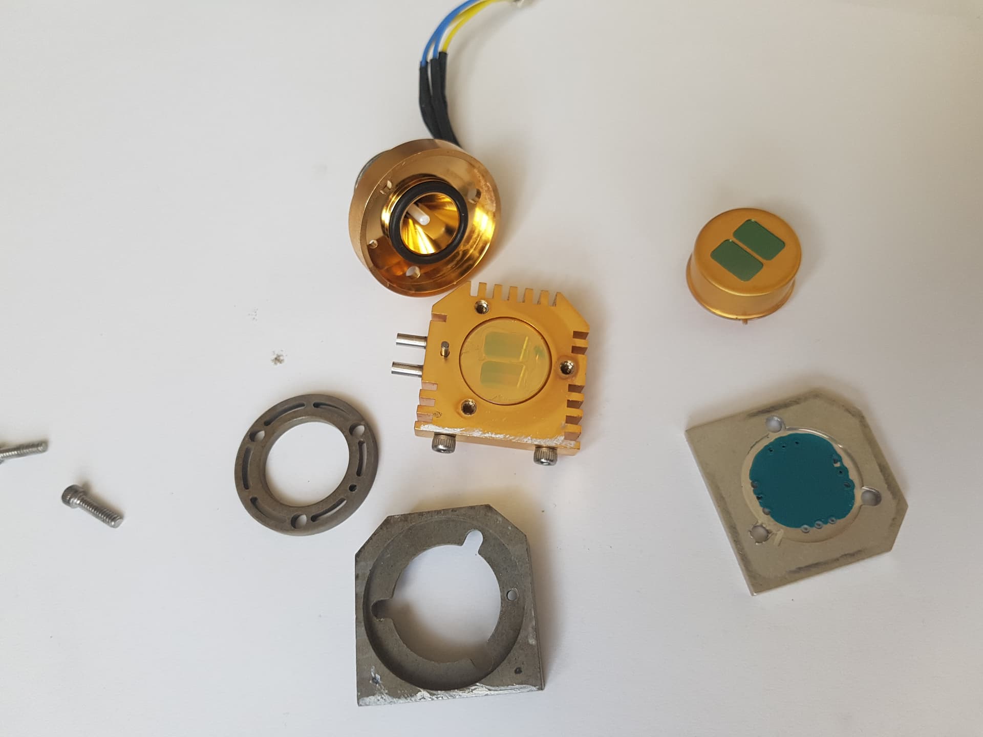

Some discontinued medical machinery from Invivo, a pcb with some sensors on it "ANESTHETIC AGENT ANALYZER MODULE II"
It has this custom assembly of an IR lamp with a reflector, a flow cell and a phododiode array (presumably)
12 pin part. scratched markings that read "3-8-1B-15"
Would like to find out about this sensor and if it could be used in some diy spectrography spectrometry project.
On the photos, the full pcb.
Disassembled module, ir lamp is a ceramic rod with a conical reflector, the flow cell in center and the presumed photodiode array on the right with a split window, spacers and module plate.

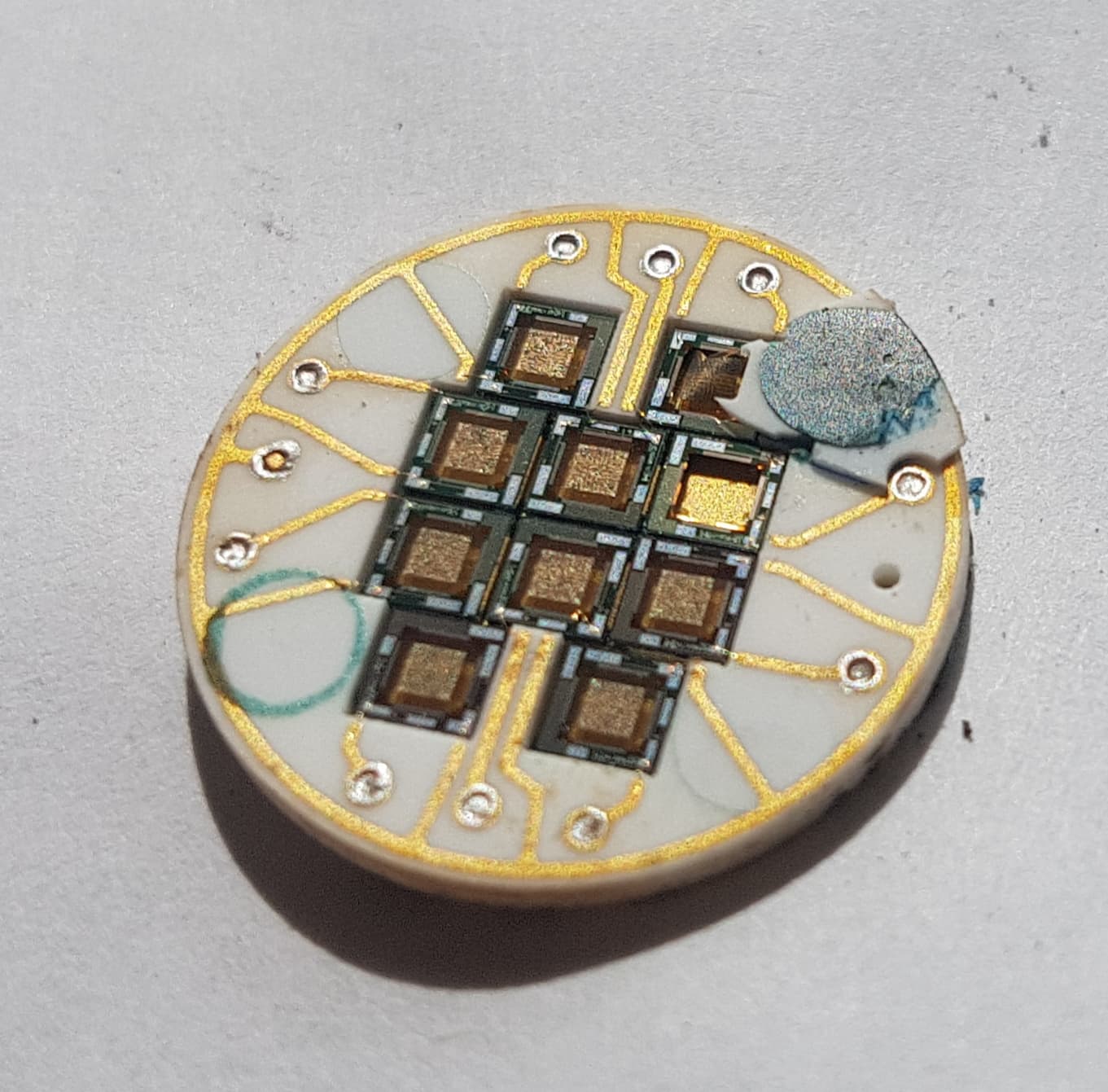

In order to satisfy our curiosity I used non destructive remote viewing technique called grinding wheel.

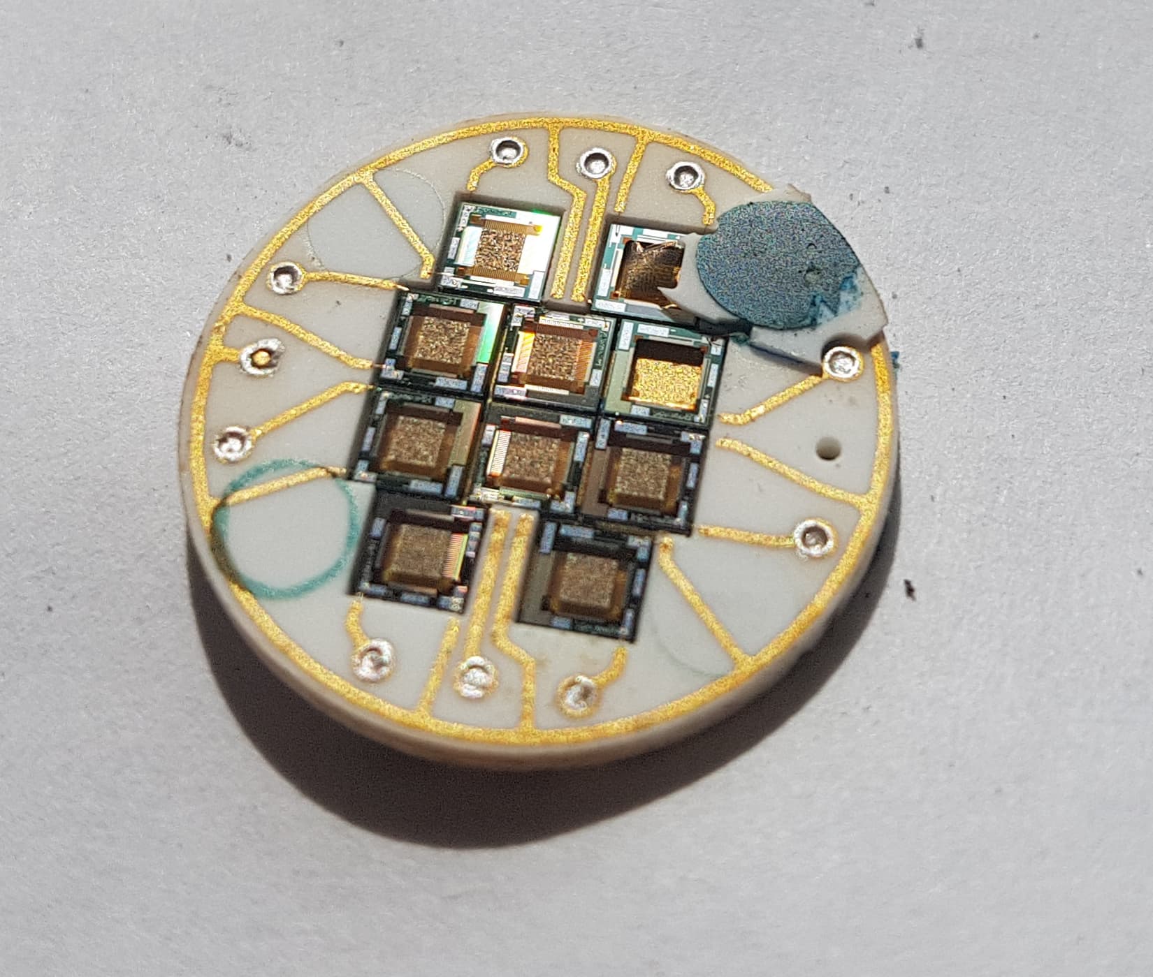

Ive opened the cap on the detector to see inside.
Its a sandwich of some layers and see for yourself.
Here it is.

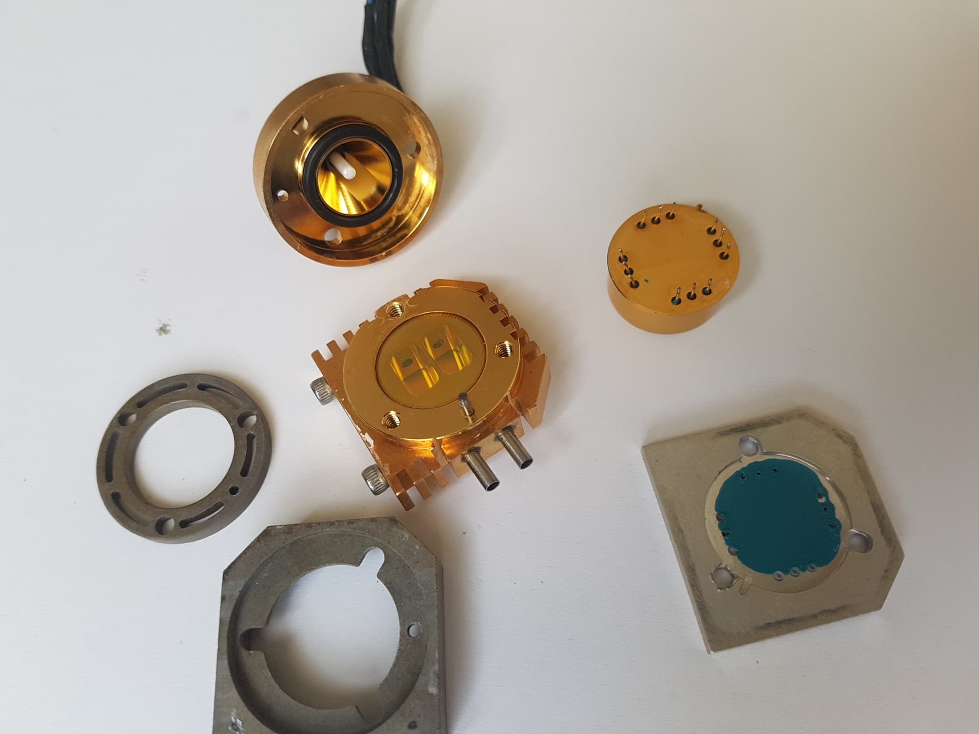

Just to comment a bit on the pictures.
The image just above , with 3 pieces, the top left part with 4 blue blobs, I have removed that ceramic grating screen so we can see the circuits below.
The round object on the right with square windows, they do look like they have different color.
The image of the full assembly uncapped, top part with the small blue resin dot,
notice a small hair of a wire that goes from the leg to the recess with a square piece of silicon. This part is not illuminated directly and sits under the metal part of the window.
So gentelmen, any guesses on what the sensor is?
Looks like one common leg in a cirlce and an output leg on each of the 10 detector squares.

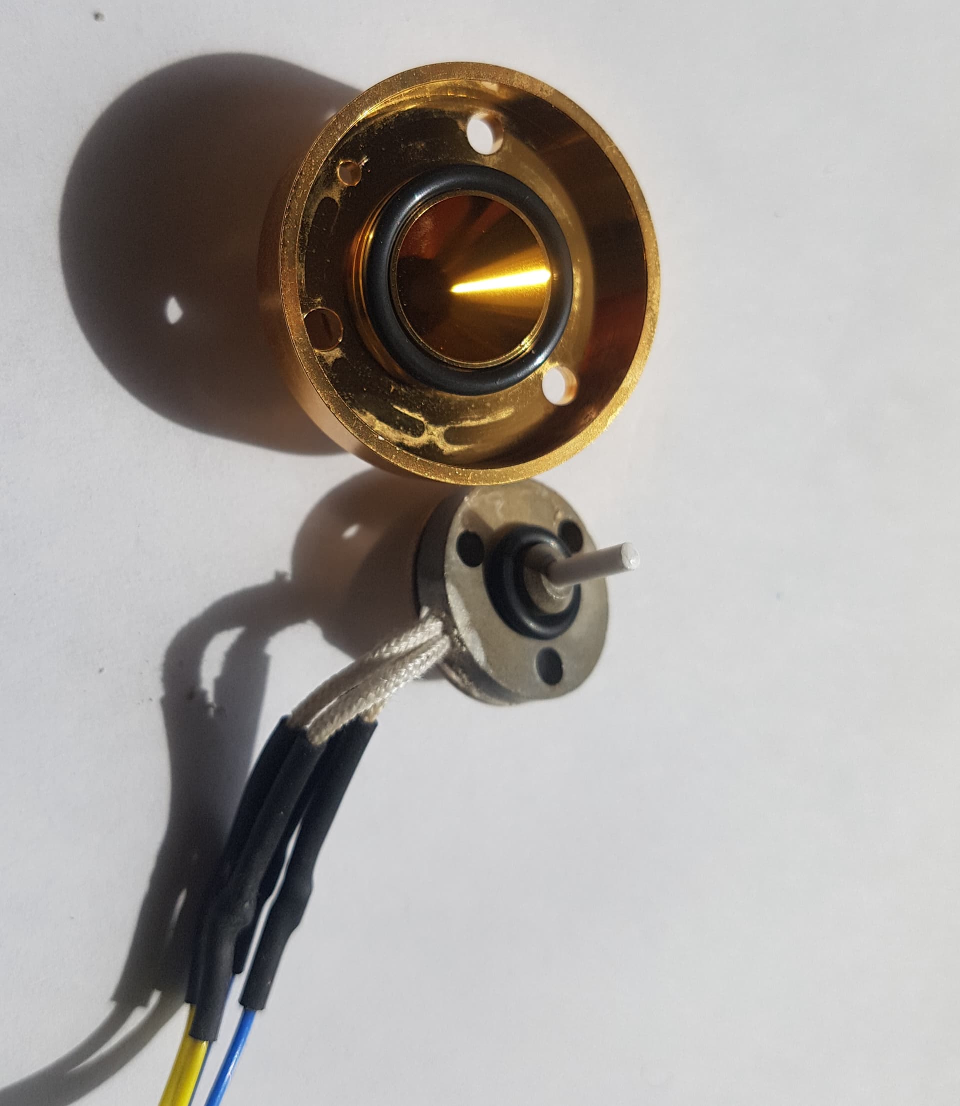

The presumed IR lamp.
Blue wires resistance 38.6Ohm
Yellow wires resistance 18.5Ohm

The woven glass fiber insulation usually is seen on something that gets extremely hot. Likely the IR source is a piece of very hot ceramic material heated from nichrome wires inside the device. Two different resistances indicate two different heats.

I guess the "IR lamp" comes with a termocouple or thermistor.
What about them small sqare "filters"?
And the small detector that is under the metal cap not in the windows view.

Those may be photodiodes, but the photos are not clear enough to be sure.
A voltage (typ. 0.7V) will be generated on the pins connected to the photodiodes, when a light is shining on them.
Thanks! That also will explain the features of the OP device.
Interesting! Not photodiodes.
So it is multichannel pyroelectric detector.
Its all anodized aluminum.
