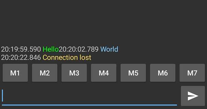

After programming the CH-06, I checked it worked with an app called Bluetooth terminal
(The Green text was received by the serial monitor in Arduino IDE, while the blue one was sent to it).
So the programming of the CH-06 wasn't the problem (thanks for the tutorial anyway)
